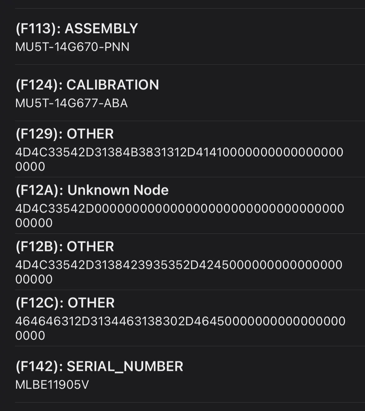

How about when it shows modules as 'unknown'?
You can ignore that... The next release will have a lot more nodes mapped and descriptions.
My goal is to provide us with as many details as possible about our vehicles :)

Ford F-150 Lightning ECU module programming guide using FDRS 8B70033F-7863-4D3C-BAED-7AE4CB4C3AEF
I am assuming this is corruption in the I know nodes. This is from my APIM

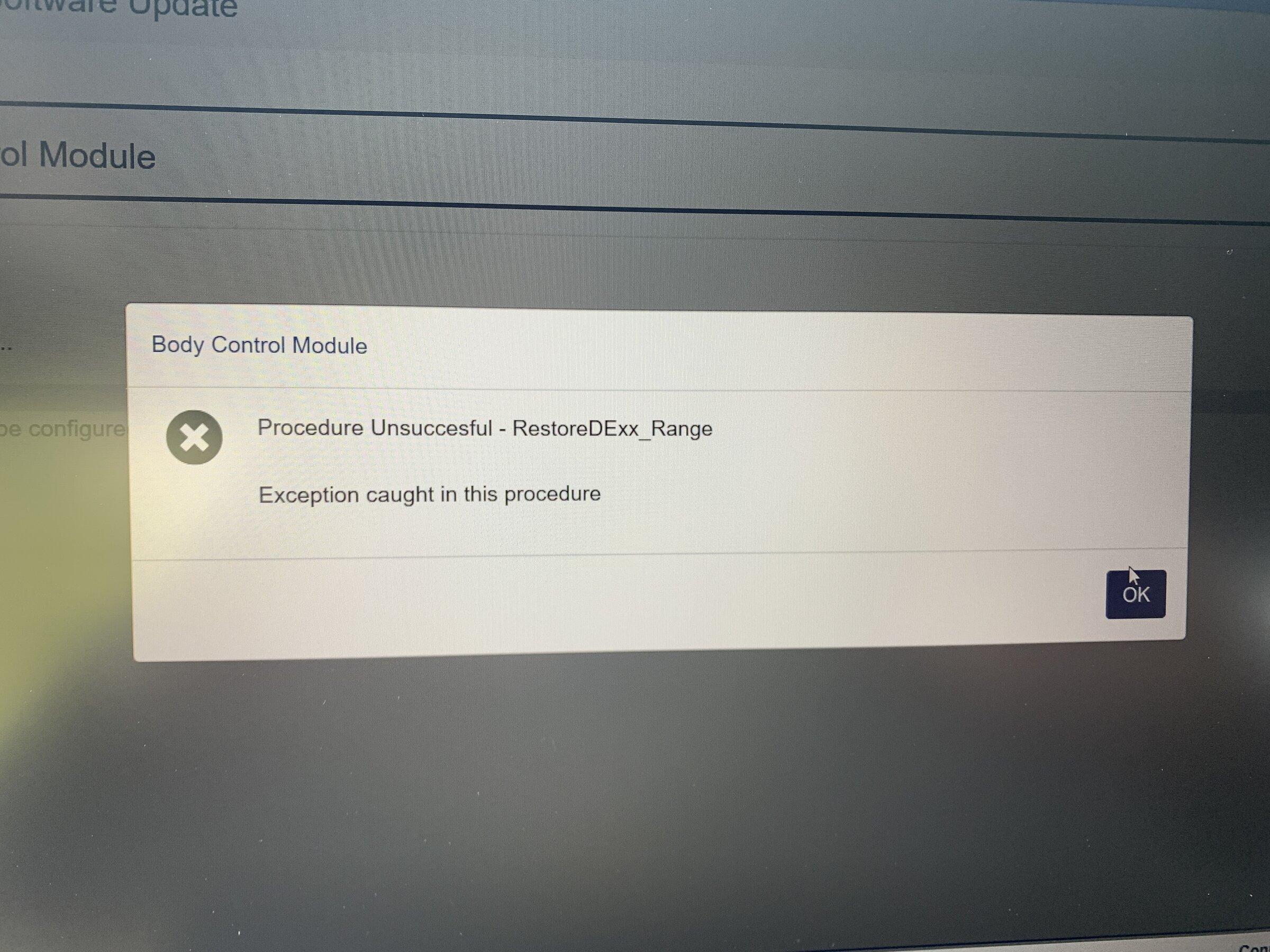

Has anyone had this error with the BCM update? Have tried it several times and still getting the same error.
I had a similar error that came up when I went to run the ABS update after it was already applied.
Got it to work! Had to have the door closed when I updated!
