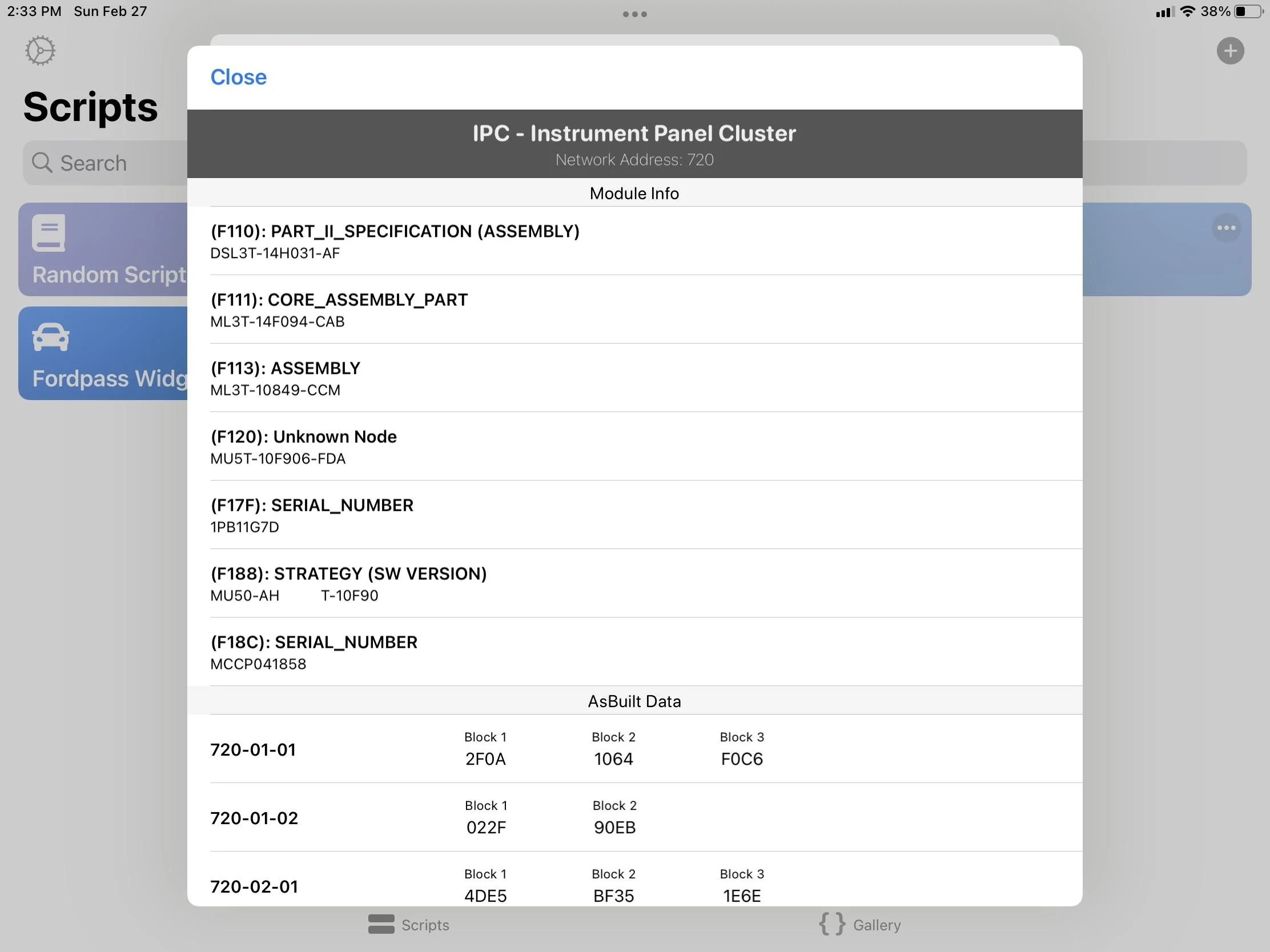

Forgive me if this has been asked before, but the thread is now over 1000 post long, so I might have missed it. Is there a way to check if we have corruptions on the server after our license has expired? Is that possible digging into the data with the widget?
JEB
Aug 15, 2021
576
393
Northern Illinois
2021 F-150 Lariat Powerboost
Yep. There are a few ways. But the widget is how I do it. A big telltale is spaces in the software version or VIN that shouldn’t be there when you look at the module data. There should be no spaces between characters in any of the fields.
An example of a corruption is attached. Note the spaces in node F188.
Ford F-150 Lightning ECU module programming guide using FDRS 7D244C1B-2E04-4EA0-BA12-480A37BFE478
