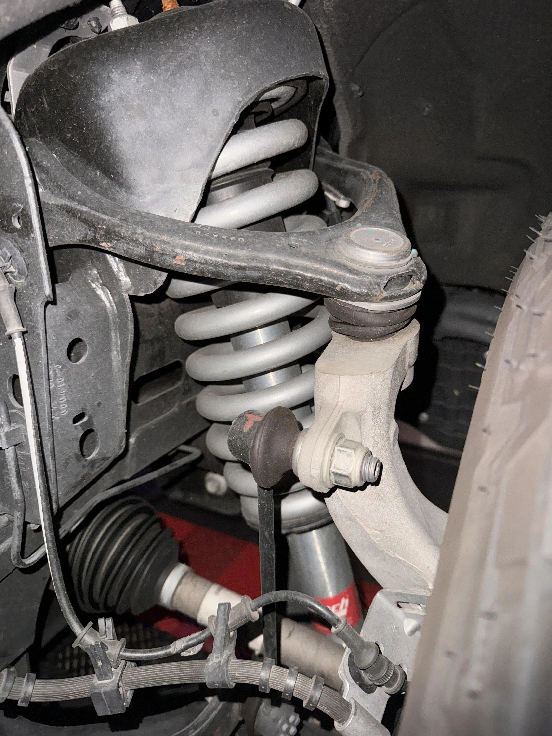

I was the test vehicle for these.
Stage1 is shocks and Leveling Springs
The shocks will also work for the lowering springs when they are released.
Ford F-150 Lightning Eibach shocks for Lightning is live on their website! IMG_0391
