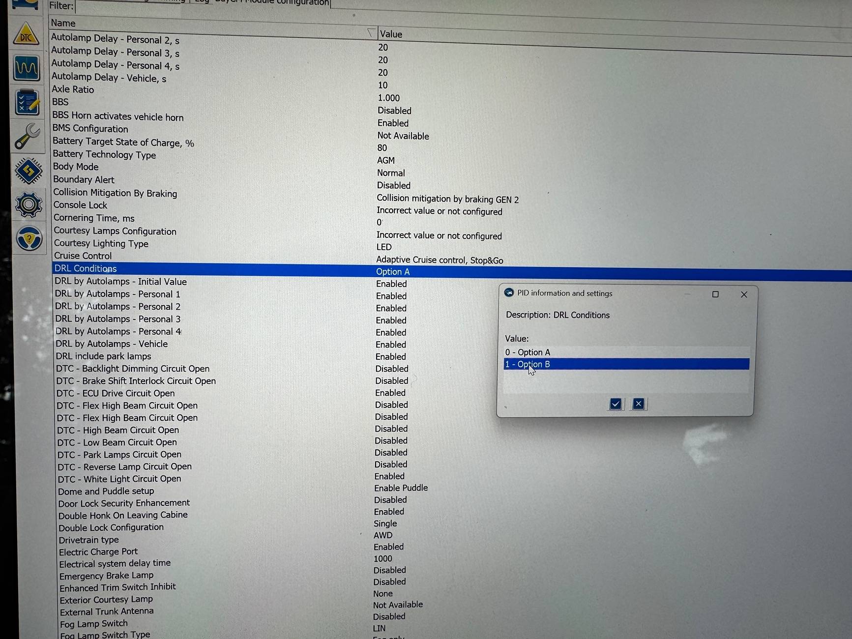

For anyone curious about Global Windows without “As Built”, I went ahead and did a quick pic before and after on the BCM. Just three quick changes from “Disabled” for my truck. The other 3 modules are obvious as they just say “Global Windows” Up and Down.
