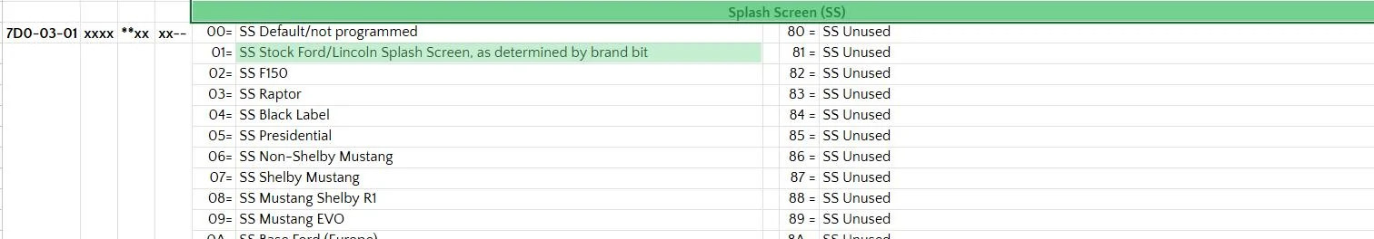

I seem to have lost the welcome/boot animation on my sync screen
2022 Lariat SR
I’m 99% sure it stopped happening after the mobile ford tech came out and updated my IPMA, BECM and BCM - ruining my 12v battery in the process.
I assumed it was due to the low 12v as a way to reduce draw on the battery but after putting in a fresh 12v and resetting the BMS it has not returned.
I have made all of the typical updates with Forscan
But all of them were done prior to the tech updating my truck and I don’t recall the animation missing before that.
Is there an as-built or config I should check in Forscan?
Thanks

You might search for splash screen. There are a few posts where folks have tried to both enable and change/disable. Not sure they have succeeded though.

@3121 Look here. Right now, Ford shows you have a 1F there which is correct for a BEV. See if FORScan shows otherwise.

Does your system boot faster with that not showing? As bmwwhitex states, some of us have been trying to get that to be disabled (to validate).
Watching for your response/reply to rugedraw to see what you show on that line. :question:
EDIT: Oh, we were messing with: (IPC quickboot) IPC 720-07-01 xxxx xxxx 4xxx line during trials.

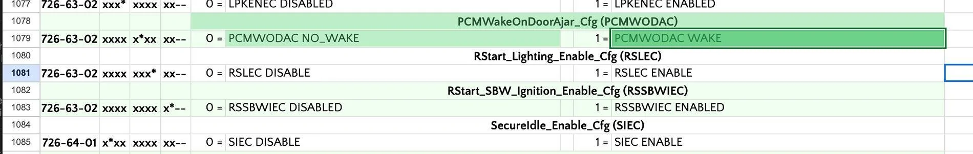

Checking these settings now on the BCM
