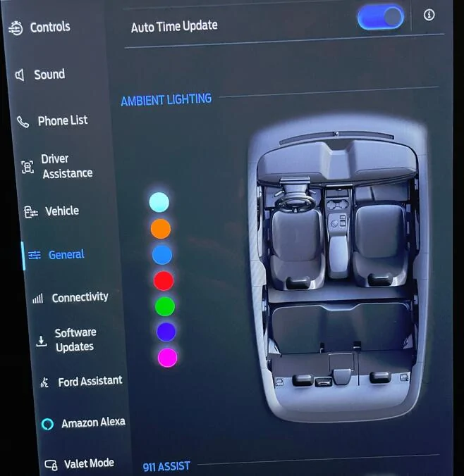

A couple things on my radar but not on the sheet (yet):
-MyColor options – also in both modules, possibly just waiting to be unlocked.
The Mach-E and older versions of the ICE F-150 had multi-color ambient lighting. We have only had Ice Blue (a single color LED). I suspect this parameter refers to the custom color you have selected if you have the Mach-E (or other models that support multi-color).
FYI, there is somewhat expensive mod where you can change all your LED's from Ice blue to the multi-color. Then you can enable a menu in Sync to select your color. I documented it here.
Ford F-150 Lightning F150 Lightning FORScan thread - Version 2 1753054938605-2n
This is on my own Sync screen but notice the graphic is of a Mach-E!

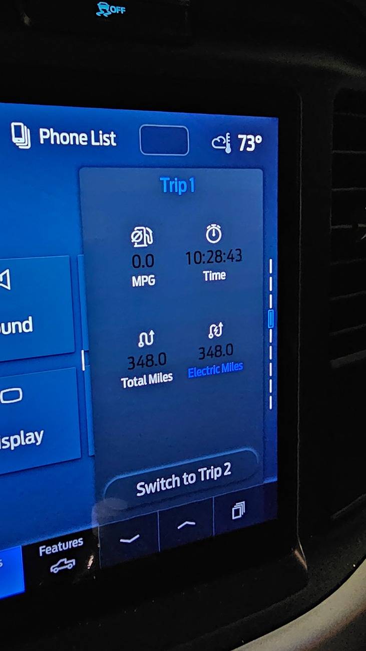

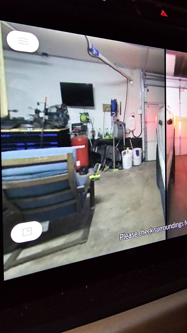

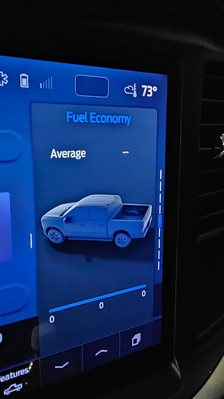

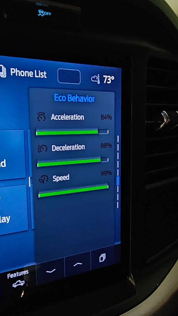

Did some messing tonight and here is what I found.
Police Dark Mode didn't seem to do anything
Pip did add a button to some camera screens, but it didn't actually function
Ford F-150 Lightning F150 Lightning FORScan thread - Version 2 20250720_222519
Tried adding various adaptive steering. Adaptive steering manual, etc (all clustered together in forscan easy mode) and did not observe any changes.
On the plus side the IOD displays ARE the Sync (12") "cards" that appear on the right of say the Audio display. This has Nav, Phone, Trip, etc. Some were able to be added although Tpms and aux never showed up.
