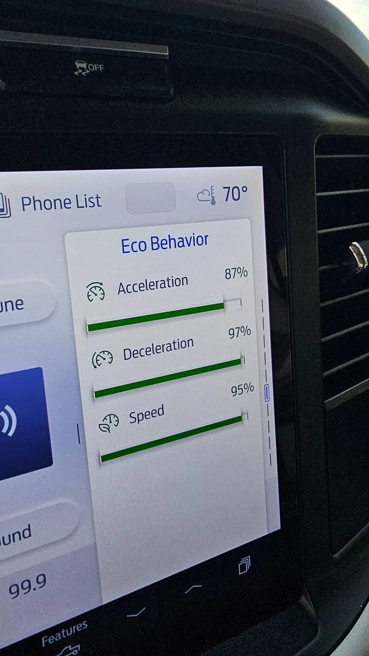

Of the displays i added (fuel economy, trip1/2, eco something) they mostly do not add value. Fuel economy does not work (not surprised), Trip1/2 does not add value.
Eco mode did "something", if its working right, or of value, I have no idea. This was from my drive to work.

Sure, let me give a quick follow-up on the additional APIM displays I enabled—unfortunately, most didn’t add much value beyond what’s already available on the truck:
  • Fuel Economy: This appears to be designed for gas vehicles and does not function correctly on the Lightning.
  • Trip 1 / Trip 2: These show similar info to the existing Trip display, but add MPG (which reads 0.0).
  • AUX Camera: This option didn’t display anything. It’s possible it only shows up when a trailer camera is connected.
  • Eco Behavior: Shows the odd bar graph I mentioned earlier. It starts at 99% and may drop while driving, but the logic behind it wasn’t clear, so I didn’t spend time analyzing it further.
  • TPMS: This already showed as enabled for my truck but there is no visible display on the center screen.

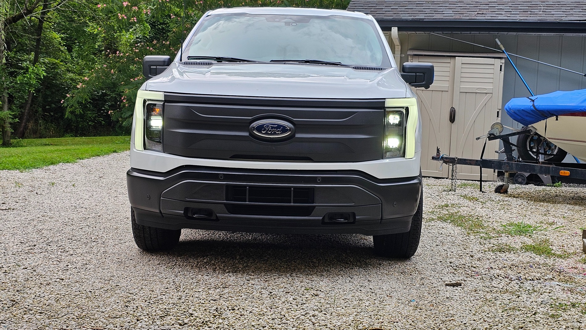

Messed with the headlights some more tonight, capturing it here if anyone else goes looking.
First update, tried to enable VDB in the HCM module. Not sure the function here but in a bmw vdb widens the beam at low speed, at high speed it narrows it and raises the beam slightly. Unfortunately it just threw a checksum DTC and disabled bending beams and gfhb.
I have previously tried to enable camera and map based bending. That also causes a checksum DTC.
Beyond that I tried enabling welcome/farewell on the DRL, Low Beam, and SML (side marker light), no effects that i could see. This was on my pro so not sure if it may work on other modules.
Previously I enabled EVERY welcome farewell setting in the LDCMA and got weird results
Ford F-150 Lightning F150 Lightning FORScan thread - Version 2 20250727_194214
So probably something here, just not sure what it is.
I also enabled sequential welcome farewell for the drl, also no change.
Last, I tried adding a delay to one segment in the welcome led drl, also no change.
Big lack of results, but it was fun trying

Assume the Eco behavior screen is probably for hybrids?
I used to have a 2010 fusion hybrid, and my daughter has one now (2018)and you can scroll through some of the menus to get to something along those lines. To help you drive more fuel efficiently.
Firn
Aug 26, 2024
1,563
1,796
23 Pro ER
After some testing It does work for our trucks. After watching it a while the bars work down from 100% as you drive less eco-friendly.
I dont find it particularly useful, but it at least functions

Don’t we already have auto leveling enabled? At least with lariat trims and up? I do find it interesting that in my buddy’s 23 lariat PB his lights on start up go up and down and side to side. But in my 23 lariat the lights go side to side in startup but no up and down. And I do have sensors. One in the rear and one opposite in the front.
Does your '23 have the bed scales? I have a '23 Lariat as well and do not have the leveling sensors...and no bed scales.
I assumed those with leveling sensors, the light went 4-way (up/down/left/right) at start.
You may be able to test that FORScan setting.
47
3,077
4,399
I have a '22 with scales. All I have ever noticed is side to side at start :( .
astrand1
Alex
Dec 16, 2021
719
762
Studio truck driver
No scales. I wonder what the sensors are that are on the axles (front and rear) if not for the headlights. Unless they do auto level but they just don’t animate at startup. šŸ¤”
digitaldad
Jan 14, 2025
410
383
ABQ
2023 Lariat ER MaxTow
I'm sure they are for the headlights, wonder if yours was an early '23 build? Maybe you got the sensors right at the time of the scale delete...then by mine, it was both omitted. Mine is August '23 build.
astrand1
Alex
Dec 16, 2021
719
762
Studio truck driver
Mine was an August 23 build as well. I’ve got to look and see if there is a connector unused in the other rear wheel well.
