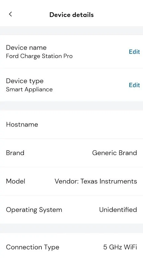

The blame belongs to TI, you could make the argument that Siemens should have sourced a better networking device for the system.
