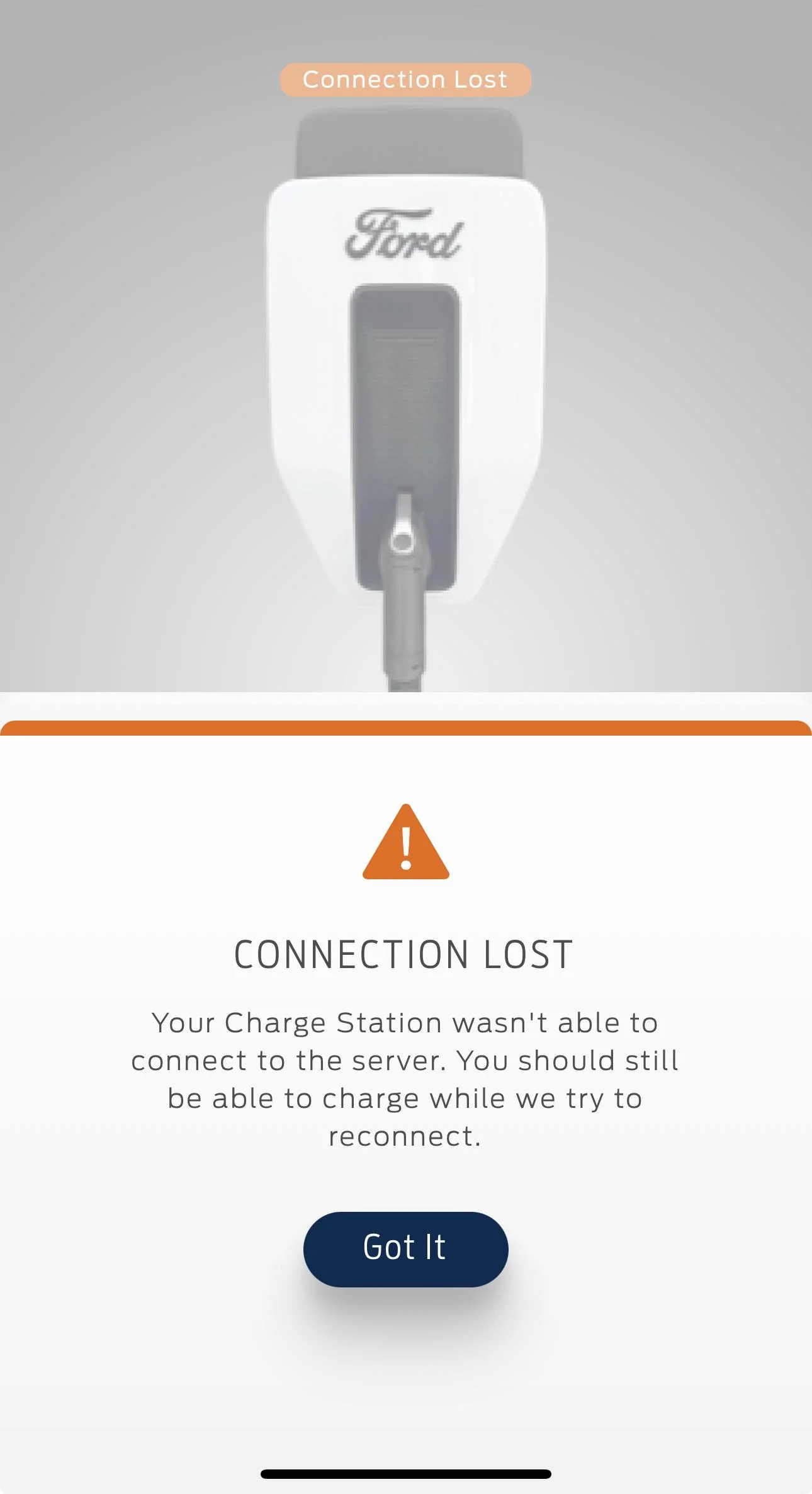

I noticed that the FCSP says connection lost through the FordPass app but I am able to connect to it through my Fcsp app. I’ve tried to reconnect it with no luck. I saw earlier threads about a ford server issue but that seems to have been resolved for some people. Do I have to cycle my power station and if so how do I do that?

Cycle power to it. Should be all good after that.
Turn it off. Wait 5 minutes. Turn it on. Give it about 10 or 15 minutes before you try to connect to it.
dumb question but where do I do that ? Does the unit have a power switch? At breaker box? Or do I have to turn off power to the whole house ?

Turn the breaker feeding it off.

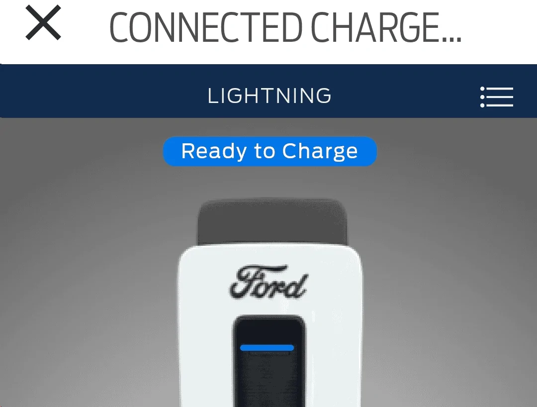

This situation can be intermittent on the Ford server side of the WWW, just wait it out, eventually service will be restored.
You can power cycle your FCSP by switching off the 100A circuit breaker for 5 minutes, then power back on and wait apx 10-30 minutes for it to try reaching the Ford cloud, assuming it's up.
Looking at mine just now, service appears to be active.

Mine has disconnected once again, was on this morning but not any more, I'll do a power cycle soon.

The power cycle seems to have fixed this instance, switched off waited 30 seconds, switched on waited 30 more seconds, plugged in the truck, 20 minutes later I took a peak at the app, now reporting online again.
Sometimes this works, sometimes it doesn't (like last week 2/9 to 2/16)

I too, verified that the FCSP was talking to my network earlier after noticing the outage, all seemed fine from my point, but it's odd that a power cycle would fix communication issues further downstream.
IIRC, someone mentioned months ago that there is an issue with the FCSP communicating with the host, when that happens the cycling usually fixes the issue, ..... except when it doesn't!
