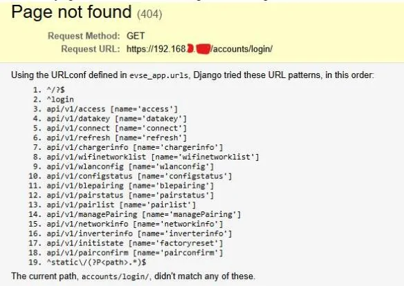

And when trying to access the /accounts/login/ url suffix I get this
Ford F-150 Lightning FCSP RS485 port access Success! 1750732955618-2m
I tried to access these urls but get kicked back to the root page.
Note: I did not add these stars under password
I've attached the file if anyone's interested or know more about Django to dig through. It looks like you're not allowed to upload HTML files so just remove the .txt and it will open in a browser.

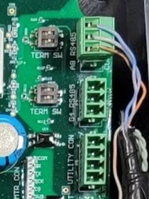

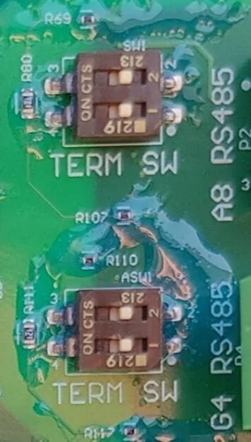

Does anyone know what these switches next to the rs485 ports do or have read about them being involved in the HIS setup?
In summary, "TERM SW" on a circuit board points to a switch specifically used for termination within a circuit or system, such as in RS-485 applications.
In the fully wired HIS (SunRun doc) the top RS485 is wired and the SW are like this (no change):
Ford F-150 Lightning FCSP RS485 port access Success! TERM SW at RS 485 location-wide vi
Too small to read the SW position, probably indicates an ON or OFF state?
Hopefully this is a better quality photo. it looks like they're in the off state.
Yes "off state", which mine were when new, and are with a fully wired HIS.
"ON CTS" generally means "ON Clear To Send" line.
  • CTS (Clear To Send): CTS is a handshaking signal that helps devices communicate data reliably. It allows the receiving device (e.g., your circuit board) to signal to the transmitting device (e.g., another microchip) when it is ready to receive data.
  • "ON CTS" on a switch: A switch labeled "ON CTS" likely controls whether the CTS signal is active or not. When the switch is in the "ON" position, the CTS signal is enabled, allowing hardware handshaking to be used for data flow control between the circuit board and another device
The process is similar to a conversation.
  • RTS (Request To Send): The transmitter indicates it has data to send.
  • CTS (Clear To Send): The receiver indicates it is ready to receive data
If the "ON CTS" switch is enabled, the circuit board (receiver) can signal to the transmitter when it's ready to receive data, preventing data loss.
However, that is just the general usual situation - what the FCSP circuit board uses these switches for has not been in any documentation I have seen yet, so they could have a special purpose.
Anyway if there is no HARDWARE handshaking going on it is all software by default.
