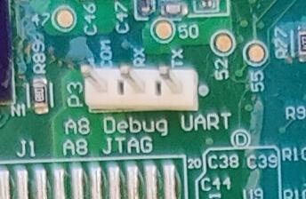

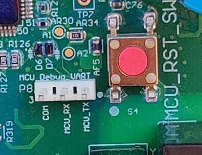

I made some more hardware access attempts this afternoon and was able to get output with the P8 pins and putty with a baud rate of 38400 after pressing the MCU_RST_SW button. Don't know what it means and was never able to make an input when the SFT> prompt showed.

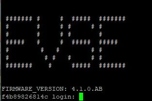

So I thought I would try and do the same with the P3 pins and was able to get a telnet terminal using baud rate 115200. At first it shows and blank and after hitting enter a few times the login prompt and EVSE banner show. I still don't know what the creds are but probably the same as the SSH if those are ever discovered.
Ford F-150 Lightning FCSP RS485 port access Success! 1750810278391-1a
Ford F-150 Lightning FCSP RS485 port access Success! 1750810327506-vz
Not sure what to do with these access points. Anyone know where or have a suggestion on where togo from here?

Ooh, that EVSE prompt looks very promising. Have you tried any logins on it. Here are a few to start with:

I think it may be admin and for the password the serial number of the unit.

No Dice :/

The next thing to try is hook up to that uart and power cycle the FCSP and see if it gives us any clues during boot up
I don’t have a usb serial adapter handy or I would, but I’ll see if I can get one to start playing with this.

I pressed both the A8 RST button and the MCU_RST_SW while connected to the telnet and it didn't change the output/terminal at all. I wonder if the A8 RST button is a reset for the A8 RS485 connection.
WOW, I completely miss read that. I will have to try to power cycle while connected tomorrow.

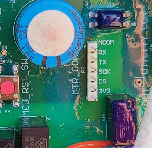

while at it I hooked up to the MTR_CON which I think stands for "Monitor Connector/tion" and received alot of noise I think I need to hook up the SCK pin that will solve the noise issue. Just don't have it setup with the wiring for that at the moment.

[    2.418256] usb usb1: Manufacturer: Linux 4.9.126-g259f2e0422 musb-hcd
[    2.425204] usb usb1: SerialNumber: musb-hdrc.0
[    2.431797] hub 1-0:1.0: USB hub found
[    2.436013] hub 1-0:1.0: 1 port detected
[    2.558046] bq32k 2-0068: setting system clock to 2025-06-27 20:33:30 UTC (1751056410)
[    2.569223] vwl1837: disabling
[    2.572554] vdd2: disabling
[    2.580968] Waiting for root device PARTUUID=4f9cc8ba-02...
[    2.632491] mmc2: new high speed MMC card at address 0001
[    2.639814] mmcblk2: mmc2:0001 W62704 3.53 GiB
[    2.645340] mmcblk2boot0: mmc2:0001 W62704 partition 1 2.00 MiB
[    2.652162] mmcblk2boot1: mmc2:0001 W62704 partition 2 2.00 MiB
[    2.660753]  mmcblk2: p1 p2 p3
[    2.837793] EXT4-fs (mmcblk2p2): recovery complete
[    2.844016] EXT4-fs (mmcblk2p2): mounted filesystem with ordered data mode. Opts: (null)
[    2.852748] VFS: Mounted root (ext4 filesystem) on device 179:2.
[    2.864289] devtmpfs: mounted
[    2.871525] Freeing unused kernel memory: 1024K
[    2.994661] usb 1-1: new high-speed USB device number 2 using musb-hdrc
[    3.166025] usb 1-1: New USB device found, idVendor=0bda, idProduct=8153
[    3.173108] usb 1-1: New USB device strings: Mfr=1, Product=2, SerialNumber=6
[    3.194721] usb 1-1: Product: USB 10/100/1000 LAN
[    3.199694] usb 1-1: Manufacturer: Realtek
[    3.204010] usb 1-1: SerialNumber: 000001
[    3.224451] systemd[1]: systemd 234 running in system mode. (+PAM -AUDIT -SELINUX +IMA -APPARMOR +SMACK +S                                                                                     YSVINIT +UTMP -LIBCRYPTSETUP -GCRYPT -GNUTLS +ACL +XZ -LZ4 -SECCOMP +BLKID -ELFUTILS +KMOD -IDN2 -IDN default                                                                                     -hierarchy=hybrid)
[    3.247872] systemd[1]: Detected architecture arm.
Welcome to Arago 2018.10!
[    3.286309] systemd[1]: Set hostname to <SWA44VFY>.
[    3.404902] usb 1-1: reset high-speed USB device number 2 using musb-hdrc
[    3.603493] systemd-fstab-generator[106]: Checking was requested for "i/dev/root", but it is not a device.
[    3.635067] r8152 1-1:1.0 eth1: v1.08.9
[    4.328188] random: systemd: uninitialized urandom read (16 bytes read)
[    4.342002] systemd[1]: Created slice User and Session Slice.
[  OK  ] Created slice User and Session Slice.
[    4.375171] random: systemd: uninitialized urandom read (16 bytes read)
[    4.383025] systemd[1]: Listening on Journal Socket.
[  OK  ] Listening on Journal Socket.
[    4.415212] random: systemd: uninitialized urandom read (16 bytes read)
[    4.422789] systemd[1]: Listening on Journal Socket (/dev/log).
[  OK  ] Listening on Journal Socket (/dev/log).
[    4.487559] systemd[1]: Reached target Swap.
[  OK  ] Reached target Swap.
[    4.516003] systemd[1]: Started Forward Password Requests to Wall Directory Watch.
[  OK  ] Started Forward Password Requests to Wall Directory Watch.
[    4.580969] systemd[1]: Listening on Process Core Dump Socket.
[  OK  ] Listening on Process Core Dump Socket.
[    4.618350] systemd[1]: Created slice System Slice.
[  OK  ] Created slice System Slice.
         Mounting Temporary Directory (/tmp)...
[  OK  ] Reached target Slices.
[  OK  ] Created slice system-serial\x2dgetty.slice.
[  OK  ] Created slice system-getty.slice.
         Starting Remount Root and Kernel File Systems...
[  OK  ] Listening on udev Control Socket.
[    4.959097] EXT4-fs (mmcblk2p2): re-mounted. Opts: (null)
         Mounting POSIX Message Queue File System...
[  OK  ] Started Dispatch Password Requests to Console Directory Watch.
[  OK  ] Reached target Paths.
         Starting Load Kernel Modules...
[  OK  ] Reached target Remote File Systems.
[    5.153695] cryptodev: loading out-of-tree module taints kernel.
[  OK  ] Listening on /dev/initctl Compatibility Named Pipe.
[    5.167550] cryptodev: driver 1.9 loaded.
         Starting Journal Service...
         Mounting Kernel Debug File System...
[  OK  ] Listening on udev Kernel Socket.
[  OK  ] Listening on Network Service Netlink Socket.
[  OK  ] Mounted Kernel Debug File System.
[  OK  ] Mounted POSIX Message Queue File System.
[  OK  ] Mounted Temporary Directory (/tmp).
[  OK  ] Started Remount Root and Kernel File Systems.
[  OK  ] Started Load Kernel Modules.
         Starting Apply Kernel Variables...
         Mounting Kernel Configuration File System...
         Starting udev Coldplug all Devices...
         Starting Create Static Device Nodes in /dev...
[  OK  ] Mounted Kernel Configuration File System.
[  OK  ] Started Journal Service.
[  OK  ] Started Apply Kernel Variables.
         Starting Flush Journal to Persistent Storage...
[  OK  ] Started Create Static Device Nodes in /dev.
[  OK  ] Reached target Local File Systems (Pre).
         Mounting /media/ram...
         Mounting /var/volatile...
         Starting udev Kernel Device Manager...
[  OK  ] Mounted /var/volatile.
[  OK  ] Mounted /media/ram.
[    6.852126] systemd-journald[123]: Received request to flush runtime journal from PID 1
         Starting Load/Save Random Seed...
[  OK  ] Reached target Local File Systems.
[  OK  ] Started udev Kernel Device Manager.
[  OK  ] Started Flush Journal to Persistent Storage.
[  OK  ] Started Load/Save Random Seed.
         Starting Create Volatile Files and Directories...
[  OK  ] Started Create Volatile Files and Directories.
         Starting Update UTMP about System Boot/Shutdown...
[  OK  ] Started Update UTMP about System Boot/Shutdown.
[   11.180906] omap_rtc 44e3e000.rtc: rtc core: registered 44e3e000.rtc as rtc1
[  OK  ] Found device /dev/ttyO0.
[  OK  ] Started udev Coldplug all Devices.
[  OK  ] Reached target System Initialization.
[  OK  ] Listening on Avahi mDNS/DNS-SD Stack Activation Socket.
[  OK  ] Listening on D-Bus System Message Bus Socket.
         Starting Network Service...
[  OK  ] Started Daily Cleanup of Temporary Directories.
[  OK  ] Reached target Timers.
         Starting sshd.socket.
[  OK  ] Listening on sshd.socket.
[  OK  ] Reached target Sockets.
[  OK  ] Reached target Basic System.
         Starting Network Time Service (one-shot ntpdate mode)...
[  OK  ] Reached target Containers.
[  OK  ] Started A userspace daemon that run…ns under the eCryptfs mount point.
         Starting LSB: System logger...
         Starting Login Service...
[  OK  ] Started Periodic Command Scheduler.
[  OK  ] Started D-Bus System Message Bus.
[   15.808672] remoteproc remoteproc0: wkup_m3 is available
[   16.194979] remoteproc remoteproc0: powering up wkup_m3
[   16.303081] remoteproc remoteproc0: Booting fw image am335x-pm-firmware.elf, size 224708
[   16.407416] wkup_m3_ipc 44e11324.wkup_m3_ipc: CM3 Firmware Version = 0x192
[   16.494928] remoteproc remoteproc0: remote processor wkup_m3 is now up
         Starting Avahi mDNS/DNS-SD Stack...
[  OK  ] Started Network Time Service (one-shot ntpdate mode).
[  OK  ] Started Network Service.
[   17.305576] IPv6: ADDRCONF(NETDEV_UP): eth1: link is not ready
[   17.965416] IPv6: ADDRCONF(NETDEV_UP): eth0: link is not ready
[   17.976134] eth0: SPI thread created
[   19.044811] QCA7000 Reading signature
[   19.048768] QCA7000 read signature Pass
[   19.052832] QCA7000 sync Success
[   19.117633] IPv6: ADDRCONF(NETDEV_CHANGE): eth0: link becomes ready
[   19.646026] omap-sham 53100000.sham: hw accel on OMAP rev 4.3
[   19.739939] omap-aes 53500000.aes: OMAP AES hw accel rev: 3.2
[   19.780548] omap-aes 53500000.aes: will run requests pump with realtime priority
[  OK  ] Started LSB: System logger.
[   24.865454] wl18xx_driver wl18xx.0.auto: Direct firmware load for ti-connectivity/wl1271-nvs.bin failed wi                                                                                     th error -2
[*     ] (1 of 2) A start job is running for Login Servic[   25.336763] wlcore: wl18xx HW: 183x or 180x, PG 2                                                                                     .2 (ROM 0x11)
e (21s / 1min 39s)[   25.400175] wlcore: loaded
[***   ] (1 of 2) A start job is running for Login Service (21s / 1min 39s)[   26.162661] wlcore: PHY firmwar                                                                                     e version: Rev 8.2.0.0.245
[   26.286317] wlcore: firmware booted (Rev 8.9.0.0.88)
[   26.345698] IPv6: ADDRCONF(NETDEV_UP): wlan0: link is not ready
[  OK  ] Started Avahi mDNS/DNS-SD Stack.
[  OK  ] Started Login Service.
         Starting drivers.service...
         Starting evse-startup.service...
[  OK  ] Reached target Network.
         Starting DNS forwarder and DHCP server...
         Starting Permit User Sessions...
         Starting Network Name Resolution...
         Starting Network Time Service...
[  OK  ] Started Permit User Sessions.
[   29.175406] reset_miscdev.minor=55
[   29.215512] reset driver prm[2]: 0x00000001
[   29.219943] reset driver scratch: 0x00000000
[   29.224434] reset driver scratch verify: 0xAAAA5555
[   29.325127] reset driver prm[2]: 0x00000000
[   29.329554] reset driver ret=0
[  OK  ] Started Serial Getty on ttyO0.
[  OK  ] Started Getty on tty1.
[  OK  ] Reached target Login Prompts.
         Starting Synchronize System and HW clocks...
[   29.661728] random: crng init done
[   29.665354] random: 7 urandom warning(s) missed due to ratelimiting
[FAILED] Failed to start DNS forwarder and DHCP server.
See 'systemctl status dnsmasq.service' for details.
[  OK  ] Started Synchronize System and HW clocks.
[  OK  ] Started Network Time Service.
[  OK  ] Started Network Name Resolution.
[  OK  ] Reached target Host and Network Name Lookups.
[   30.214832] gpio_miscdev.minor=54
[   30.218436] FactoryReset state is currently: 1
[   30.223115] Button: The button is mapped to IRQ: 97
         Starting The NGINX HTTP and reverse proxy server...
[   30.308448] ret=0
[   30.315399] Flash Thread has started running
[  OK  ] Started drivers.service.
[   30.988790] open from factory_reset.s
[   30.992979] Request from user: reset
[   31.053099] release from factory_reset.s
[  OK  ] Started The NGINX HTTP and reverse proxy server.
[   32.742290] EXT4-fs (mmcblk2p3): recovery complete
[   32.748396] EXT4-fs (mmcblk2p3): mounted filesystem with ordered data mode. Opts: (null)
         Starting helios_service.service...
[  OK  ] Started helios_service.service.
         Starting Time & Date Service...
FIRMWARE_VERSION: 4.1.0.AB
SWA44VFY login: [   56.821483] open from python
[   56.838695] Request from user: blue off
[   56.842792] Red set to OFF
[   56.864994] Request from user: green slow flash
[   56.869808] Green set to FLASH
[   56.873069] Request from user: red slow flash
[   56.904931] Red set to FLASH
[   56.908604] open from python
[   56.911810] read from python
[   56.955042] release from python
[  100.214937] NET: Registered protocol family 38
[  130.755020] Request from user: blue off
[  130.759125] Red set to OFF
[  130.762035] Request from user: green fast flash
[  130.775546] Green set to FLASH
[  130.779160] Request from user: red off
[  130.783131] Red set to OFF
[  132.237419] wlcore: down
[  136.400359] wlcore: PHY firmware version: Rev 8.2.0.0.245
[  136.502511] wlcore: firmware booted (Rev 8.9.0.0.88)
[  141.023318] wlan0: authenticate with 6c:5a:b0:88:4e:9a
[  141.033763] wlan0: send auth to 6c:5a:b0:88:4e:9a (try 1/3)
[  141.064254] wlan0: authenticated
[  141.079554] wlan0: associate with 6c:5a:b0:88:4e:9a (try 1/3)
[  141.105044] wlan0: RX AssocResp from 6c:5a:b0:88:4e:9a (capab=0x1011 status=0 aid=11)
[  141.157301] wlan0: associated
[  144.221273] wlcore: Association completed.
[  167.048935] Request from user: blue off
[  167.053071] Red set to OFF
[  167.074933] Request from user: green on
[  167.079020] Green set to ON
[  167.082010] Request from user: red off
[  167.094878] Red set to OFF
it will do the red set green set sequence forever until you hit enter then the EVSE login prompt shows.
