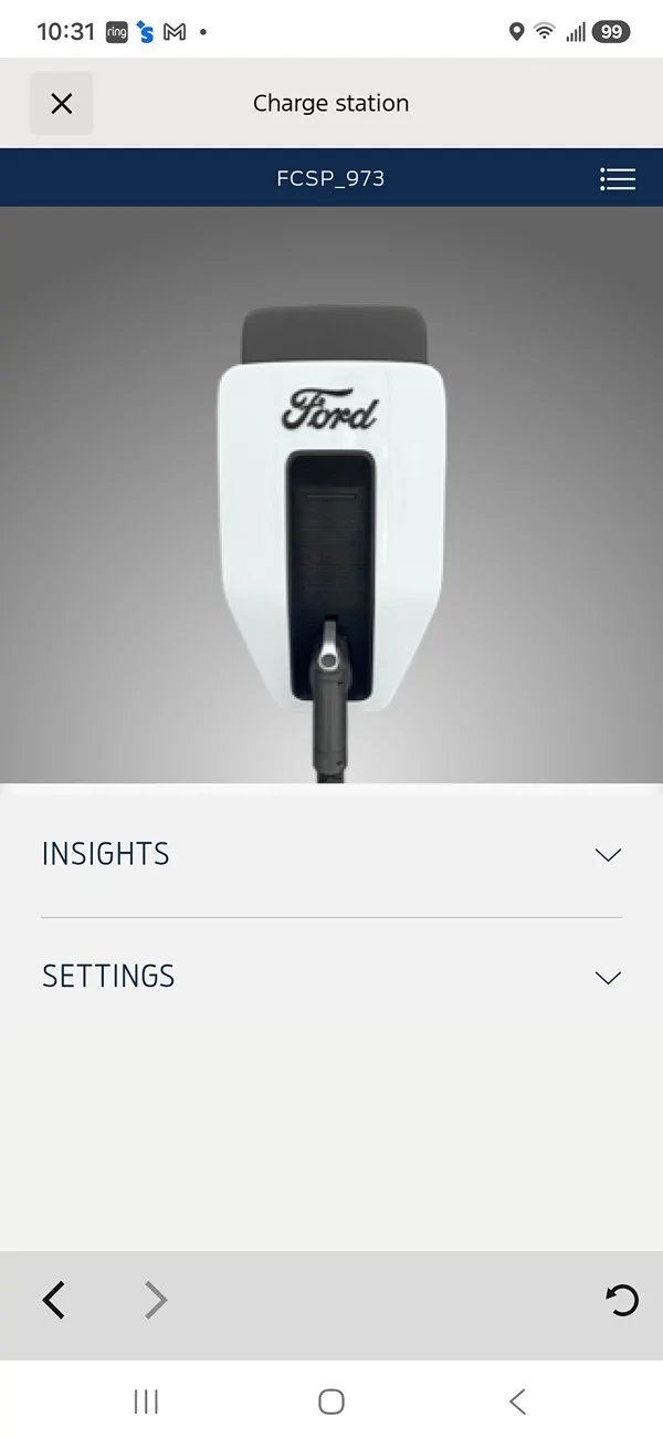

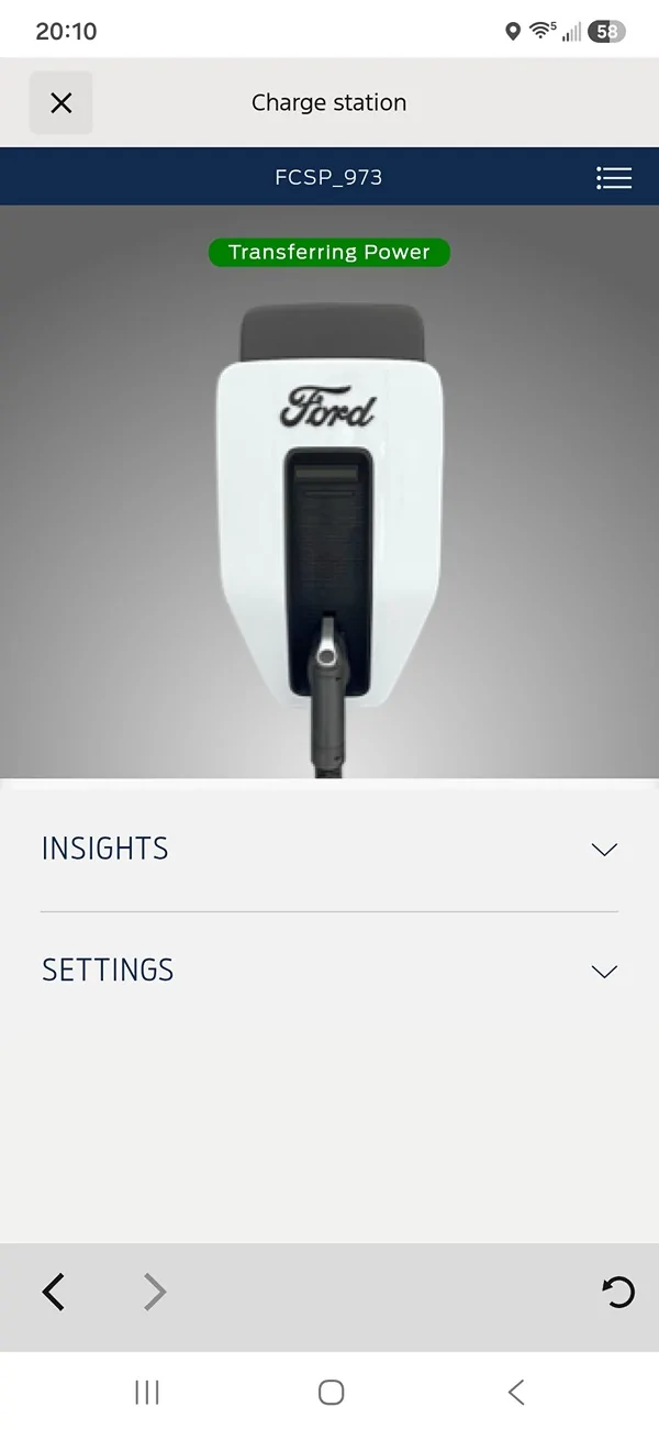

Last night charging session was unusual. I couldn't get any charging rate in the ford pass app. My charging station would show "not connected" in the fordpass app as well.
So in the morning when charging was done I decided to switch the breaker off before leaving for work. When I got home around 7pm I turned it on. After a few minutes I was able to see the FCSP connected and ready to charge in the fordpass app. I'm still not able to connect via the setup app though.

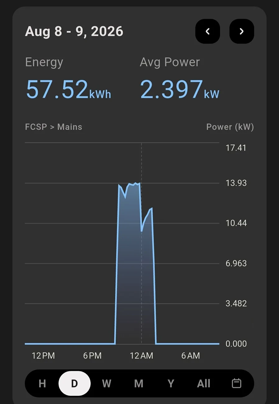

Interestingly I have insight data showing for last night session. I'm not too sure what to think about it.... as long as the truck gets its juice i'm happy. Although charging rate seems messed up. (My charging session are longer than usual)

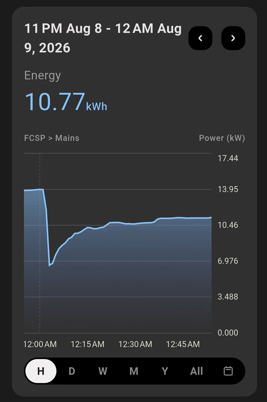

Yup, we had a local power event yesterday (PGE pays you $1 for every kWH you don't use using their peak power events, so I earn $20 from not using grid electricity for 3 hours and running the house off the truck).
After the event ended, I switched back to mains electricity, and the truck didn't properly switch back over. I reset the charging station, and now it's not connecting in the Fordpass app (but the FCSP is connecting to the Ford Charge Station Pro app and my home assistant integration).
In the FordPass app, I'm getting the "Connection Lost" error message that's plagued it since day 1.
I also lost my 11 kW derate and the truck charged at 19 kW, which is what I think killed the last... however many charging stations I had.
