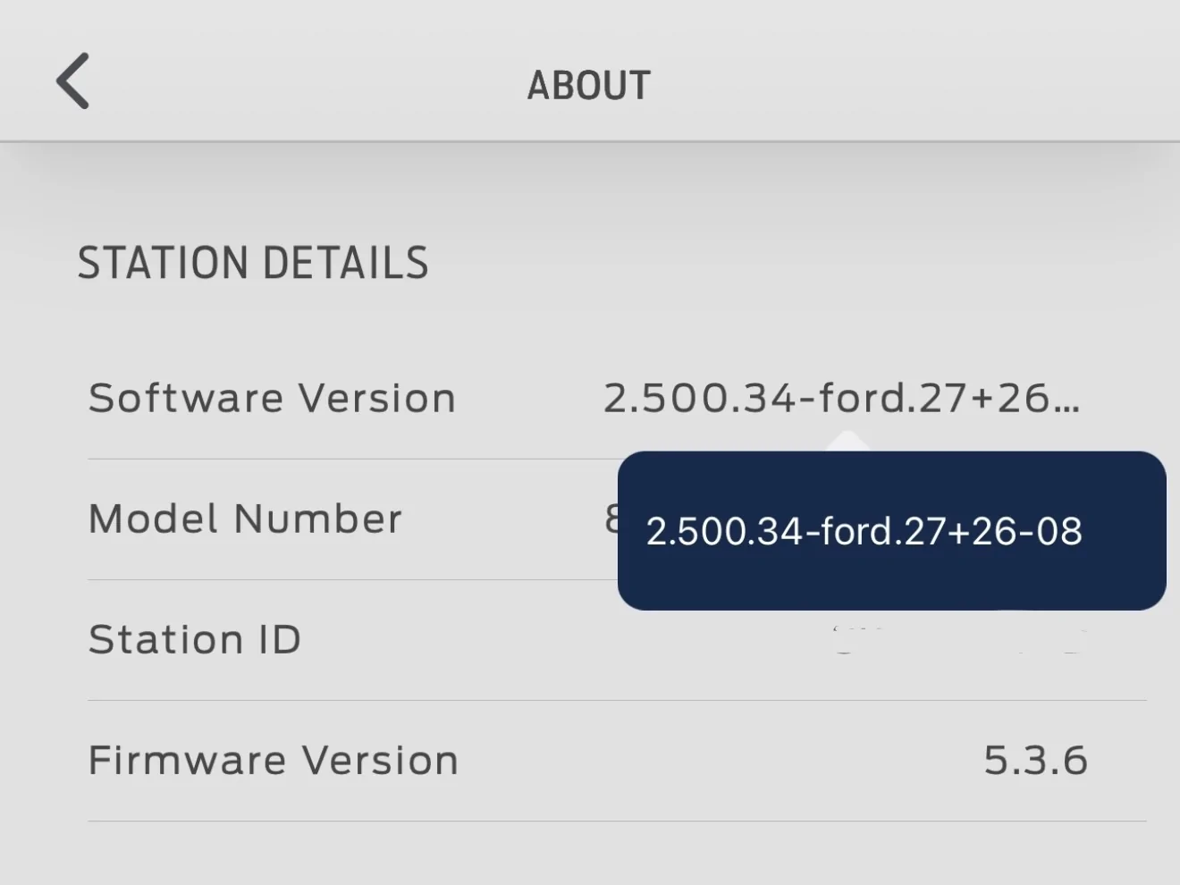

Boom! Updated!
Awesome to see!! Mine is failing to connect this morning, the system ID is being broadcast, but fails to login, I will power cycle the unit and see if that fixes the situation.

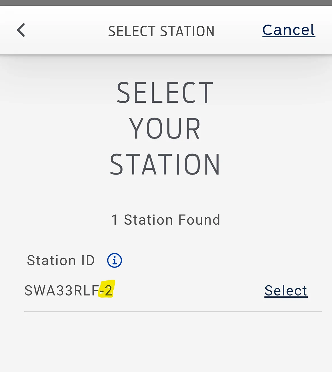

New station ID with suffix '-2' to the real name.
Still can not log in
Ford F-150 Lightning FCSP Software Version 2.500.34-ford.27+26-08 1785935642509-z

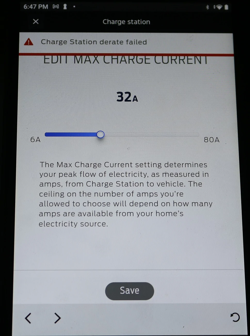

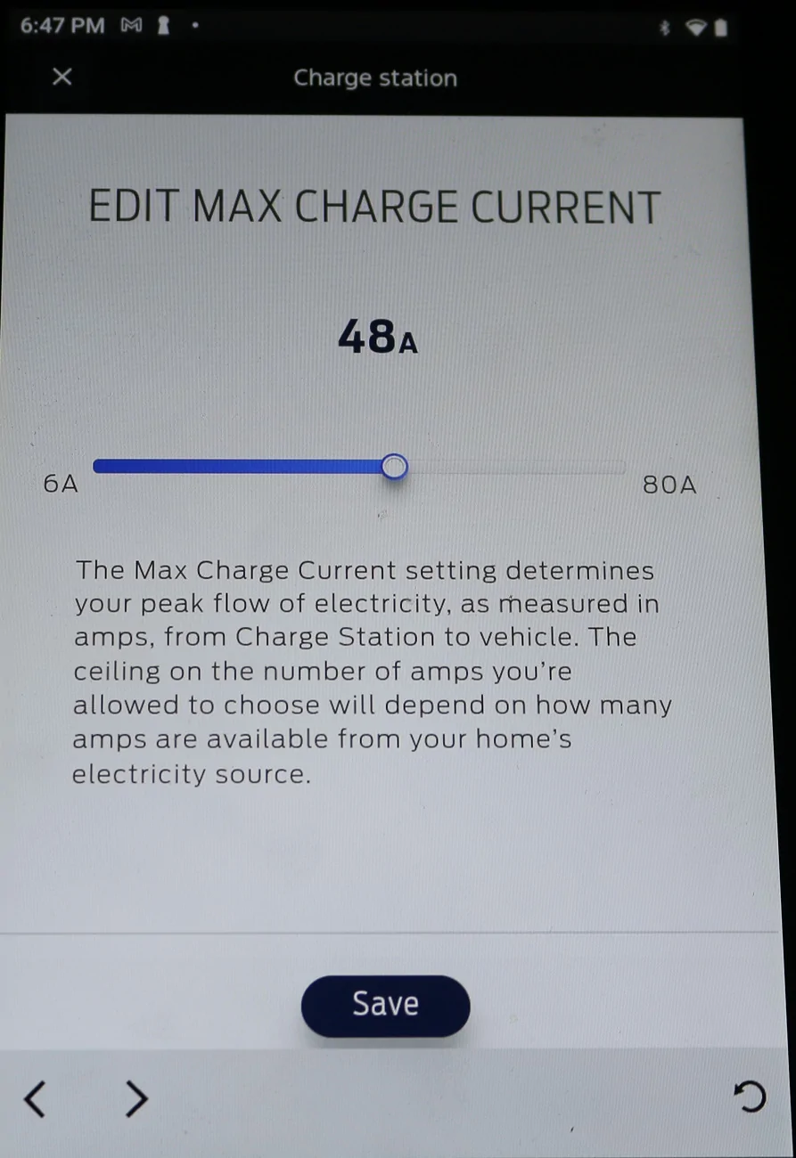

Here is the attempt to change the max current error notice:
Never saw this error before today.

I've had this exact problem for over a year. I usually derate over the summer to 60A as I still used to have over heating problems in my garage in peak summer heat. Now it's stuck cranking away at 80A. Thankfully the insulation I put in this past spring have kept temps in the garage down enough that I haven't encountered any over heating. It's still annoying, but I've come to accept it for what it is. I can still charge as I need and at full speed.
I haven't checked to see if it got this update since it doesn't impact me. I can check to see if it's of interest for tracking the roll out though.

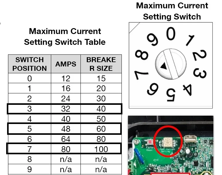

I guess you know you could pull the cover off and turn the dial on the circuit board (near the top next to the red reset button) down to the max amps you want - I could do that too, but I guess I don't care enough about it...a lot of screws to remove and I'd probably drop one and lose it, lol
Ford F-150 Lightning FCSP Software Version 2.500.34-ford.27+26-08 set max current to breaker siz
OMG that is weird! Mine is the same ID as always but still can't connect anymore....alas...
