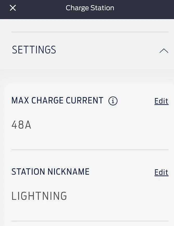

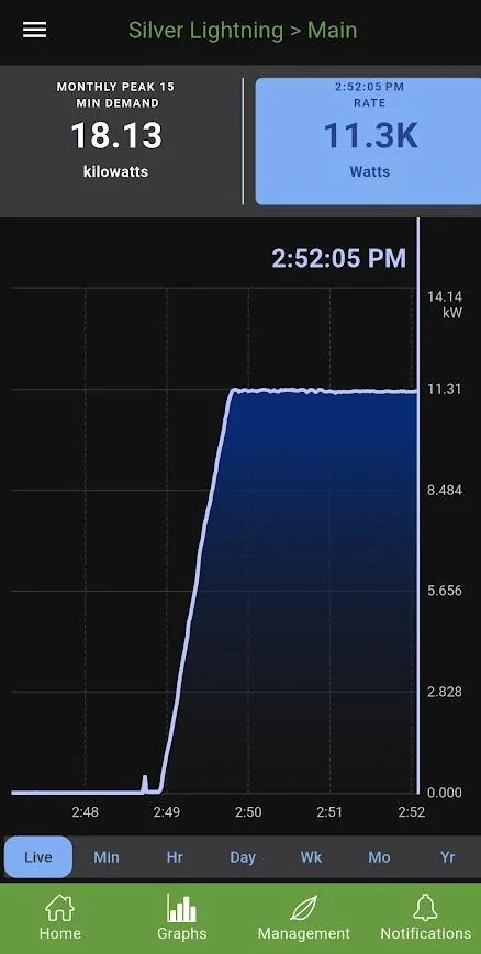

I adjusted the charging rate to 48 amps prior to plugging the truck into the FCSP.
Then plugged in, the rate of charge leveled out at 11.3 KW, I let this run for a while, the Fordpass app showed it's DC KW rate going into the battery as 10.4 KW ie. 92% of the AC rate, this is normal.
Then tried adjusting the rate on the fly while the charging session was still in process, the rate briefly increased a little then ramped back to 11.3 KW, then I paused {stopped} the session to make the rate adjustment once again to 80 amps, then resumed charging, it climbed back to 11.2 KW, at this point I decided to stop the charging session until I finished my daily afternoon walk.

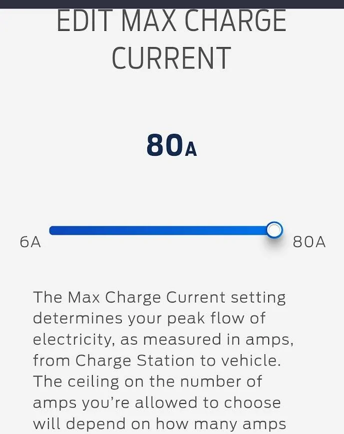

Confirmed the FCSP sub app rate of charge was set to 80 amps, then plugged is again.
This seemed to work the rate was much higher but not quite the peak I usually see, likely it's a hair under 80 amps, as the yellow derating lamp was illuminated.
I'll retest Thursday, I rebooted the FCSP and confirmed that my 80 AMP setting is showing on the app, it should go back to full rate in the next session, this has been the case in the past.

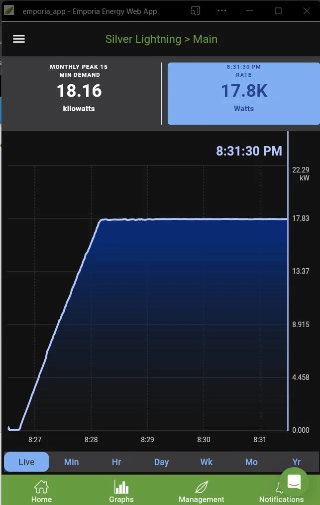

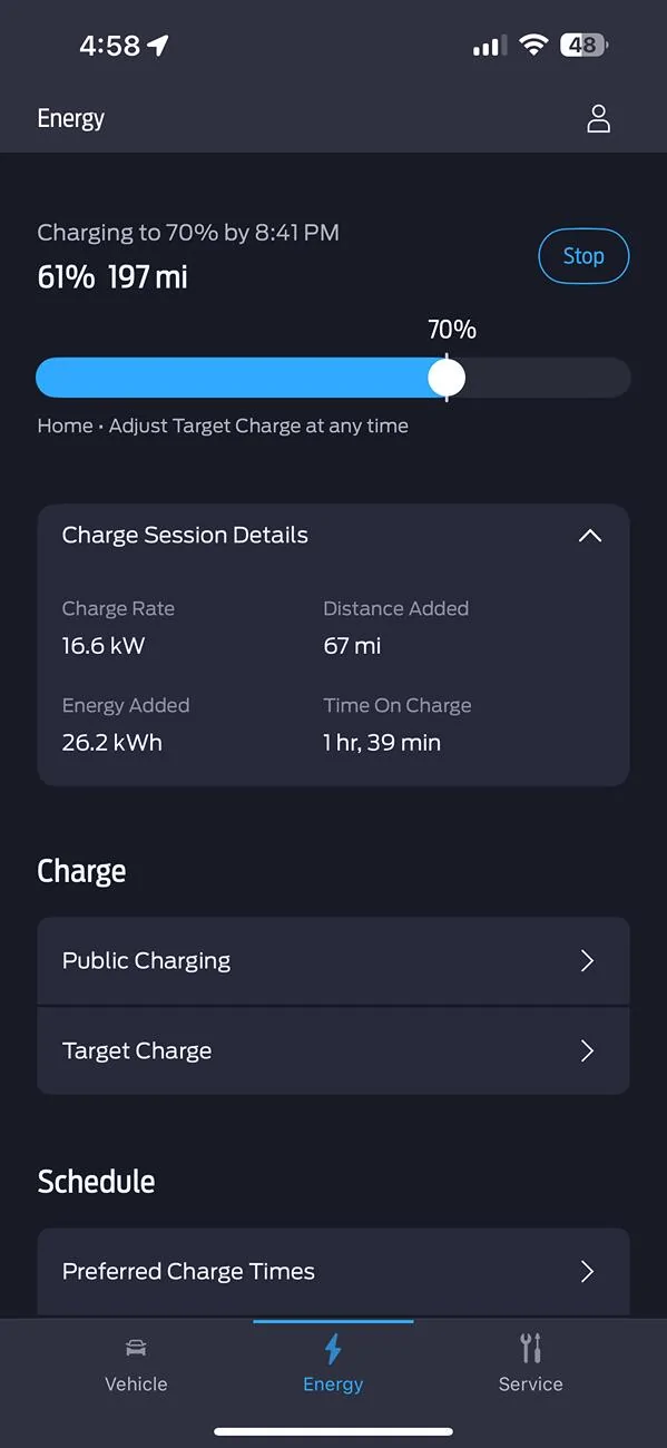

So I tested mine again today because I had derated it down to 40A last few days to match my solar production (raining today, so barely any production) I had already started a charge so I cranked it up to 80A in the Ford pass app it showed it going up to 16.6KWH or so then dropped back down to around 8.8KWH??
So then, I set it to 79A and it seemed to hold that rate around the 16.6 kWh again so then I adjusted it back to 80A and it has held since then??
Very strange!
Ford F-150 Lightning FCSP Software Version 2.112.125:3.15:3.15:3.15:3.15 IMG_1504
if I reboot, the FCSP I usually get +/- 18 KWH so this has me perplexed!

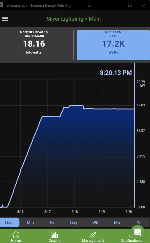

As measured through the Fordpass app, I've always seen a lower value around 16 to 17 kw even though my Emporia proves a higher rate around 18 kw, to me what you're seeing is normal.
My main point is that I was able to adjust it in the Ford pass app without rebooting the FCSP! Not quite able to get up to what I normally see in the app when I went up to 80 amp it ramped up and then came back down, but when I went to 79 amp it went up and stayed there even if it was a lower rate I did not reboot the FCSP like I have had to in the past??

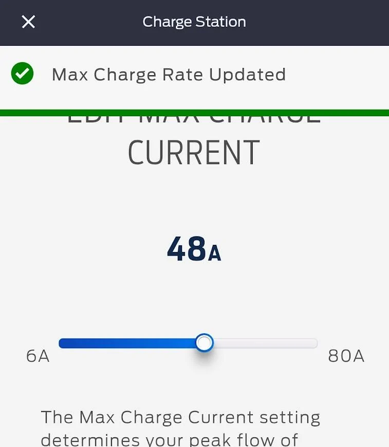

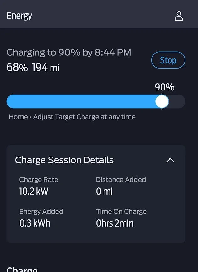

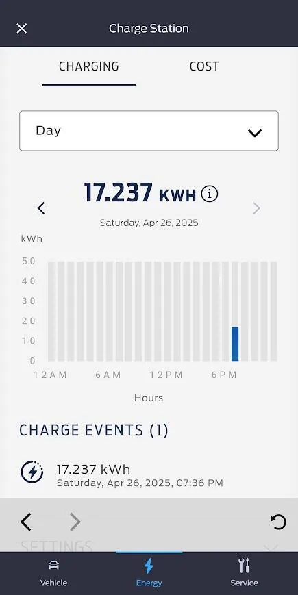

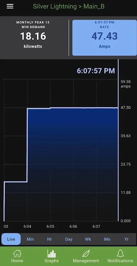

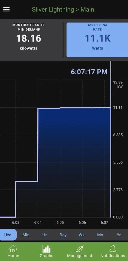

Couple days ago I lowered my amperage settings to 48A, tonight I've plugged in and it's reflecting the yellow indicator to the right side of the blue charging indicator. FCSP continues to show the 48 amp setting, Fordpass active charging data is showing the lower KW rating.
Ford F-150 Lightning FCSP Software Version 2.112.125:3.15:3.15:3.15:3.15 1745705624883-77
Ford F-150 Lightning FCSP Software Version 2.112.125:3.15:3.15:3.15:3.15 1745705639018-1r

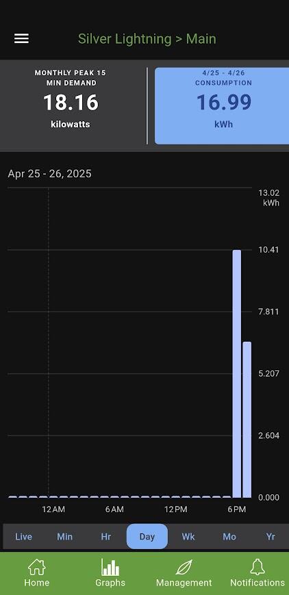

Emporia confirms the lower rating as well, 10.2 KW to battery is ~92% of 11.1 KW grid energy due to conversion losses.
Ford F-150 Lightning FCSP Software Version 2.112.125:3.15:3.15:3.15:3.15 1745705695141-qm
Ford F-150 Lightning FCSP Software Version 2.112.125:3.15:3.15:3.15:3.15 1745705714439-b0
I will stop the session at 80% programmed stop, then unplug, collect statistics.
Update the rate to 64 amps plug in and see if that adjustment sticks.

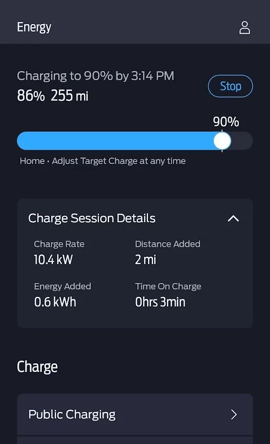

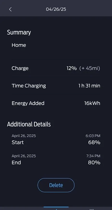

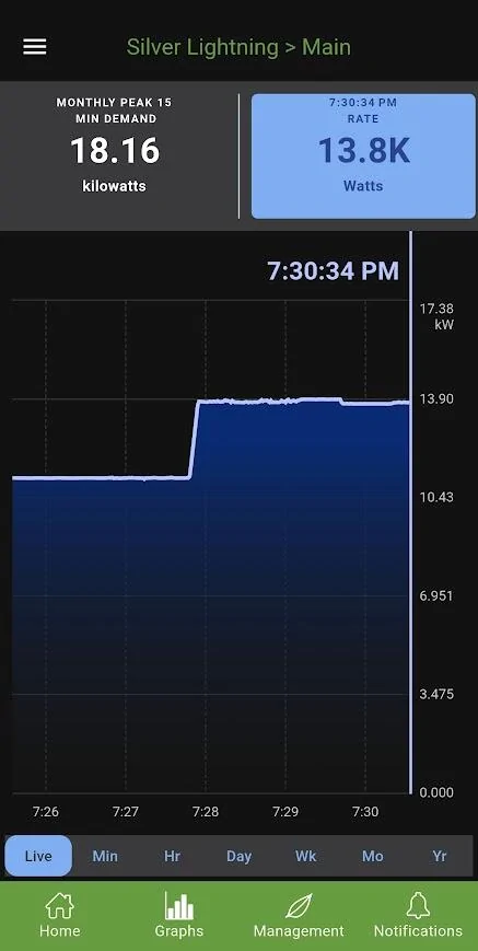

I decided to try an "on the fly" rate adjustment while the session was nearing the 80% shut off point, I bumped the rate from 48A to 64A, the FCSP responded appropriately, though the measured values continued to be slightly less than the desired value, note this is consistent with the overall performance of my unit, ie., I've [NEVER] seen a perfect 80 amps or 19.2 KW output.
End of session to 80% a rise of ~12% from 68%: Interestingly the FCSP log was slightly higher than Emporia and as expected these two were higher than Fordpass which shows you net energy to the battery.

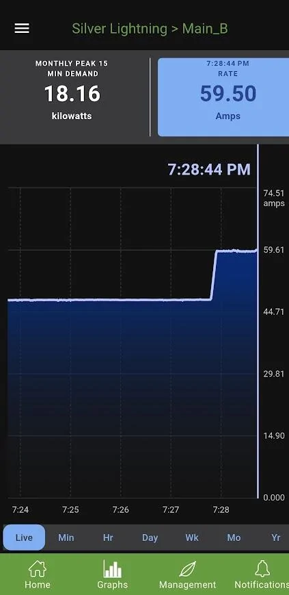

The Transitions from 48 to 64 amps, the change held up for the remaining duration.
Ford F-150 Lightning FCSP Software Version 2.112.125:3.15:3.15:3.15:3.15 1745711816676-wv
Ford F-150 Lightning FCSP Software Version 2.112.125:3.15:3.15:3.15:3.15 1745711835629-ky

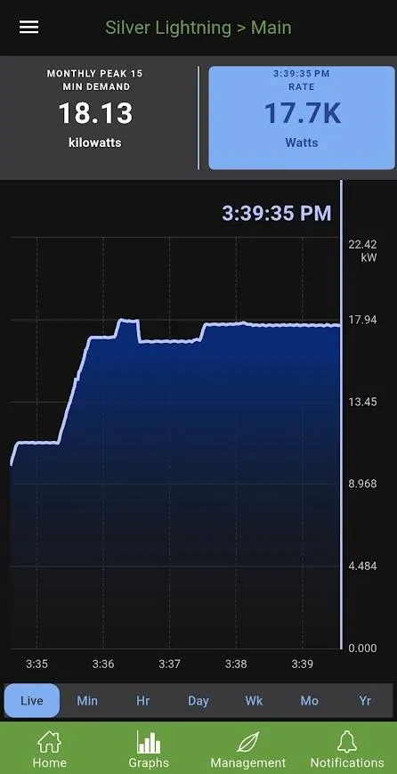

Bumping from 11.1 to 13.9 Kilowatts:
Ford F-150 Lightning FCSP Software Version 2.112.125:3.15:3.15:3.15:3.15 1745711883247-tg
Ford F-150 Lightning FCSP Software Version 2.112.125:3.15:3.15:3.15:3.15 1745711937963-bx
215
15,789
17,704

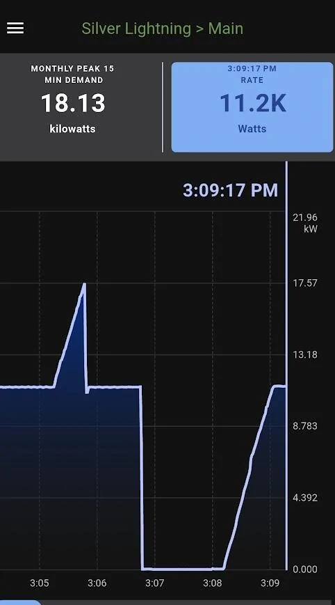

The bump is the FCSP running briefly at 80 amp setting then rolling back to a slightly slower pace.
Then I unplugged the CCS1/J1772 connection, powered off the FCSP for a couple minutes, restarted it, waited a couple minutes, then plugged in again, now she's pushing near the normal value at 17.8 KW, note my monthly peak of 18.16 KW.
