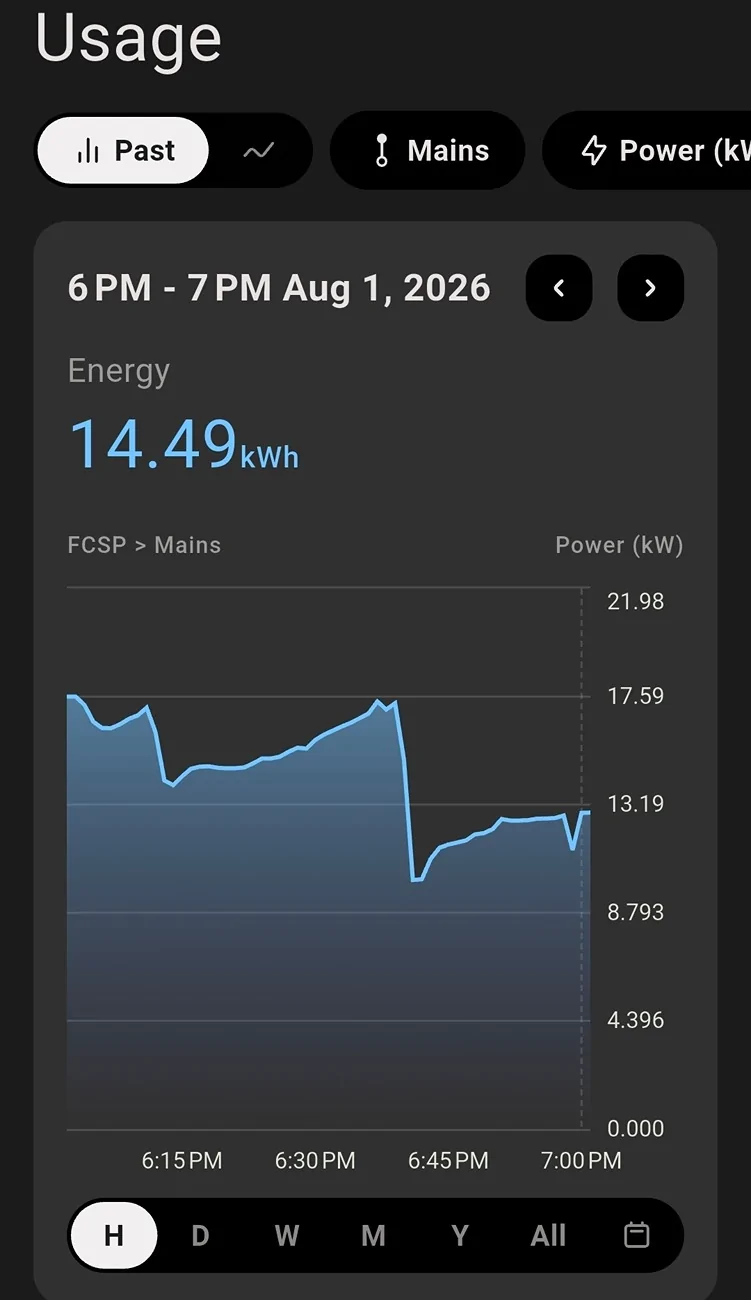

The only thing I noticed is my charging rate fluctuation. It starts at 17.4kw since i'm set up for 80A. But then another hour or so later the rate is down to 13kw and stays there probably for a little while like 1hour or 2 and then at some point goes back to 17.4kw. Very unusual. Before that my charging rate was a constant 17.4kw since day 1.

Could the fluctuation be related to the environmental temperature your truck or FCSP is experiencing? (which might have changed over time and with seasons, etc.)

Mine starts slow but within a few seconds hits the 10.4kW power level (about 43A).
With 80A, it could be a heat issue throttling the power, either the FCSP or the truck doing it to keep the HVB and AC-DC converter happy.
17.4kW is a loss of about 9% assuming 240V x 72.5A (72.5A / 80A = 90.6%).
At higher amps, resistance (causing heat and lost power) becomes more of an issue because
Power = I x I x R, i.e., it is proportional to the square of the current, hence high voltage transmission lines reduce waster power.
The heat is sensed in our EVSEs and trucks and kept down by lowering the current and/or increasing the cooling by the truck of the battery and AC-DC converter.
I like a lower current setting to minimize heat losses and to give the 12v battery a longer charging time - seems the 12v battery gets charged during L2 charging : energy = volts x amps x time.

Could be the weather as it has been very warm these past few days but not that different from last year. I don't remember noticing that fluctuation last summer.

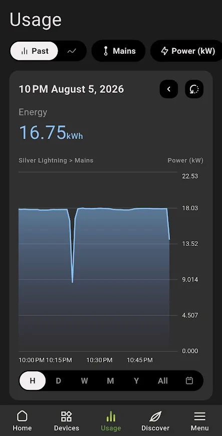

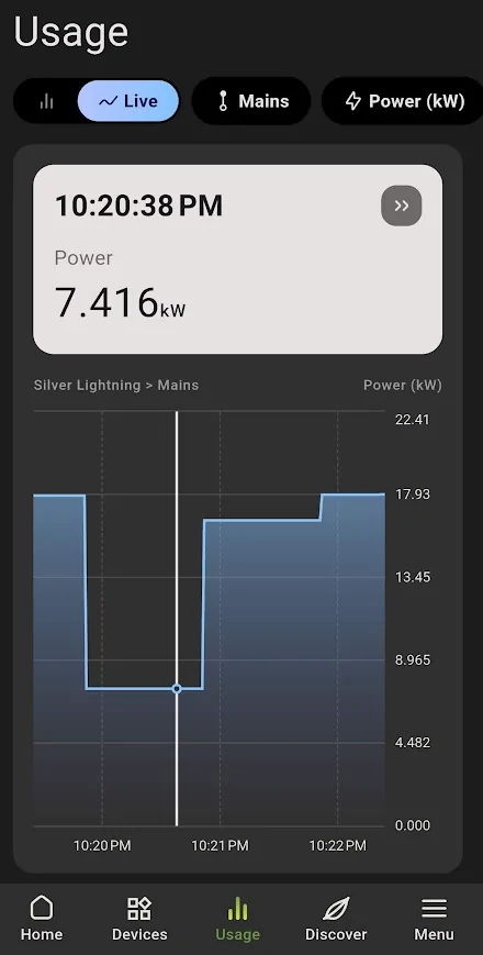

I'm still seeing a brief dip ~ an hour into a charging session, not as long as your experience.

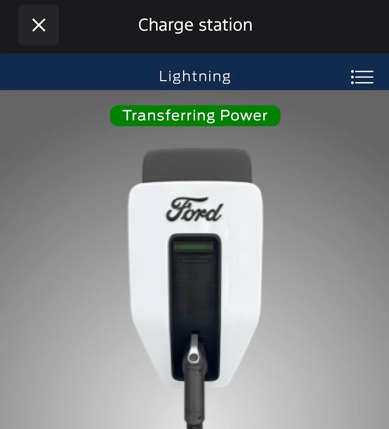

After the session was done, I unplugged waited 60 seconds then plugged in again to leave it over night and complete a departure time event while on plug for Thursday.
When I went in to look at the previous session stat's this is what the FCSP status was.... I DO NOT have a HIS system, so it's odd to see such a status! Later I decided to unplug, never got any FCSP charging statistics for this session, though it might be delayed and I'll see them the day after, I'll report back in the morning.

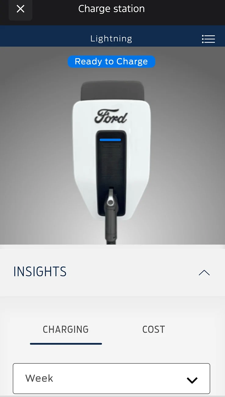

My last charge session Aug 5, 2026, was not logged by the FCSP, can't get the 'Insights' numbers for that session. The session shows up in the Ford app.
At least it still works to charge the truck.
My charge session from the 5th is in my Insights, but not from today, the 6th, when I unplugged this morning.

No insights data from yesterday's charging activity, the database is likely frozen, maybe a reboot is needed at the mothership.
