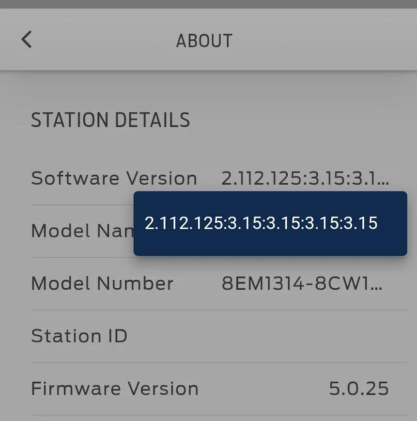

On Tuesday I noticed the white station reset light on my FCSP. This morning, I checked the software on the EVSE. The software version was still 2.112.125:3.15:3.15:3.15 as noted on 3/17/25, but the firmware version was now 5.0.25.
Steve
I just checked my Firmware Version, it has also moved up to 5.0.25 since the software version update a while ago.

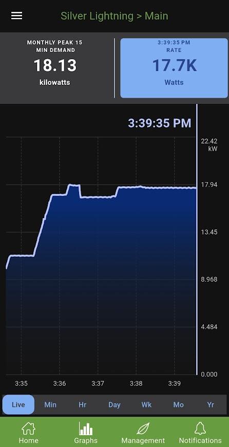

I adjusted the charging rate to 48 amps prior to plugging the truck into the FCSP.
Then plugged in, the rate of charge leveled out at 11.3 KW, I let this run for a while, the Fordpass app showed it's DC KW rate going into the battery as 10.4 KW ie. 92% of the AC rate, this is normal.
Ford F-150 Lightning FCSP Software Version 2.112.125:3.15:3.15:3.15:3.15 1743019007072-vz
Ford F-150 Lightning FCSP Software Version 2.112.125:3.15:3.15:3.15:3.15 1743019026595-x6
Ford F-150 Lightning FCSP Software Version 2.112.125:3.15:3.15:3.15:3.15 1743019156567-c2
Then tried adjusting the rate on the fly while the charging session was still in process, the rate briefly increased a little then ramped back to 11.3 KW, then I paused {stopped} the session to make the rate adjustment once again to 80 amps, then resumed charging, it climbed back to 11.2 KW, at this point I decided to stop the charging session until I finished my daily afternoon walk.
Ford F-150 Lightning FCSP Software Version 2.112.125:3.15:3.15:3.15:3.15 1743019288584-9n
Ford F-150 Lightning FCSP Software Version 2.112.125:3.15:3.15:3.15:3.15 1743019482585-vn
Unplugged, waited 30 seconds for charging statistics to roll up to the servers.
Confirmed the FCSP sub app rate of charge was set to 80 amps, then plugged is again.
This seemed to work the rate was much higher but not quite the peak I usually see, likely it's a hair under 80 amps, as the yellow derating lamp was illuminated.
I'll retest Thursday, I rebooted the FCSP and confirmed that my 80 AMP setting is showing on the app, it should go back to full rate in the next session, this has been the case in the past.

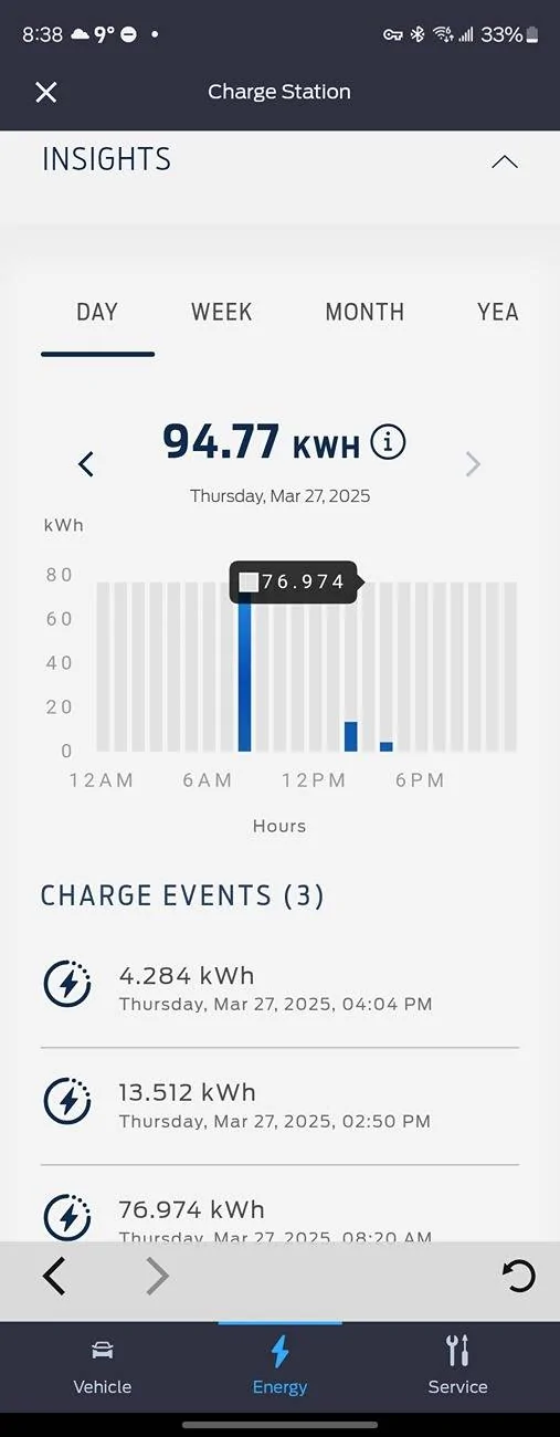

Yeah, that’s weird. I just tested and mine is not doing it either now???
I tested it prior to posting and I had it set about 45 A or 50 A I don’t remember exactly it was pulling about 9.6 KWH so I went into the charge station toggle and changed it to 80 amp and then it ramped up to like 17.6 kWh on the FordPass app but now it won’t do it-I thought they had fixed it, but maybe it was a glitch or an app error.

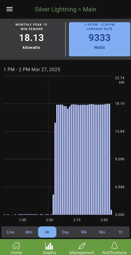

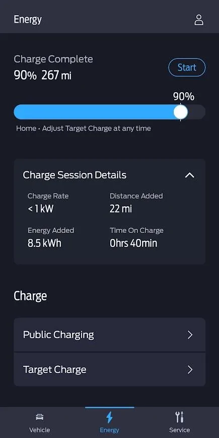

Confirmed today that the rate is back to default 80 amps, no yellow warning lamp on the FCSP.
Todays charge was 5%, the FP said 8.5KW at the end, the final charging report rounded that up to 9KW, Emporia shows 9.333KW and the FCSP shows 9.346KW.
I would recommend that if you're going make adjustments based on usage and recovery to be ready for the next drive and stay within any TOU requirements, that you calculate a rate that fits your needs and set the value before plugging the truck into the FCSP, the change should work.

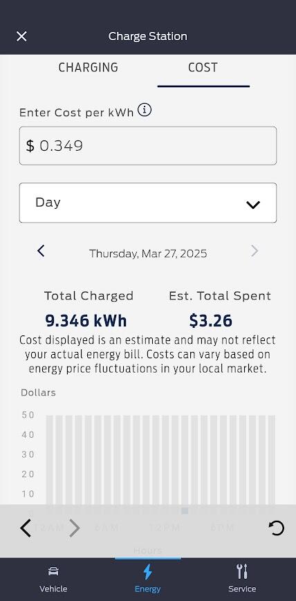

How do you get to the cost to show up? Mine doesn't have that.
Ford F-150 Lightning FCSP Software Version 2.112.125:3.15:3.15:3.15:3.15 Screenshot_20250327_203823_FordPass
211
15,506
17,284
What version of Fordpass and platform are you on ?
I'm on Android version 5.15.0 of Fordpass.
The format you show seems outdated.
