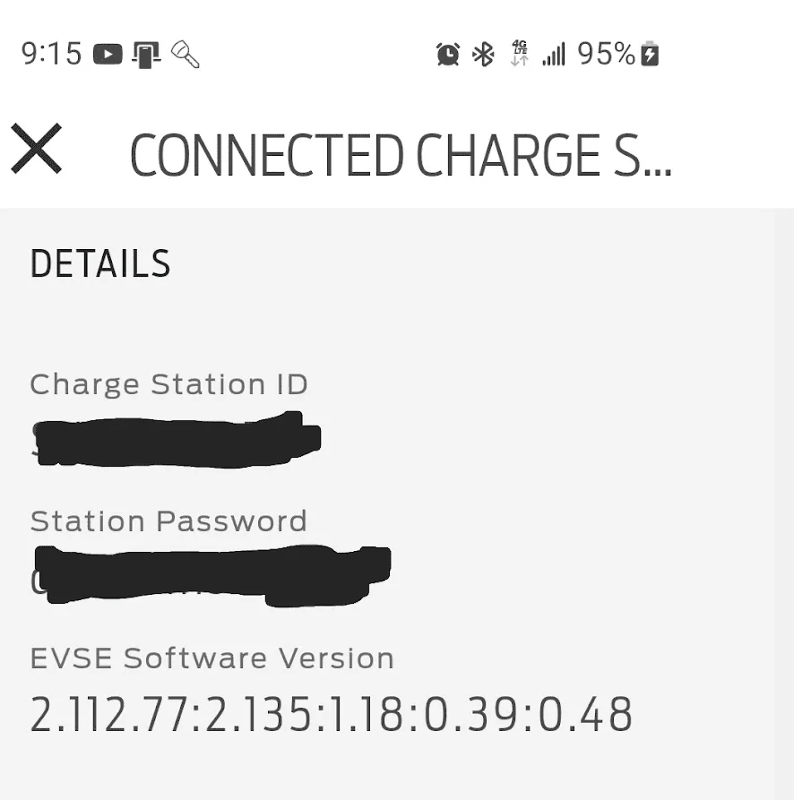

I looked at my FCSP via the configuration utility, appears the new update has already posted sometime today.

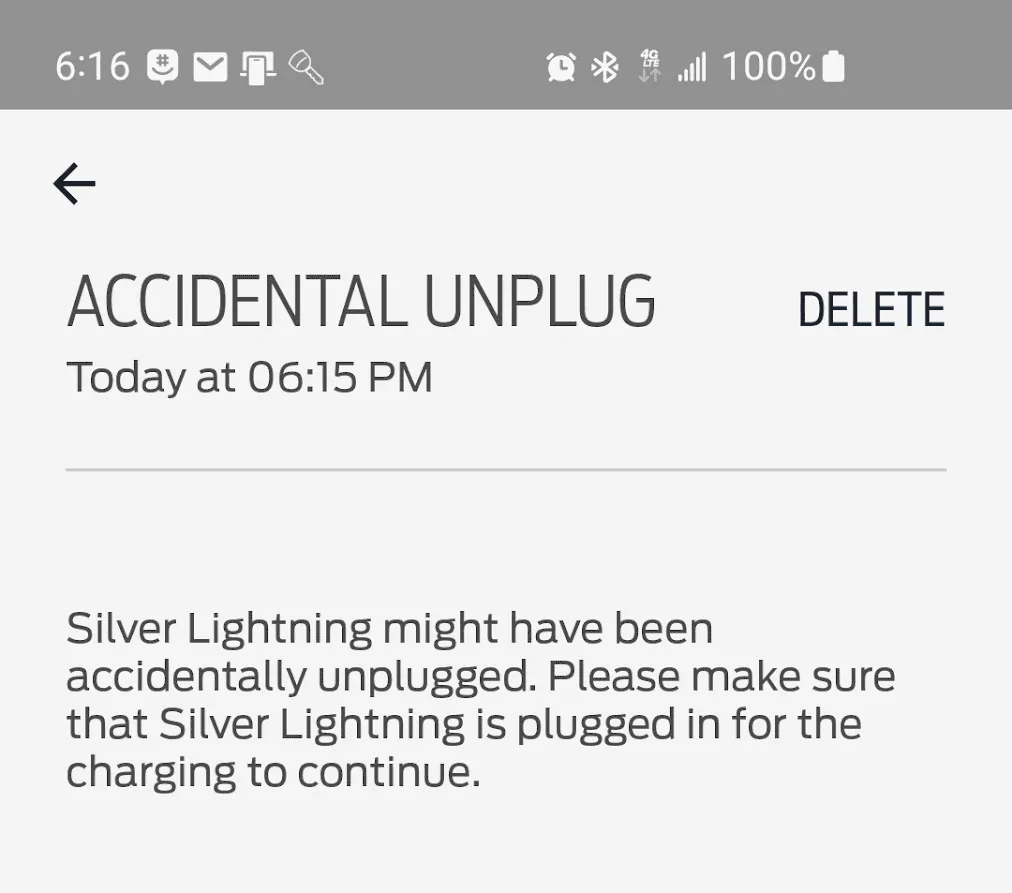

Funny thing, I got an alert from Fordpass telling me my charger might have inadvertently been unplugged from the truck, when in reality it's been unplugged all day since 8:05 AM breakfast run. I suspect the 6:15 PM alert was the FCSP getting it's update posted maybe it lost connection to the mothership??

My Fordpass is still showing what yours is showing, but possibly a restart will cause it to report it's new code base to the mothership, or on completion of the next charge cycle.

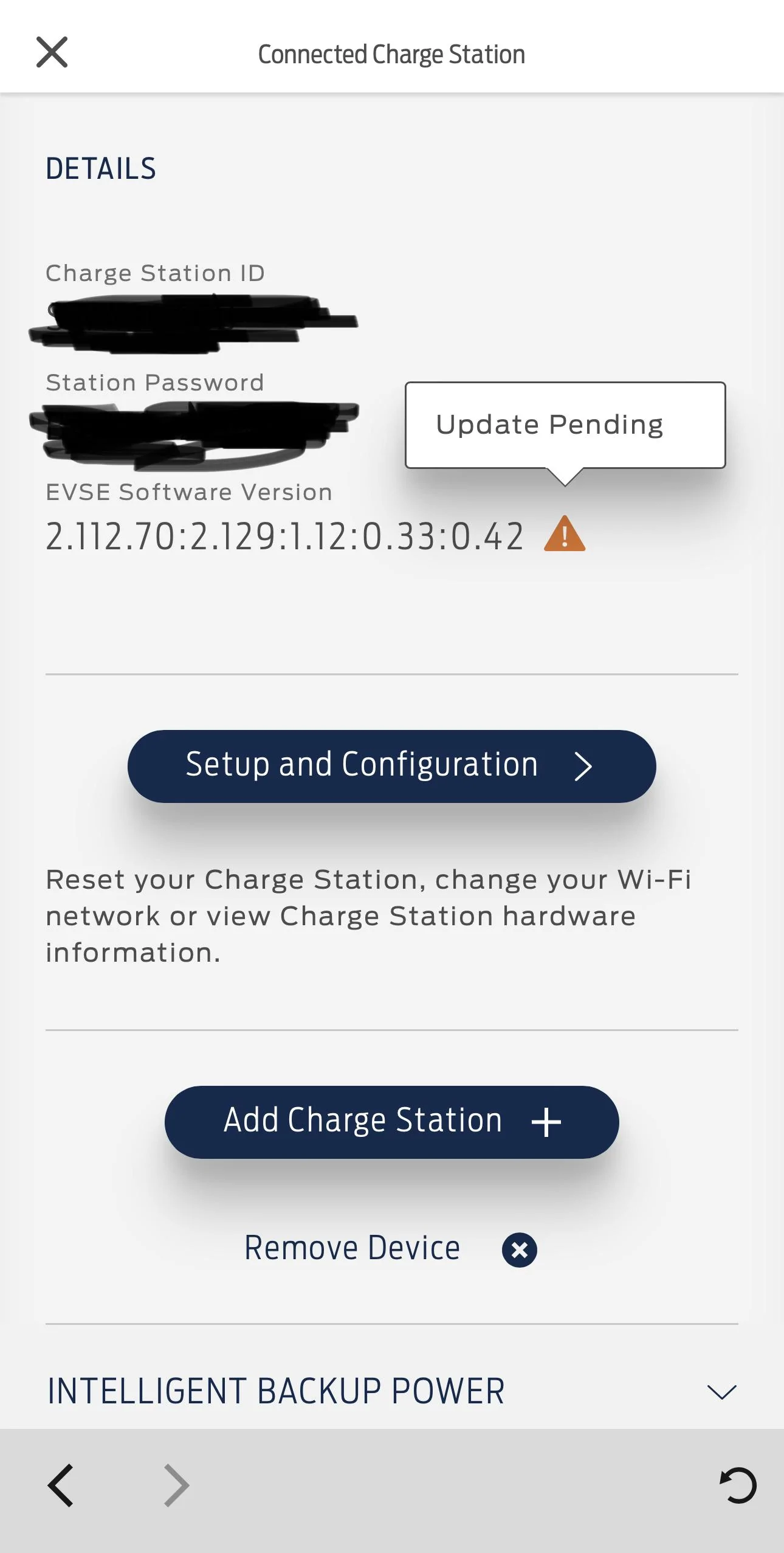

Just looked at my app again and it looks like there is an update pending for the FCSP. I am assuming there is no way to force the update right now.
I think the only thing you can do is leave your truck unplugged for the night & see if it updates. The Ford Rep said it’d try again if it failed.
They told me they would push the update to mine. Not sure how that’s possible though until I get communication back to it. Ford said that’d get back with me in a couple of days if I haven't heard anything sooner.

Maybe I gave up to quick but I tried it probably 10 times holding it for up to 30 secs or longer. I'll see what Siemens has to say. They didn't even mention the reset button. They had me do the same as the Ford rep, cycle the power & disconnect my router. The sequence they used was
1. Power off the FCSP
2. Power off the router for 15 min.
3. Turn back on the FCSP
4. Turn back on the router.
This is the first problem I've had with mine. It's still charging fine. I'm unable to down rate the amps & unable to see any charging activity in the Insights section in Ford Pass. That's my only issues, plus now not able to update the charger.

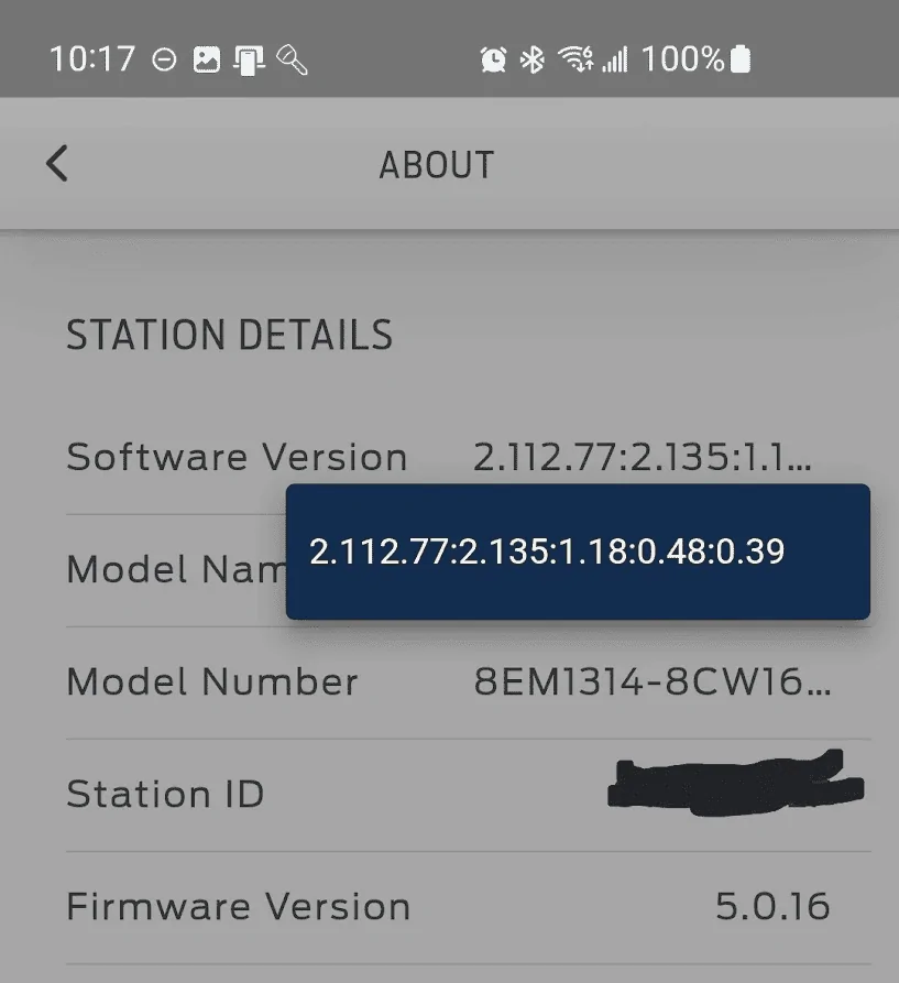

Did the shutdown and restart, took about 15 minutes for it to acquire the network connection, now Fordpass reports the same configuration as the EVSE was showing last night.
