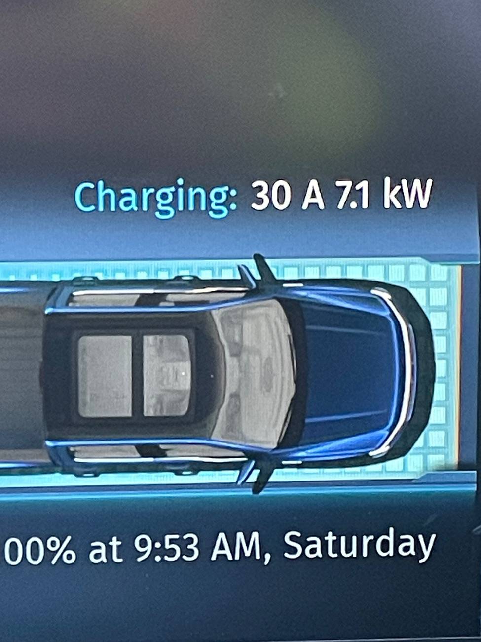

Trucks in driveway so decided to go play. So new toy the 23s donโ€™t have, got in Flash it shows pulling 2.3kw on dash and I can hear a low level hum - assume thatโ€™s just keeping battery warm.
Started truck (still plugged in) and it shows 30 amp 7.0 kw charging - being itโ€™s on mobile charger at moment that should not be possible. Either itโ€™s going to melt or there is hvb power being used.
Also no fans running but can hear the pump, and yes there is cabin heat. Sat for a bit and now sounds like a race car under truck which revs up and down can feel through floor boards.
No departure or cabin heating set, just plugged into level2 mobile cord.
That sound is the circulator pump moving coolant from the PTC to the battery pack, it happens on the call of the BMS when the pack temperature drops below set point and you're plugged in, the EVSE will only supply what it's capable of sending, FMC on 120v would be limited and any excess is coming from the HVB for the short period needed to warm the pack, once it's warm enough the high draw will tapper back and the battery would be slowly replenished of what it lost during the temp boost phase.

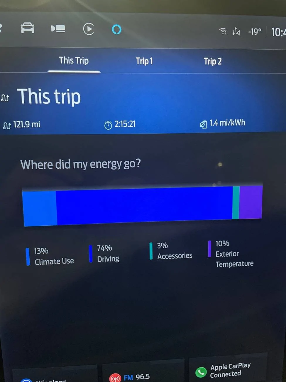

Bit of an update with a few more miles on Flash, did my normal 185 mile run tonight with it and came up short - limped to 1st DC charger in range (50kw) with 4% /9 miles range - about 15 miles short of home. The last 60 miles I had 40% left so figured I was golden and skipped Tesla chargers - only made it 45 of the 60.
Truck at 100% and Full Departure set, optimum except temp and some wind at end.
Iโ€™d like to say my 23 Lariat with similar preconditioning would have made it or done the same. Really no noticeable difference at
One noteable item the Flash has X-Ice winters vs Lariat is still on oem Grabbers. They may well have cost me the 5% to get home.
