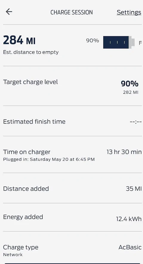

This was a late May charging event 5/20, consumed 14KWH of total energy and the FP charging pane (while still plugged in but charging stopped) shows 12.4 KWH added to the battery.

Emporia Vue 2 log shows the truck consumed 14 KWH of energy during this session and overnight as needed until I unplugged, battery warming & cooling was not likely to happen given the temp's noted below. By these numbers there was about 11.4% in AC->DC conversion losses.

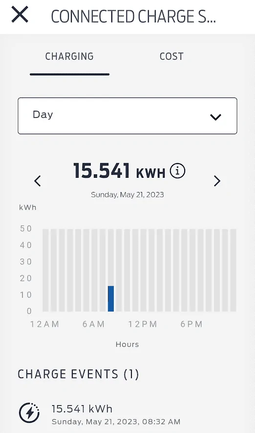

The Connect Charge Station function on the Fordpass app shows 15.541 KWH
I'm puzzled why this shows much more, most of the time it and Emporia track very closely!
(Log posts the following Sunday after unplugging)

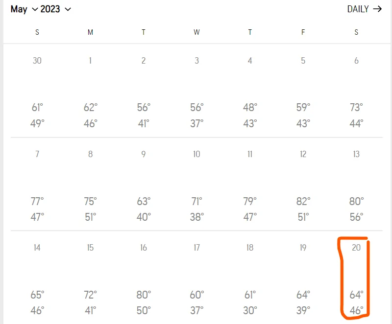

Likely the cooling system had minimal impact in late May as temperatures was reasonable in the evening.
