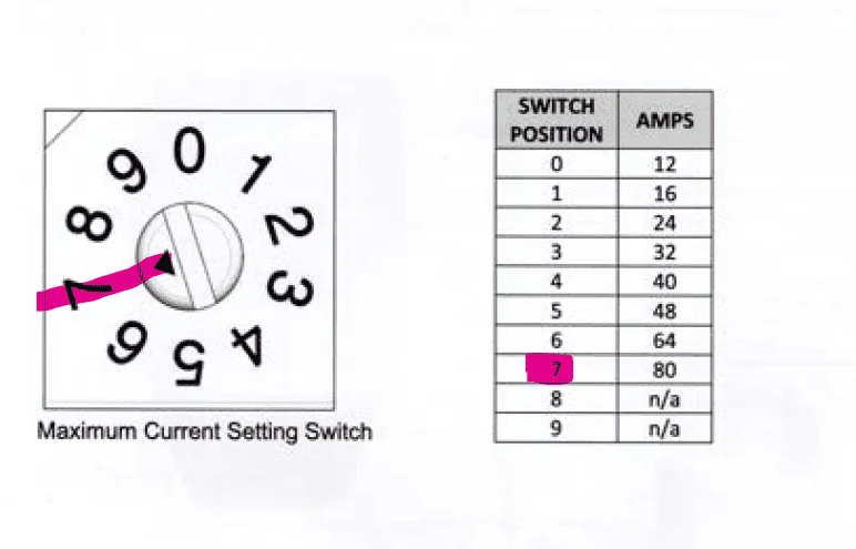

Do you think I'll be able to adjust back to 80A after the update?
Yes, unplug from the truck, switch breaker off feeding the FCSP.
Remove the cover, remove the screws.
Change the switch on the circuit board to 7
Reinstall the covers & Screws, turn on the breaker, test the unit.

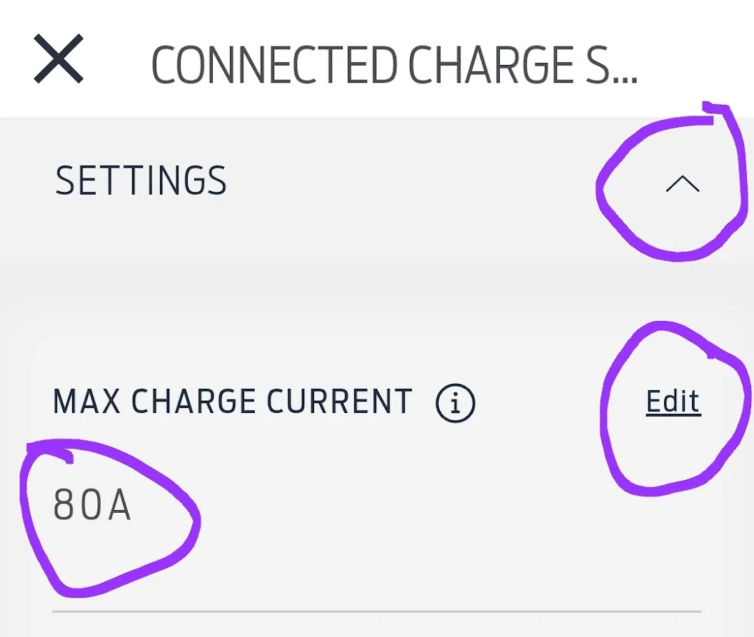

If it continues to be an issue in extreme outdoor heat, use the Connected Charge Station tile on FORDPASS to dial down the rate of charge as needed to minimize the interruptions.

So they dialed the Charge Station Pro back to 64A (15.36kW) charging using the internal rotary switch, and set up a new 30A circuit for a ChargePoint Home Flex at 24A (5.76kW). This is enough to recharge her typical daily commute in under 3 hours, so well within our 8-hour charging window.
As an additional safety measure, I used FordPass to reduce the Charge Station Pro to 13.44kW (56A) of charging power, so that even if both vehicles are charging at the same time, the total charger current draw remains 80A. Since 80A had been working well for over 10 months, I expect that there won't be any problems going forward. This is enough to recharge my typical daily drive in just over 3 hours, so we're both good.

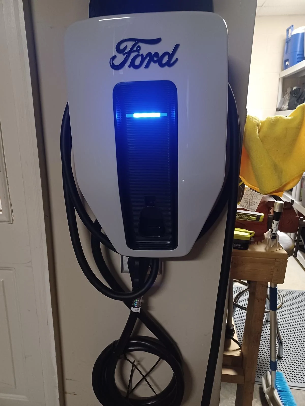

My setup was set to 40 AMP, by RV cord and install and just plug into my 14-50 outlet I had installed for my 2021 Mach-e originally. The extra $7k for a new line and subpanel wasn't worth the speed in my use case. The cord was less then $40 too.
Don't trust the software limit. Mine resets to max power periodically. Then it's a pain trying to get the software limit changed back.
Yes.
The CSP internal switch is set to 64A charging current, and the other charger is configured to 24A, for a total of 88A charging current (using 110A of our service capacity). This is as much as the electrician would allow.
The software reduction to 80A is just for my comfort level. If it resets, it isn't a safety hazard.
