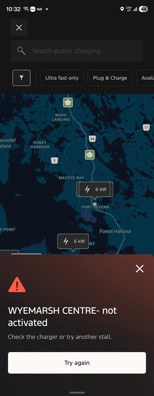

I basically rely on public charging to get about, mostly through ChargePoint. However, trying to activate literally any ChargePoint-based chargers through the Ford App fails. Is anyone else having this issue?
This doesn't happen with any other charger, and even though I'm physically there and can activate it through other apps, it only fails to initiate through the Ford App.
Ford F-150 Lightning Ford App: Charger Not Activated? Screenshot_20260711_103247_Ford

The reason you can't find that charger is because it's NOT NETWORKED. ChargePoint app shows them as "Status Unknown".
This issue is with the owners of the chargers, NOT Ford app.

...Not true.
It's chargers I've constantly used for the past three years. Unless all ChargePoint chargers decided NOT to work through Ford. In which case, yes, it's a Ford issue.
I guess I'll just contact ChargePoint support as well.

I was looking at the location you show right above Port Severn. Those locations show as Unknown, they're in Coldwater. Apparently not those nor the ones SW of them, shown also in the picture, are what you are referring to.
Wye Marsh Wildlife Centre in Midland has 2 chargers per ChargePoint. PlugShare shows the last check-in in Sept 2025. ChargePoint shows last used 3 days ago. Ford app shows them, as FREE.
If they're not free, then the reason they're likely failing to activate is because the Ford app believes they are free, maybe?

On a few occasions I have used a ChargePoint L2 station near home - mostly for testing. It's hardware that requires activation before you can even unplug the cable from the pedestal. I have used both the ChargePoint app and the Ford app to activate a session. Never had any trouble with either. Last time I did that was via the Ford app three weeks ago.

I have had success using the Ford app to activate ChargePoint both L2 and DCFC but not recently and not at that specific location of course. ChargePoint has a WIDE variety of installations so it's hard to make generalizations about lol.
