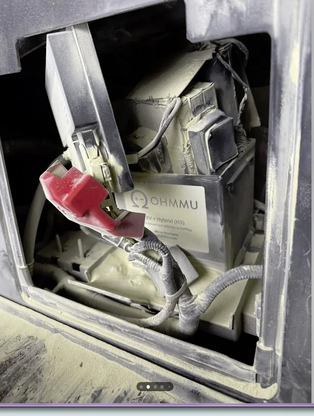

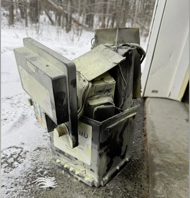

My two cents - I replaced the lead acid battery with a 12v lithium battery that has a built in heater and Bluetooth. Did that within the first 6 months of owning the truck (23 XLT).
The battery was a few hundred bucks, but it is better than the lead acid one. If you check online, Ohnmu offers a lithium and also a sodium battery specifically for the Lightning (I think it works ina Mach E as well.
I would also invest in a diagnostic scanner. Doesn’t have to be a Mongoose (I do have one), yet I have had a couple of occasions where the dealer was like - meh, don’t know what happened, it’s all good. I printed out the trouble codes and told them it’s obviously not good. The more ammunition you have in pushing for a repair, especially under warranty, the better.

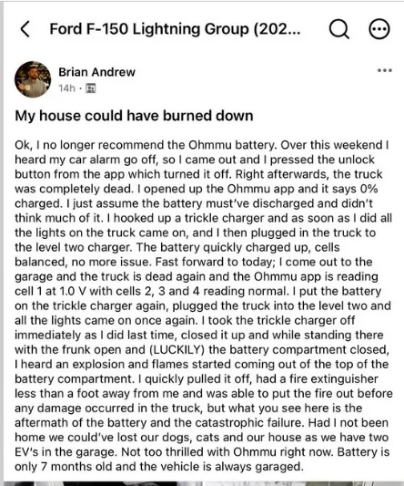

There have been reports of those ohmmu batteries catching fire and or just drop a cell and shut down completely. Sounds like you got one of the good ones.
Yes, that fire gave me pause...

A lot of safety built-in to the Lightning, but a few wrinkles, one of which may have led to the Ohmmu fire: the battery charging current can be rather high when the battery is significantly discharged, based on observations and measurements made by some owners.
Although the Ohmmu claims to be plug-n-play compatible and has its own internal BMS, something went wrong in the case of the fire that Ohmmu did not anticipate.
The Lightning does seem to allow the 12v battery to get rather significantly discharged and does not effectively limit the charging current to no more than what a manufacturer of a 35Ah battery would consider safe and optimum, of no more that 10.5A.
