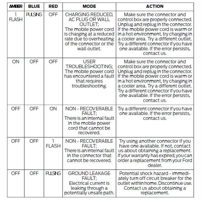

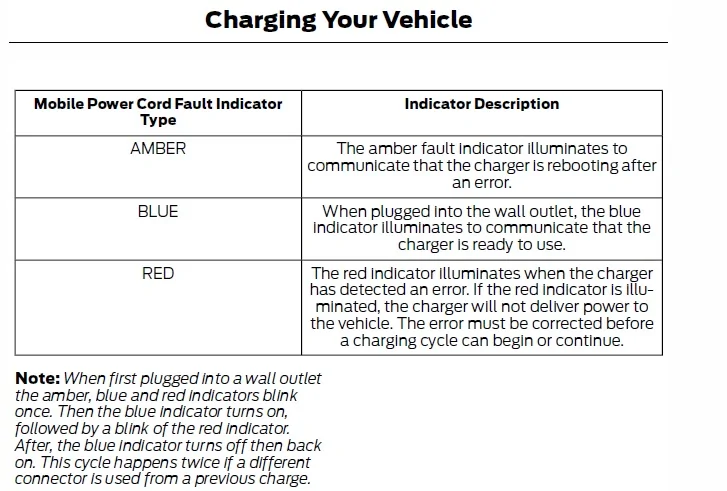

There have been a lot of issues with those FMPC (Ford Mobile Power Cord) EVSE's when used every day according to forum posts.
Get it replaced under warranty and then keep it handy for emergencies only.
This table will tell you what the error lights mean:
Ford F-150 Lightning Ford Mobile Charger Issues error codes 1
Ford F-150 Lightning Ford Mobile Charger Issues error codes 2
Ford F-150 Lightning Ford Mobile Charger Issues error codes 3
