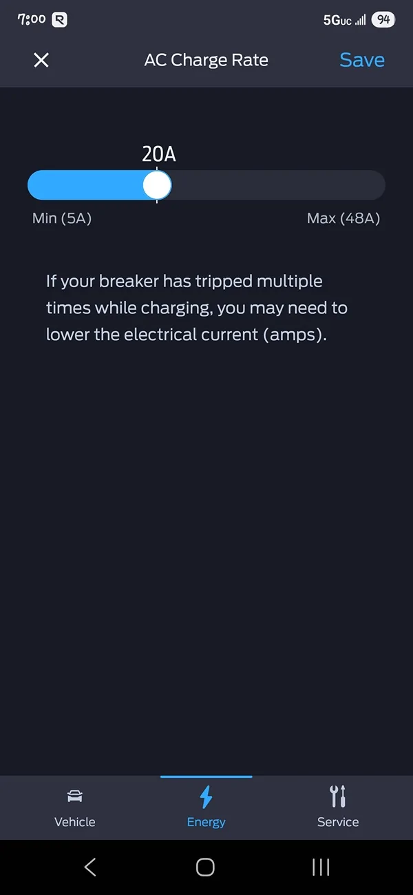

Perhaps one can just turn the charge rate down ehh?

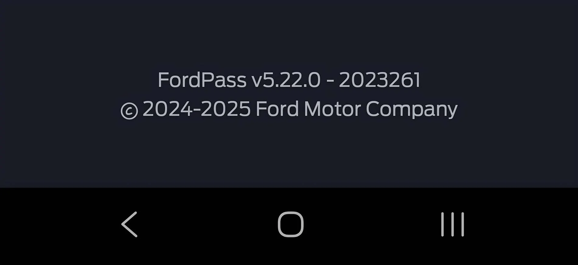

What is this screen shot of? Looks like FordPass, what version?
the FMC is not adjustable, though third party EVSE might be ..... but the FMC is not!
Looks to me like a screenshot from the FordPass app, the AC Charge rate setting. The vehicle can limit the charge rate, not dependent on the charger.
Yep that works for your 2025 Flash. However not every year of the Lightning has the ability to change the AC charge rate. So just didn’t want to assume.??
Yep Ford pass. Adjustable from 5a-48a.
Perhaps it's new for the 25 ym?
That's a nice enhancement for MY25, us older MY's can't do that on the same version of Fordpass!
Good call. Nice feature for the 25 model year (only). You can go up to 24A on a 30A circuit.

"Technically" the onboard charger in the truck is reducing the current flow on the MY25+ Lightnings.

Yes, you can use this to turn down your charger. It is a new feature on the 2025s so most folks here have never seen that screen.
