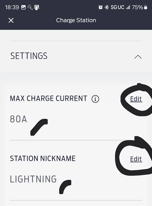

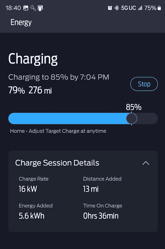

I'm testing and tweaking right now, I've noticed that we need to adjust the device name (add/delete a character in the name) to cause the amperage value to change, this is crazy but works.

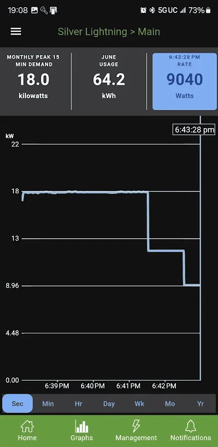

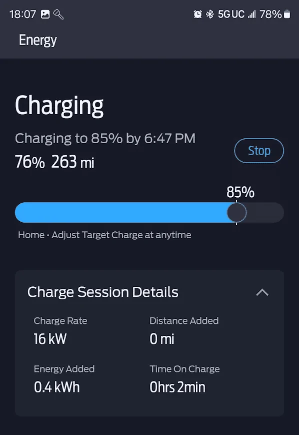

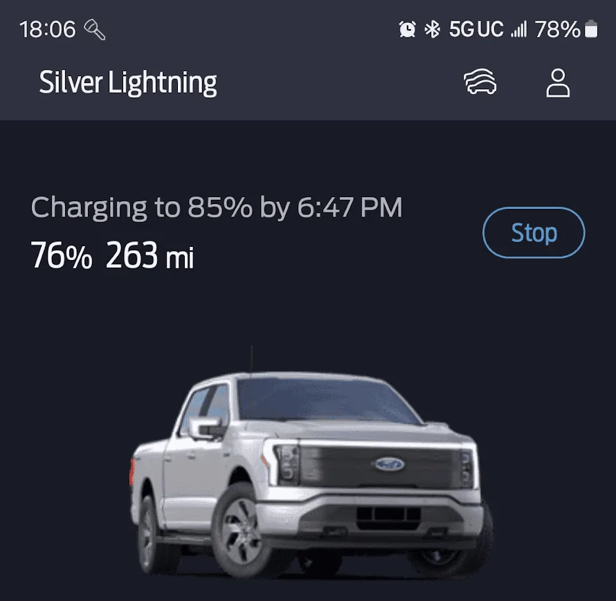

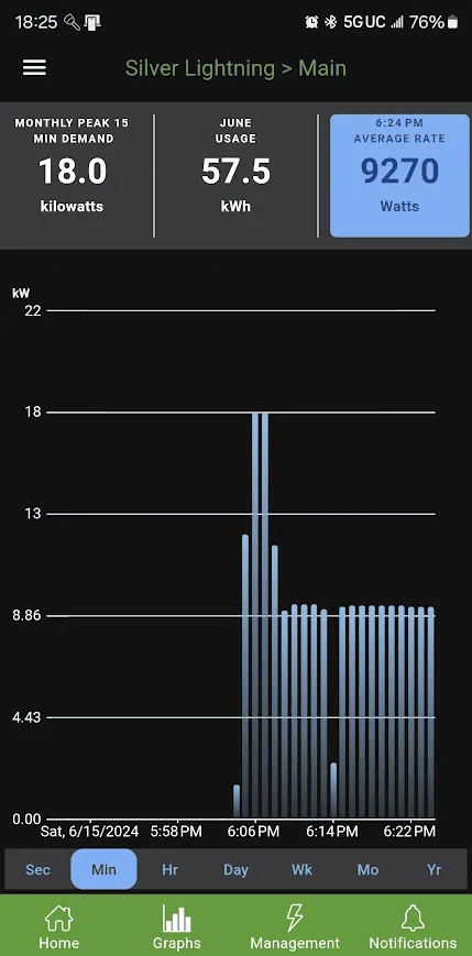

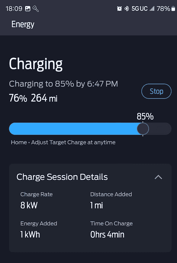

I started the session but noticed that the truck was still demanding 80 amps, at this pace the session was projected to end around 6:47 going from 75% to 85%

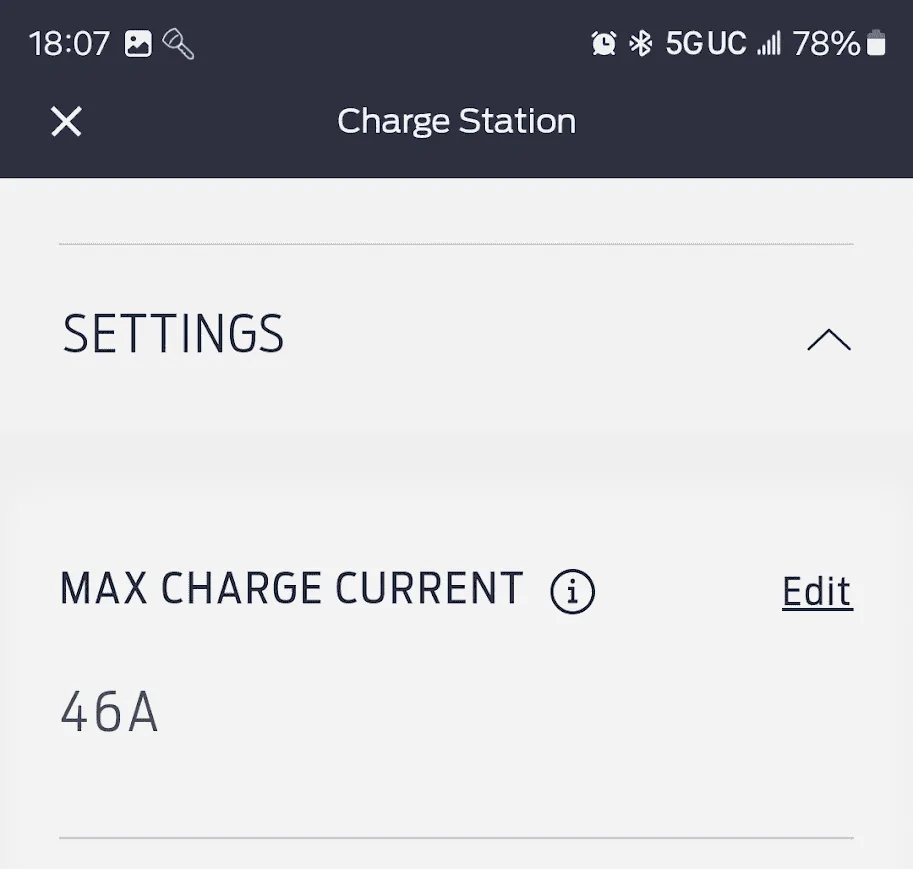

I looked at the value previously set a couple hours ago, still shows 46 amps

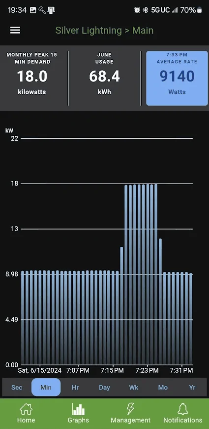

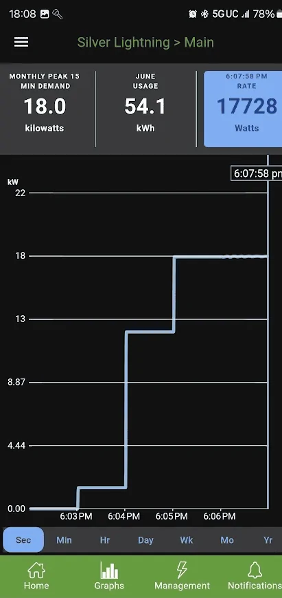

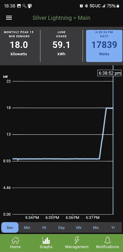

Emporia is reporting the high current flow, this chart is a by the second (initial ramp-up)

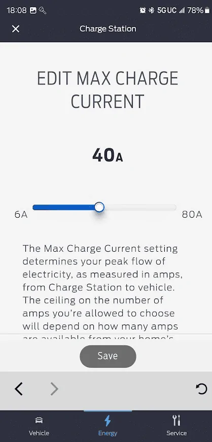

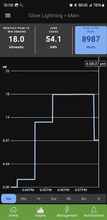

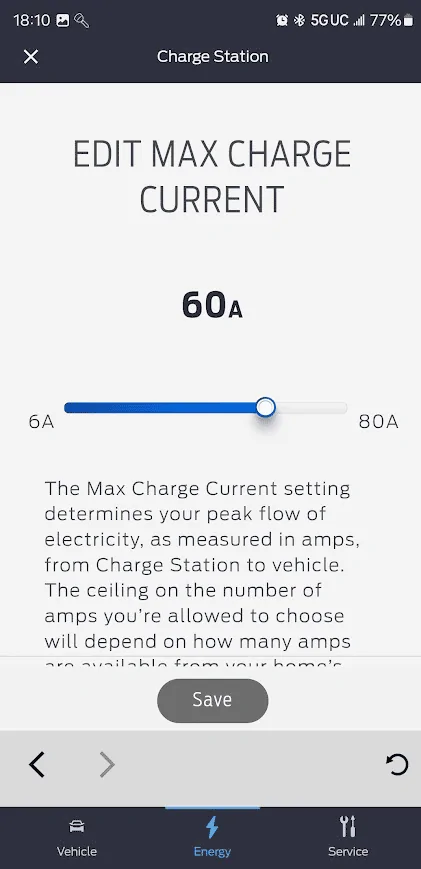

I tried lowering it from 46 to 40, it worked and I didn't have to touch the device name, FP confirms the reduced rate from 16KW to 8KW, is the change allowed in certain increments only??
Ford F-150 Lightning FordPass 5.0.2, Target Charge not taking 1718491818499-uq
Ford F-150 Lightning FordPass 5.0.2, Target Charge not taking 1718491842418-8o
Ford F-150 Lightning FordPass 5.0.2, Target Charge not taking 1718491904541-4j
Now I'm trying to increase the rate to 60 amps, no dice FP say's it changed, but Emporia and the active session display say otherwise, still pulling 40 amps.

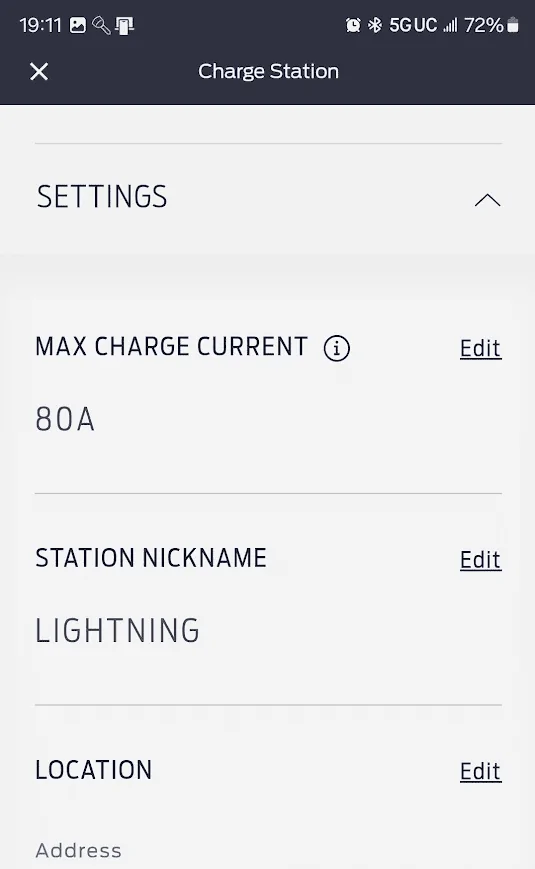

This time I also edit the amps to 80 and then the station nickname, this does the trick, storing the revision to the cloud, then flows to the trucks OBCC, active session monitor and Emporia verify revision has implemented.

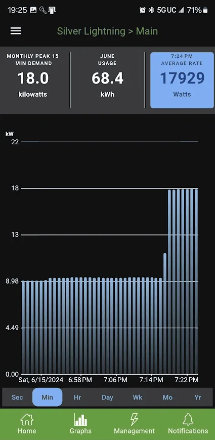

Opppps, scratch the assertion above, the upgrade to 80 amps only held for less than 3 minutes then it reverted to ~40 amps, I tried tinkering with the name and rates, no dice, still stuck at lower rate.

I tinkered with the station nickname and amps once again, this time I changed the name first then to 80 amps second, this appears to have caused the update to stick and so far it has not reverted to prior value of 40 amps.

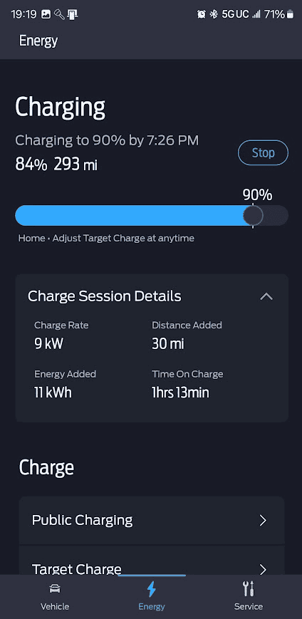

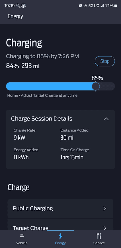

Adjusting the target SOC limit from 85% to 90%, the change did not reflect for about 30 seconds
But the projected ETA to complete charging session has not updated immediately
Ford F-150 Lightning FordPass 5.0.2, Target Charge not taking 1718494304386-a7
Ford F-150 Lightning FordPass 5.0.2, Target Charge not taking 1718494198735-w8
Ford F-150 Lightning FordPass 5.0.2, Target Charge not taking 1718494037188-ia

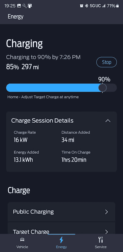

Now after a few more minutes [9] the amp draw has dropped again, but the SOC is still honored with a revised ETA now showing at 86% heading for 90%

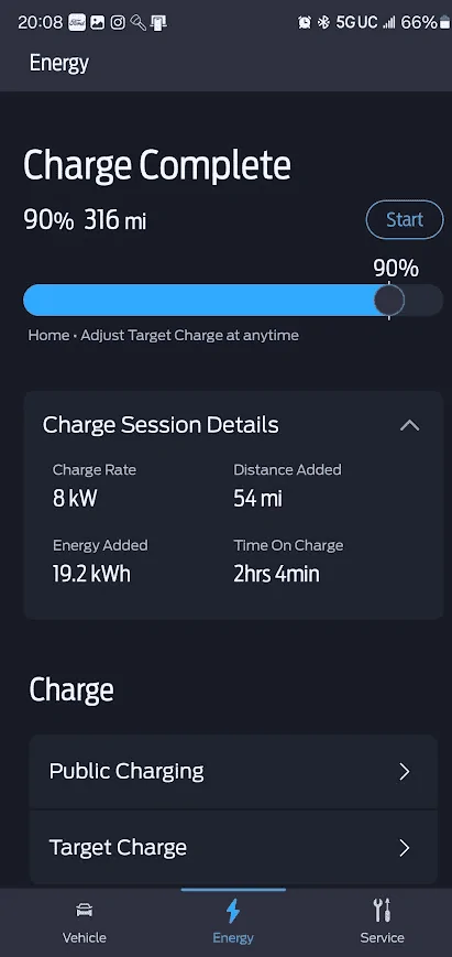

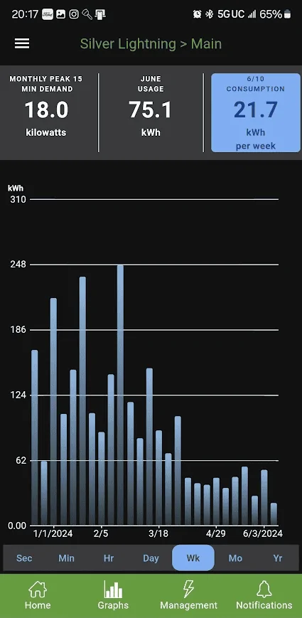

Session is complete at 8:08, and the revised SOC target held at 90% after I adjusted it from 85% via the Fordpass app (Android).

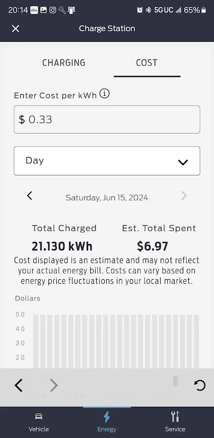

FP energy added is 19.2. kWh, while Emporia shows 21.7 kWh and the FCSP shows 21.13 kWh.
42 miles driven this week, mostly local roads once on the highway, generous AC usage,
16.6 Cents/mile and efficiency of 1.94 MPK [gross energy] 11.5% AC/DC conversion loss
The distance added value of 54 miles infers an optimistic 2.8 MPK
