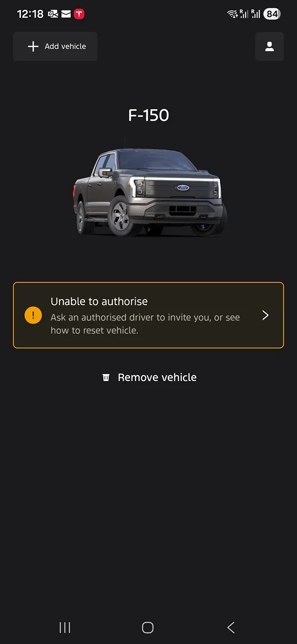

Hi everyone,
I’m posting this in case the previous owner of this F-150 Lightning is here on the forum.
The truck is a 2022 Ford F-150 Lightning Lariat in Carbonized Gray Metallic.
I’ve followed all the FordPass steps and the truck is online, but I still get the “Unable to authorise” message and I can’t connect the vehicle to my phone (see screenshot).
If anyone here previously owned an F-150 Lightning in this exact color and configuration, please check if this vehicle is still linked to your FordPass account.
For reference, the VIN ends with 15670.
If this is your vehicle, I’d really appreciate it if you could remove it from your FordPass app. Alternatively, feel free to contact me privately and we can confirm the full VIN so you can safely transfer/remove the vehicle and allow me to complete the setup on my phone.
Thank you in advance.

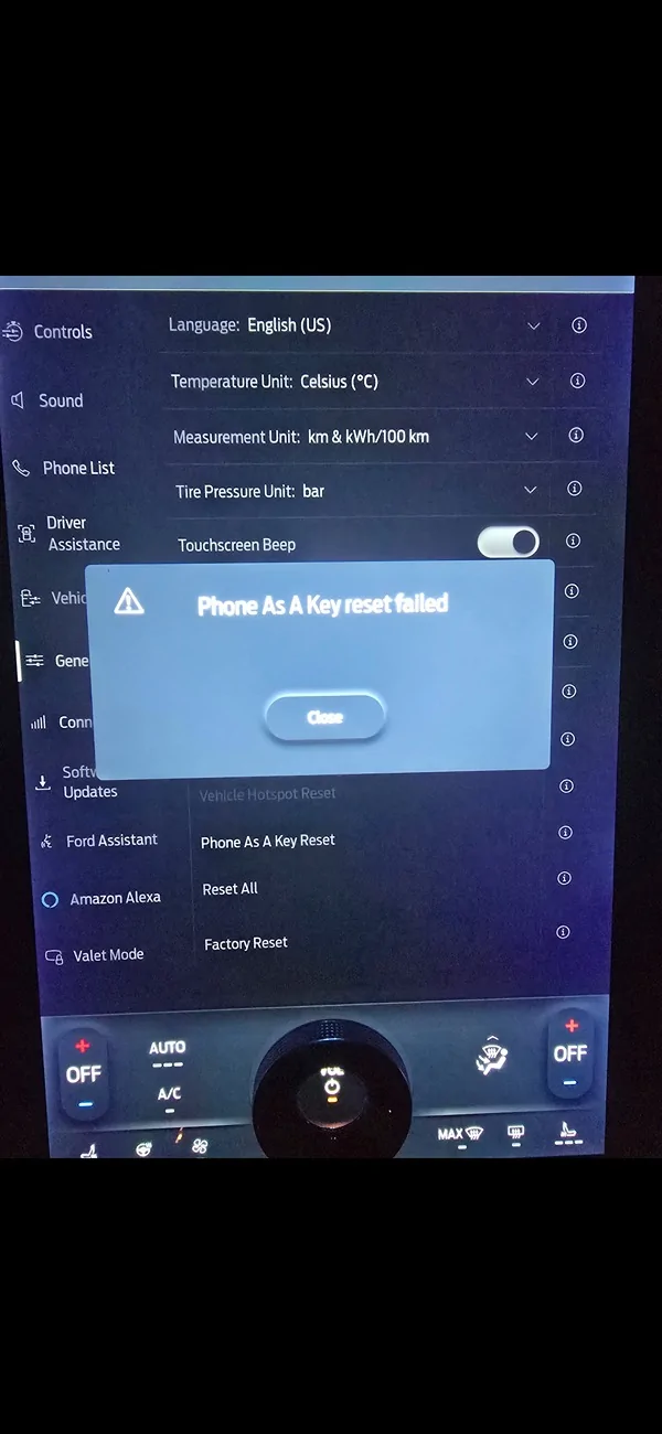

I have already done a full Factory Reset, probably dozens of times.
However, since the vehicle has changed continents (US → Europe), I suspect there may be a backend or regional lock on Ford’s side that isn’t cleared by a standard factory reset alone.
The truck is online, has LTE, and is receiving OTA updates, but FordPass authorization still fails with “Unable to authorise”. That’s why I believe this may be account- or region-related rather than a local vehicle reset issue.
