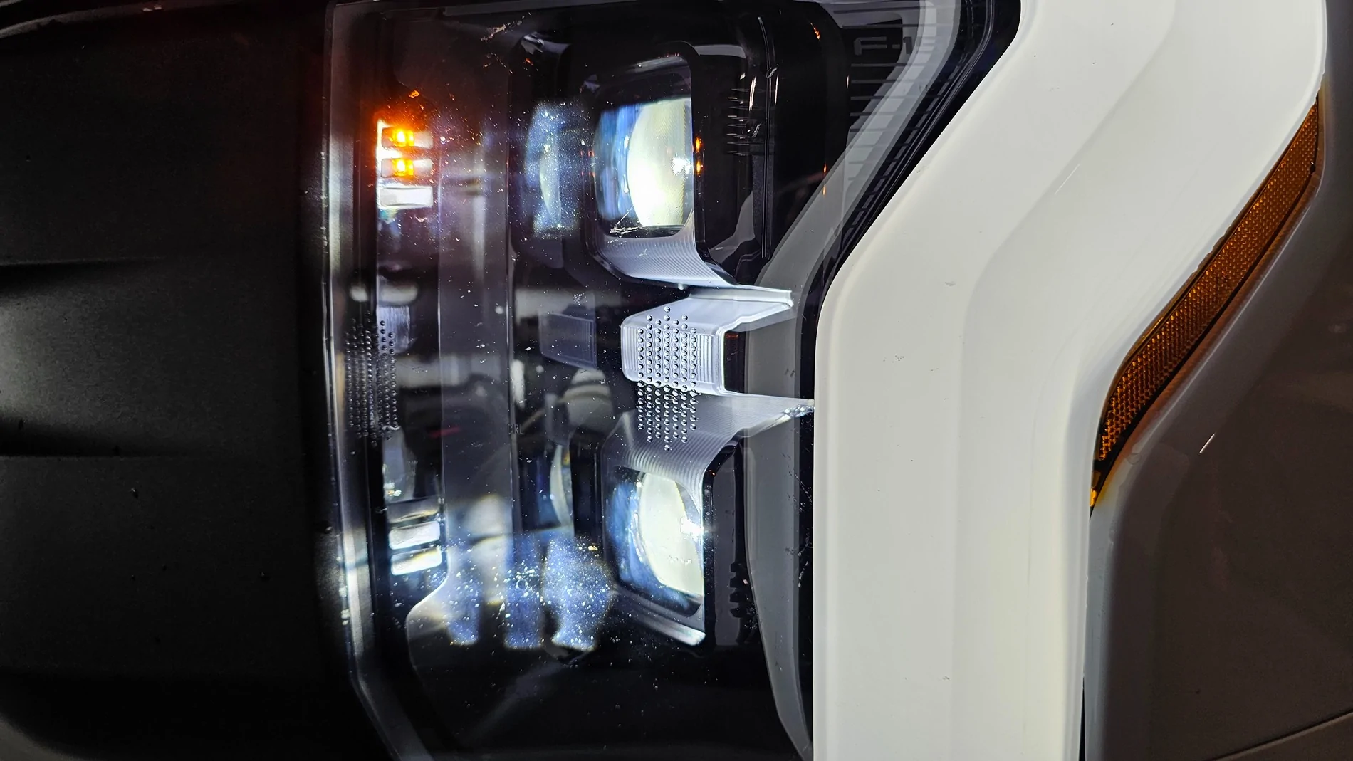

Mine stay on, as seen in the image below. I also believe this is shown on other trucks if you go to the drl post in the forscan thread.
Unfortunately the forscan changes affect these lights, but do not appear to work for everyone.

Confirmed on my truck as well. I wonder why they changed that from my other truck. On the 2013 the DTRL only come on when you shift to any gear position other than park.
