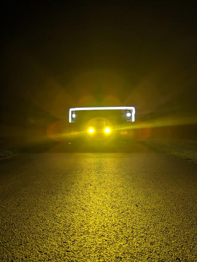

I'm looking at adding front fogs, but I'd love to use OEM wiring if possible.
I know the BCM has pinouts for front fogs (and actually rear, according to the factory manual) - but I'd love to know if the wiring already exists, to the bumper or not. I haven't taken the front off, so hoping someone already has - and knows :)

Definitely no wiring in the bumper. I just swapped my bumper harness to add adaptive cruise.
There’s the frunk harness that connects the bumper harness to the BCM as well. I highly doubt it has the wiring pinned out either but I’m not 100% certain on that, just very confident that it doesn’t since the harness is unique to Lightnings and no Lightnings have fogs.

That's what I thought. Guess I'll be running wires then ;)
The BCM does have the fuse and pinout for it, so hopefully...

Where would you physically mount the fog lights on the front of the Lightning. There's no OEM cutout, right? Or maybe I am just missing something.

I'm curious too, but let's be clear: the front fogs are for situations where glare-free already struggle.
I grew up in a place where front fogs were optional and rear fogs were mandatory. I had it drilled into me when and how to use them.
Up here in the coast range in the PNW, we get HEAVY thick fog at this time of year, and having lights down low and able to actually throw light to the sides of the road is important.
Several folks here have done front-mounting solutions, so I'm hoping to replicate that!

In traditional set ups, when high beams are engaged, fog lights usually turn off. With glare free, would they not also turn off if they were wired into the stock wiring system? If you made your own wiring circuit direct to the LVB, then they'd just stay on but not sure if they'd freak the system out since fog lights don't throw light as far as your low beams. I'm not an expert at all though so what I said might just be nonsense!

Wouldn't you want the fogs to turn off when you engage high beams? In fog/snow conditions (ie when fogs are needed), high beams will completely kill your visibility through reflection.

On the fords I've had, the factory fogs turned off with the high beams. But with the Prius and Subaru they are independent and I run with both on all the time as the high beams don't look down in front close up. Seems like most people run both around here and particularly the semi trucks. They sort of do the same thing as the glare free but so far I don't think my glare free are all that bright in the ditch and I wouldn't mind having additional fog lights.
As an aside, if you have every driven in a blinding blizzard then fog lights low to the ground is all that will get you around. I remember getting caught in a blizzard needing to drive 20 miles north into it with no fog lights. Drove 20 miles just crawling along with the wife holding a flashlight out the passenger window shining straight down at the ground which at least illuminated the blacktop and edge of the road. The flashlight works in the fog too so carry a good bright one.
Glare free headlights in a blizzard would still leave you in a blizzard or heavy fog as a sitting duck on the highway stalled or creeping along when some semi truck with fog lights comes high ballin up behind you.
The lower to the ground they are the better. Even some bolt mounted led lights drilled in below the bumper would be better than nothing. I would angle them towards the ditches as well.

No wiring baked in for the fogs at the bumper, the harnesses us base models used early on in the ACC retrofit included fog light connections though; but I'm sure they weren't terminated on the body harness side of things.
