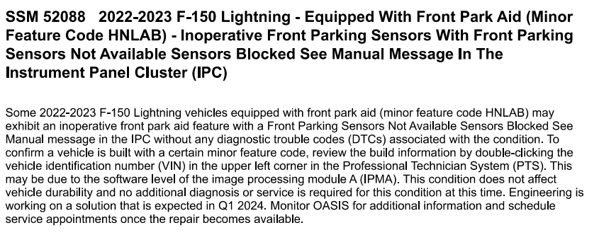

And I'll tell you why...the OASIS message the dealer service folks got said this was going to be fixed with an OTA update to the IPMA module in March.
It's March. The OTA hasn't been released yet...but the file itself is available for a tech to update with FDRS if they wanted to do that.
If somebody checks your VIN in FDRS right now, I'll guarantee you that you have an IPMA update pending.

They did this TSB to mine the other day when I had it in for the other two CSP campaigns. I had recently just started getting the same error. They said it would take care of it and I haven’t seen it since.

So I took the vehicle in and they tried to update per the SSM and still no good. Ford told the dealer to remove and replace the wiring inside the bumper area.
