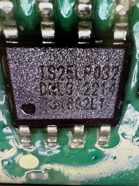

the first few bytes should tell you if it's write protected, I'll take a look when I get back home, don't know if this is the exact chip used but the datasheet is here
https://www.issi.com/WW/pdf/25LP-WP032D.pdf

Yes that is the chip:
Ford F-150 Lightning Hacking the Pedistrian Warning System Sounds IMG_9001

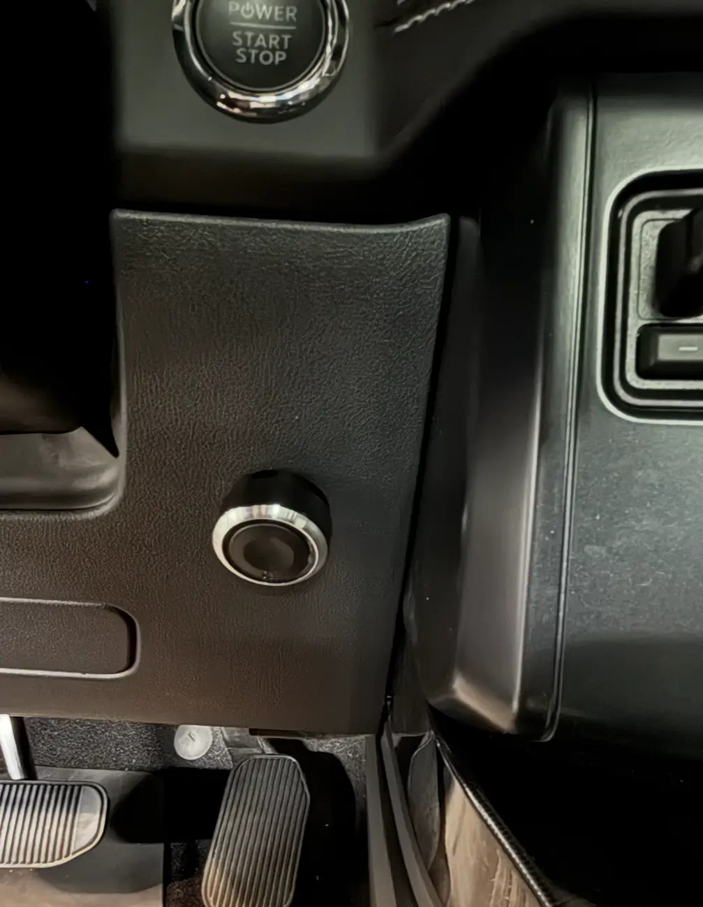

I wanted to thank you for the details in your post -- I used them and installed a switch with the megaOhm solution so I could toggle it on and off.
https://www.megaohmmotorsports.com/products/ford-external-speaker-bypass-kit?variant=43116965494872
Switch: Heavy Duty Rocker Toggle Switch 20A 125V SPDT 2 Position 3 Pin ON/ON Switch
https://www.amazon.ca/dp/B07R8TSFG1?ref_=ppx_hzsearch_conn_dt_b_fed_asin_title_1
Installed everything under the glove box, with the ML3T module and made my connections based on the schematic you provided. Works like a charm--switch is installed on the driver side under the start button (lower -- by the drivers right knee).
I originally installed a potentiometer (pictured) but it kept throwing codes...so I replaced with the switch.
thanks again.

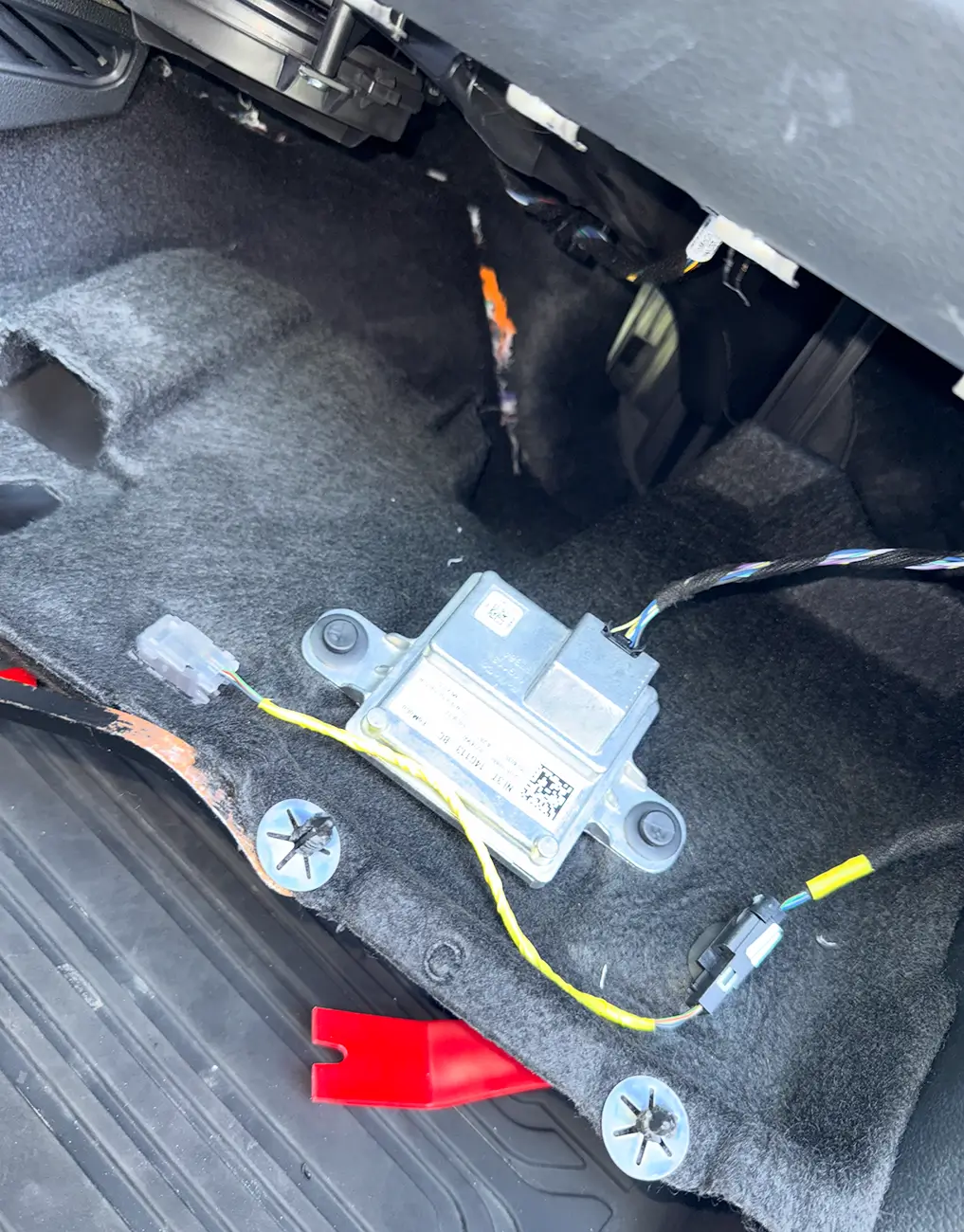

Wondering.... Could I change the pedestrian warning sounds?
I picked up a spare to play with via ebay.... This is located under the glove box.
Ford F-150 Lightning Hacking the Pedistrian Warning System Sounds Screenshot 2026-07-12 at 17.23.24
Pretty simple device, 6 wires in and out. Power, Ground, CANBUS high and low and a speaker.
