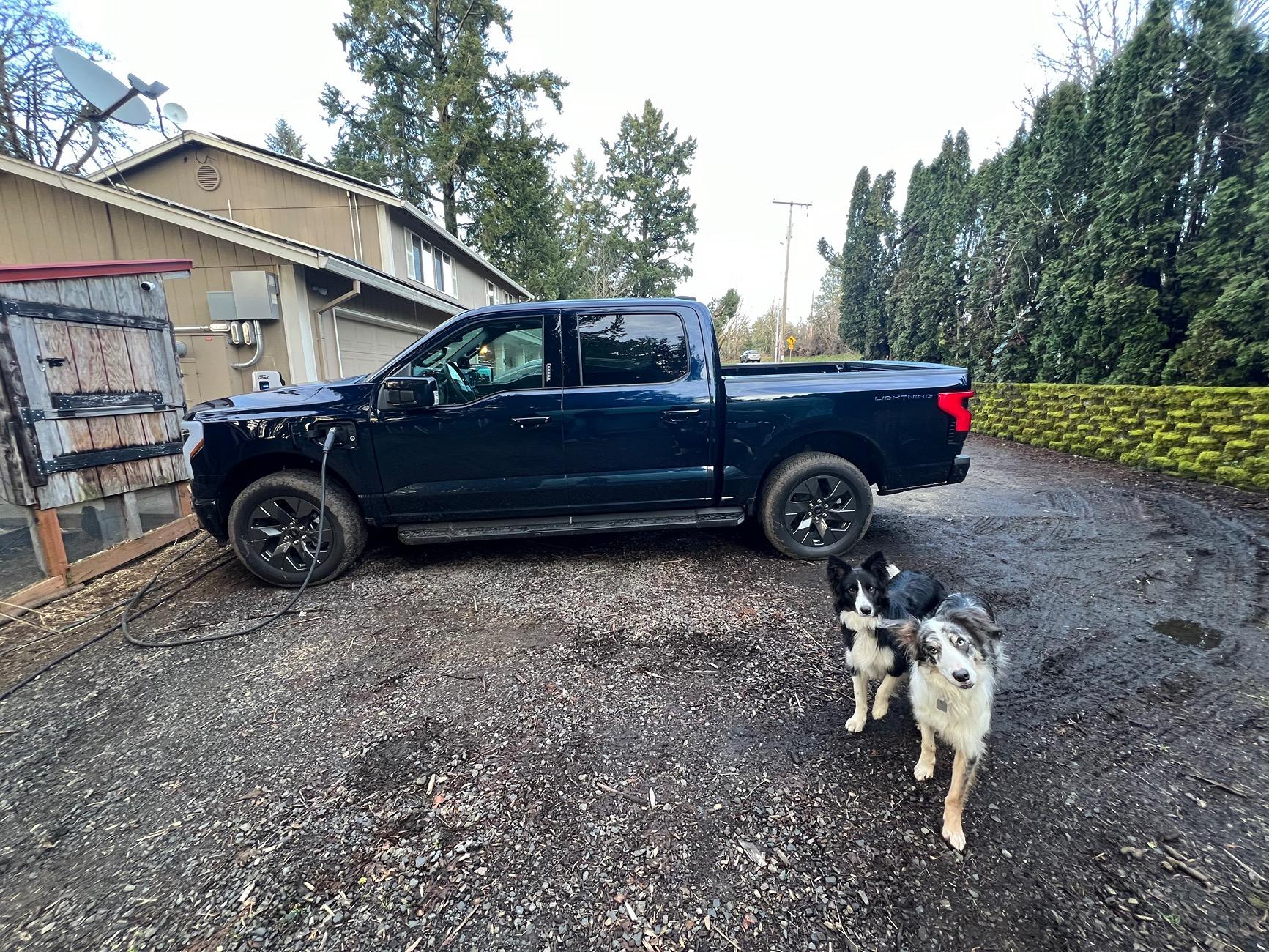

Same issues here too.
Recently, it only works if the truck is powered on, and event then if the truck is so close to the charging station my chickens start panicking….
