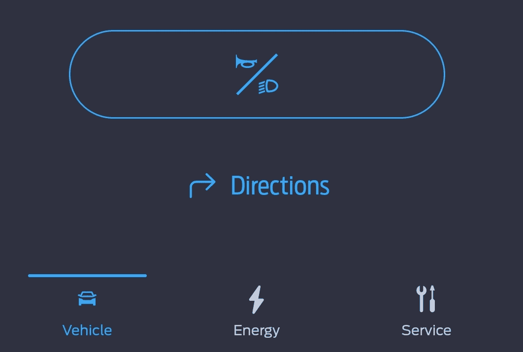

Did you hit the panic button on the FOB or in the Location menu in FP?
Been thinking about that. the FOB was laying in a tray on my desk. could I have tossed something on top of it. I don't think so as I had returned from my last drive several hours before. the keys, phone and wallet hadn't been touched. But that would explain it so I guess I'll have to go with that. too weird otherwise
