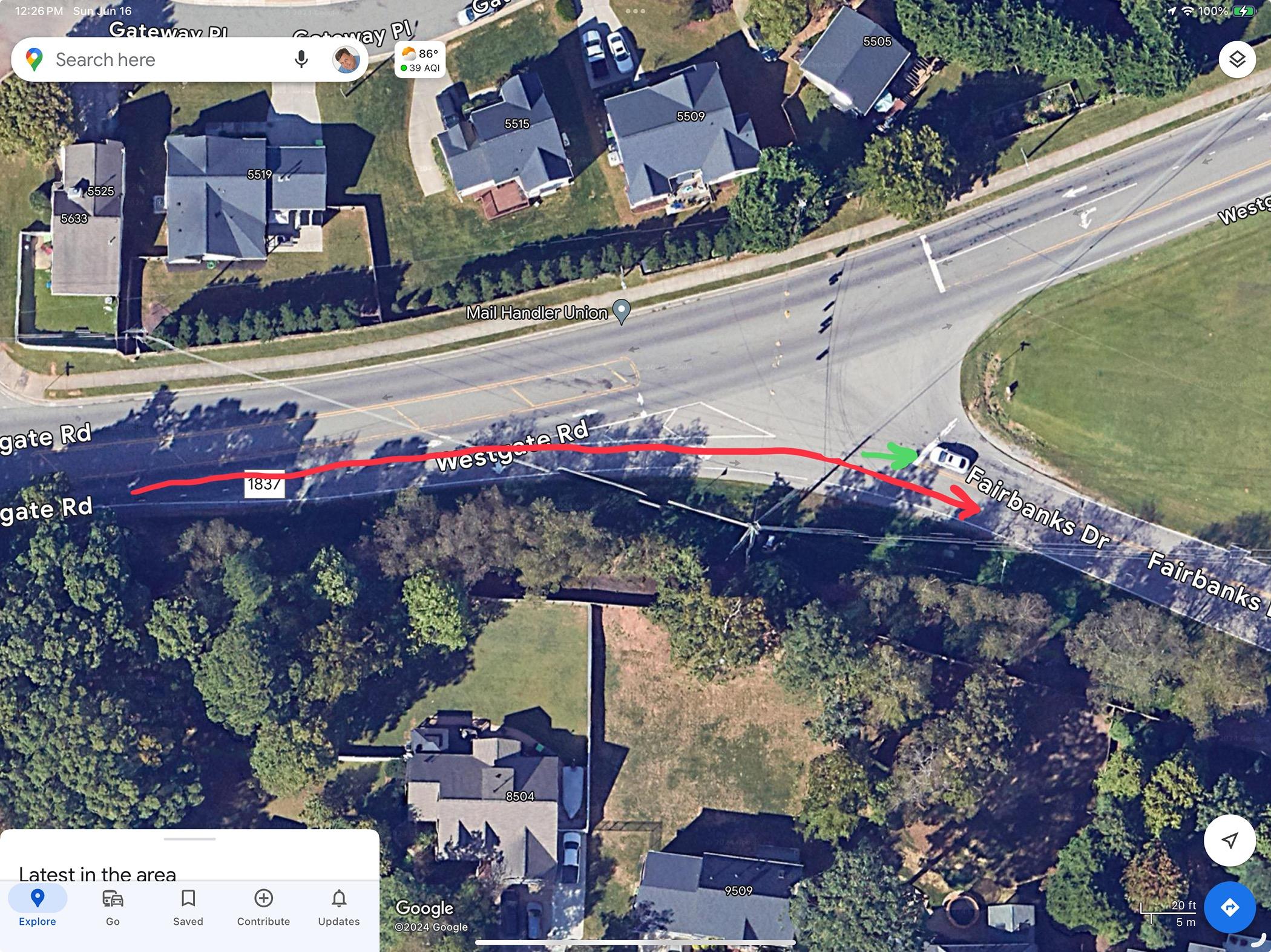

I’ve had it happen a couple of times. There is an intersection near my house that is only about a 20 degree turn so as you approach it you are pointed directly at the broad side of any car waiting at the light. I’m sure the computer is thinking I’m going to follow the road I’m on to the left but at the last minute I steer to the right directly at the side of another car as I turn right. The other time was on a curve approaching an underpass so the vertical wall of the underpass is directly in front of the truck just before you have to steer away from it.
Well, now I have to go drive the route again. There were no other cars, but there is a non-90 degree turn.
