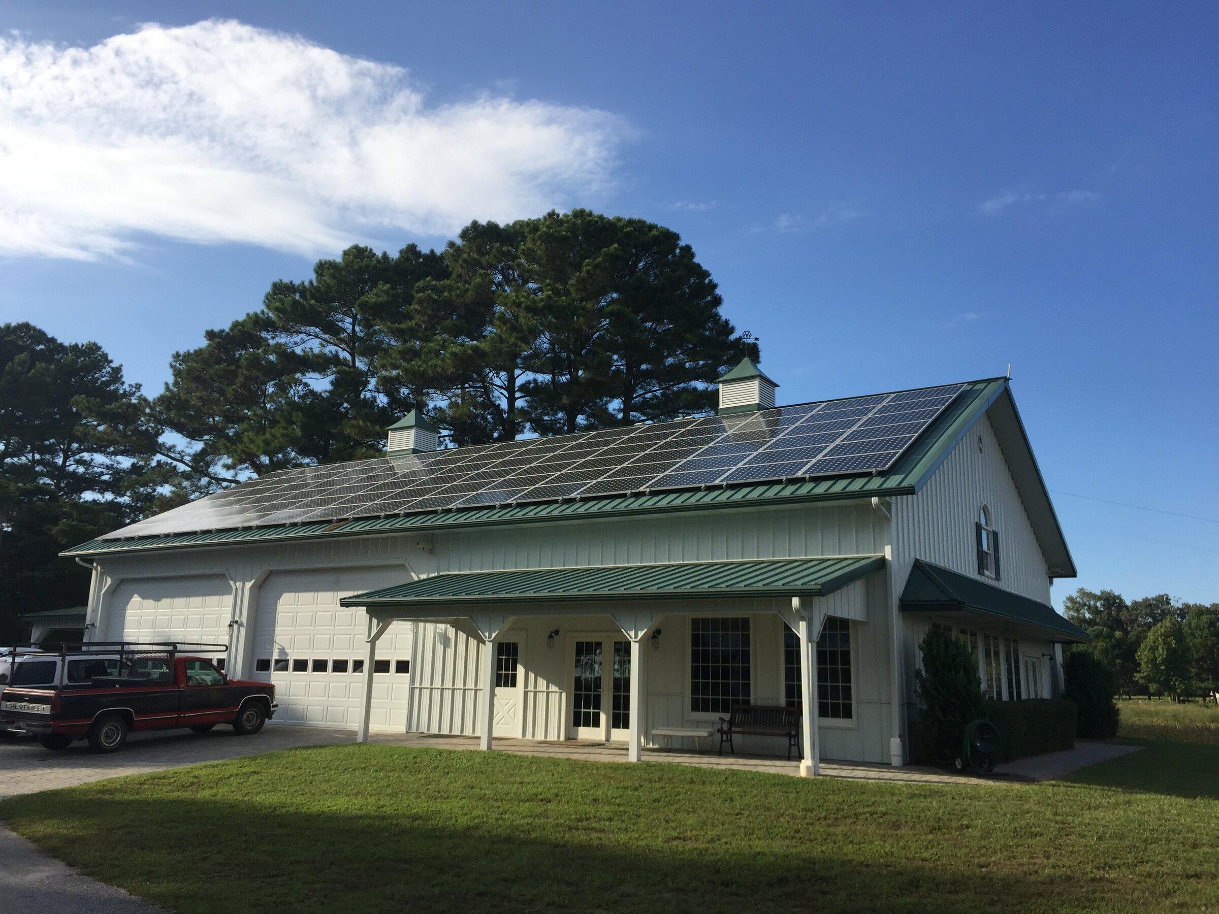

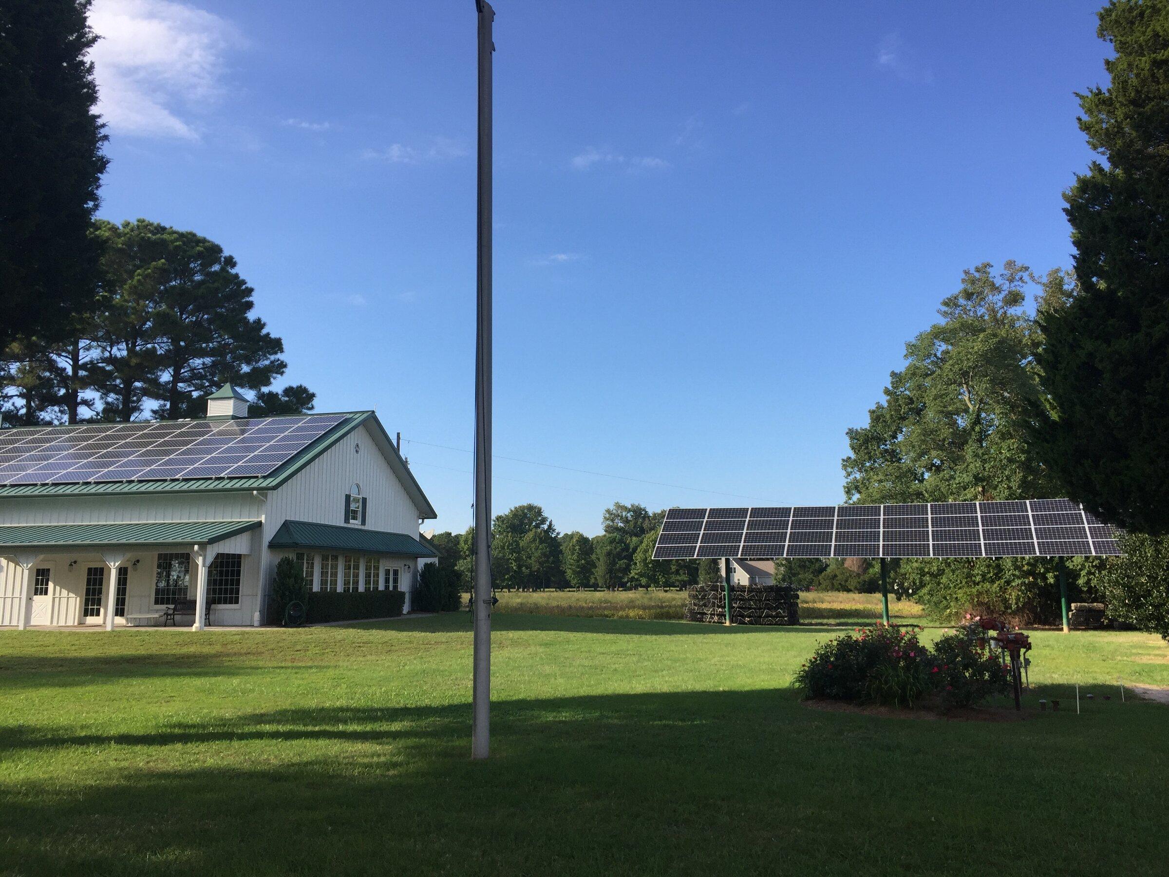

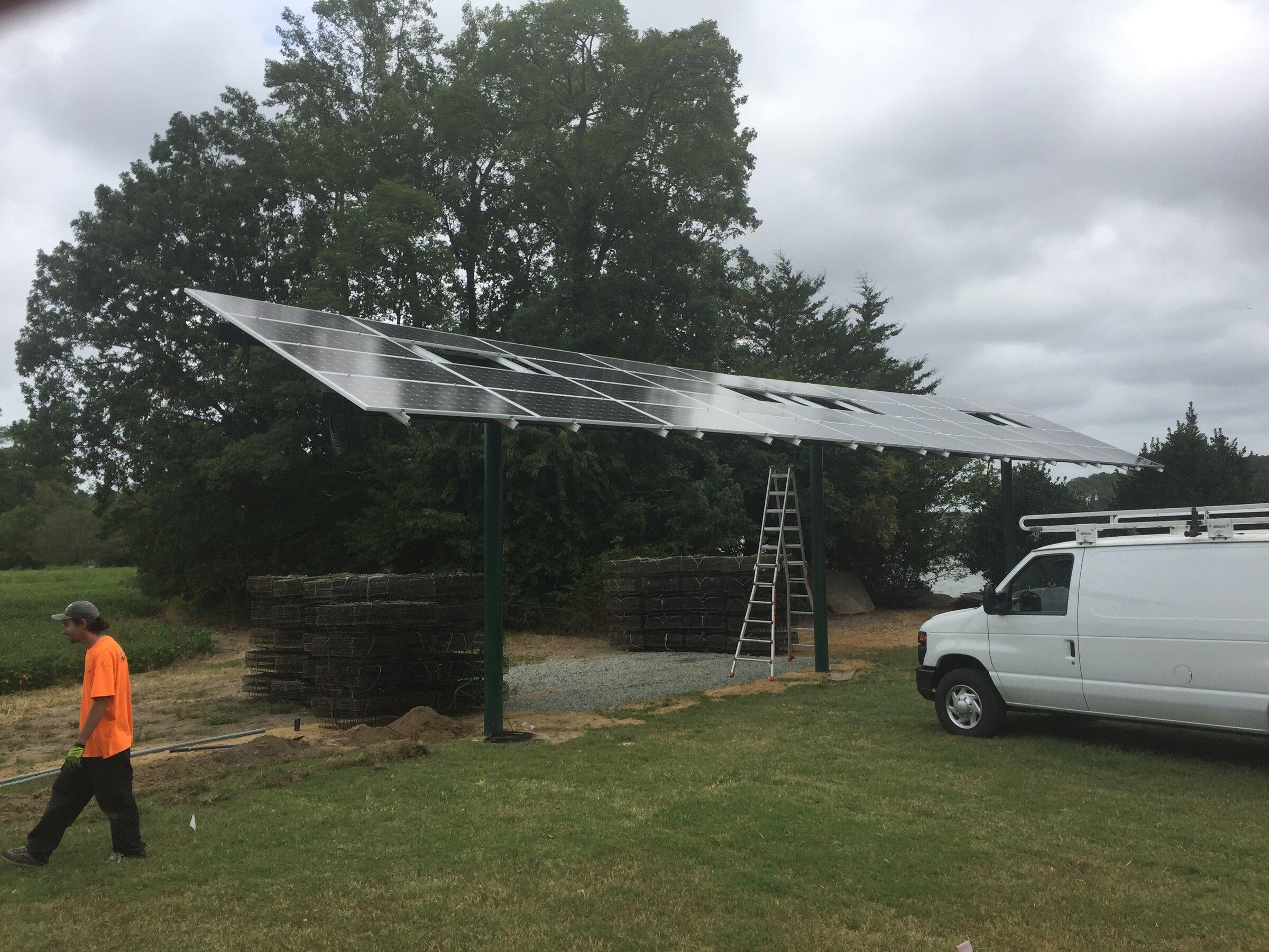

Technically, no one charges with solar unless you are off-grid. I have a 32 kW system with five inverters, and a TED energy monitoring system that watches 64 usage and generation circuits at our aquaculture farm. We produce more than we use on net basis across the year, and make about $16k annually selling SREC credits, plus about $4k of positive electricity sales. Even though we have no electric bill and sell excess power to the grid, it still is not correct to say that we charge with our panels. EV driving and solar panels are two completely separate and unrelated decisions, both technically and economically.
When we charge our EV's even on a sunny day when our panels are kicking energy back to the grid above and beyond our charging an dother local needs, the fact remains that when we plug in our EV, a grid leveling generator somewhere must be fired up that much harder and burn that much more fossil fuel. Someday the grid may have sufficient industrial battery capacity at the utility level to do grid demand leveling using green energy, but for now, that is not the case - every time we charge, we burn fuel somewhere. Put another way, the opportunity cost of charging is the energy that we would otherwise have sold back to the grid. When we plug in, that energy isn't sold back, and the grid must generate that energy another way, or work that much harder, burn that much more fuel.
I find it humorous and a bit misinformed, or if not misinformed, then disingenuous when EV drivers claim that they drive with solar electricity. To promote honest conversation about the technical and economic realities of solar and EV driving, I have had a small "Coal Powered" sticker on my Teslas. Because even though, like so many EV drivers with solar panels, I could claim that I drive for "free" and charge with solar, I refuse to lie to the uninformed folks who get their information from already-suspicious or specious sources. It is better to let them experience the reality of a Tesla test drive, and explain the economics of solar power, and why they can both be great things, but that they are completely unrelated.
I know it can be a nice feel-good to be sanctimonious about a green lifestyle, and do admit to being formerly guilty of chortling about our LEED-certified property and negative-carbon organic oyster farm, but it is better to be honest about how this stuff works in the real world. You ain't charging your car with solar panels (unless you are off grid). Our original 84-panel setup is on our barn and I recently added another 40 panels on articulating poles. Pics below.

At our farm (pictures above), I specifically built the barn with a southern-facing roof half and the correct tilt for optimal year-round solar gain for the first 84 panels, but did even better with the next round of 40 panels on articulating poles that I reorient four times per year to change the angle to the sun. Puttin panels, for example, on the OTHER side of that barn roof would be stupid, even though it is a big surface facing the sky. However, the further north you go, the sillier solar becomes. Seattle and Maine get two hours less sunlight in December than Miami, just when the power is needed most, so solar is dubious there. Go any further north and the numbers just don't work.
