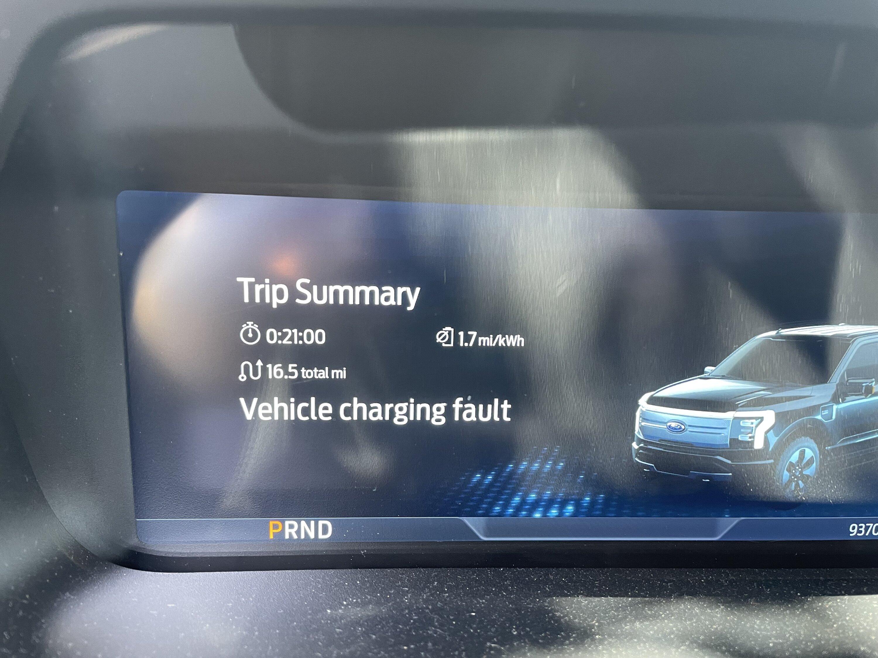

I've had an overall positive experience with my F150L, but yesterday was not my favorite EV experience.
I was making a 204 mile trip to a meeting in the Dallas area and had charged to about 94% the night before leaving (charged to 90%, forgot until shortly before leaving and added what I could on the FCSP at 80A). I made it without event until about 50 miles from my destination and sitting at 25% SOC, stopping at an EA DC fast charger. Plugged in like I've done successfully several times in the past and noticed the orange color ring next to the charging port. After a moment, the charger's display noted and error and asked to disconnect and try again. On the truck's instrument cluster it noted a "charging fault".

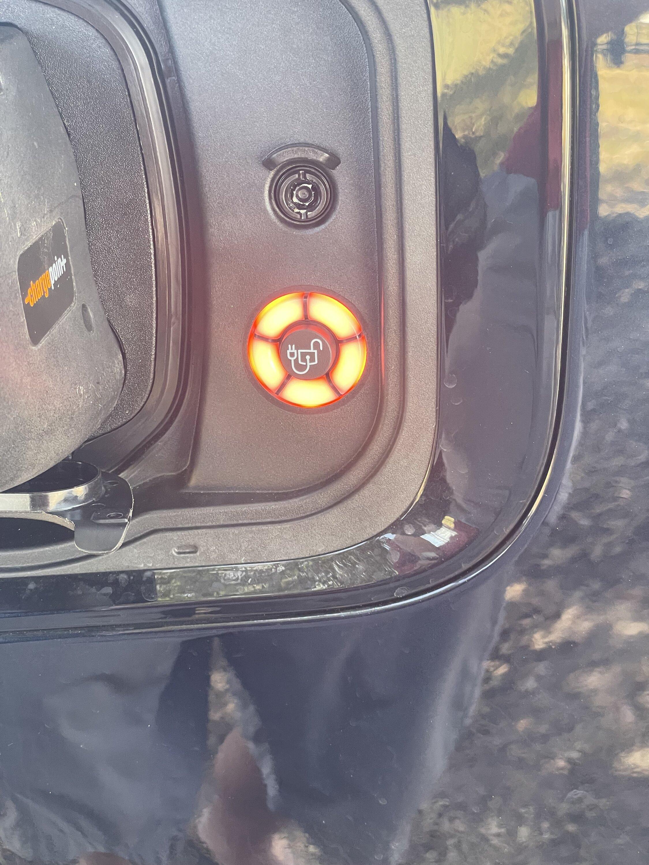

I unplugged, tried again in several different ways to activate the charging session via the Ford app, EA app. I next called EA support and a friendly rep tried several different ways to initiate the charging session and restarted two separate chargers (tried all 4 chargers there). A EV had successfully charged shortly before me and another EV successfully charged on a charger I had been unable to after, so the chargers weren't at fault.
I next called Ford's Lightning team and another rep looked for issues and sent me to the "battery team", who wasn't able to do anything other than tell me I needed to take it to a dealer for service. I can't be upset there's nothing they can do remotely, but I was really hoping for a remote reboot that would've cleared a software issue (even though it's probably not).
So I'm about an hour's drive to my meeting, unable to fast charge, and 151 miles from home. There really wasn't any Level 2 chargers nearby without heading another 60 mile roundtrip distance away from home, and no Level 2 near my meeting. I looked on PlugShare, EVgo, ABRP, ChargePoint, Blink and Chargeway. If I missed any, I'd be curious to know.
I did note there was a Ford dealership about 1 mile from me, but no charger was listed. It was 7:45am, so they hadn't opened officially yet, but I drove into their lot and was greeted by a service rep who let me know they did a have a charger onsite I was welcome to use. I was pretty happy in that moment, but less happy after I discovered it was putting out a whopping 5kw. I was able to connect to the dealership guest wifi and do my meeting remotely, had Whataburger delivered for lunch, and sat in a/c comfort for a solid 8+ hours. The staff at the dealership couldn't have been more accommodating, but it's not my dream to spend my day in a Ford dealership. I did the math about 40 times during my wait, and convinced myself at 59% I could make it home and still be able to have my a/c going with a tiny cushion.

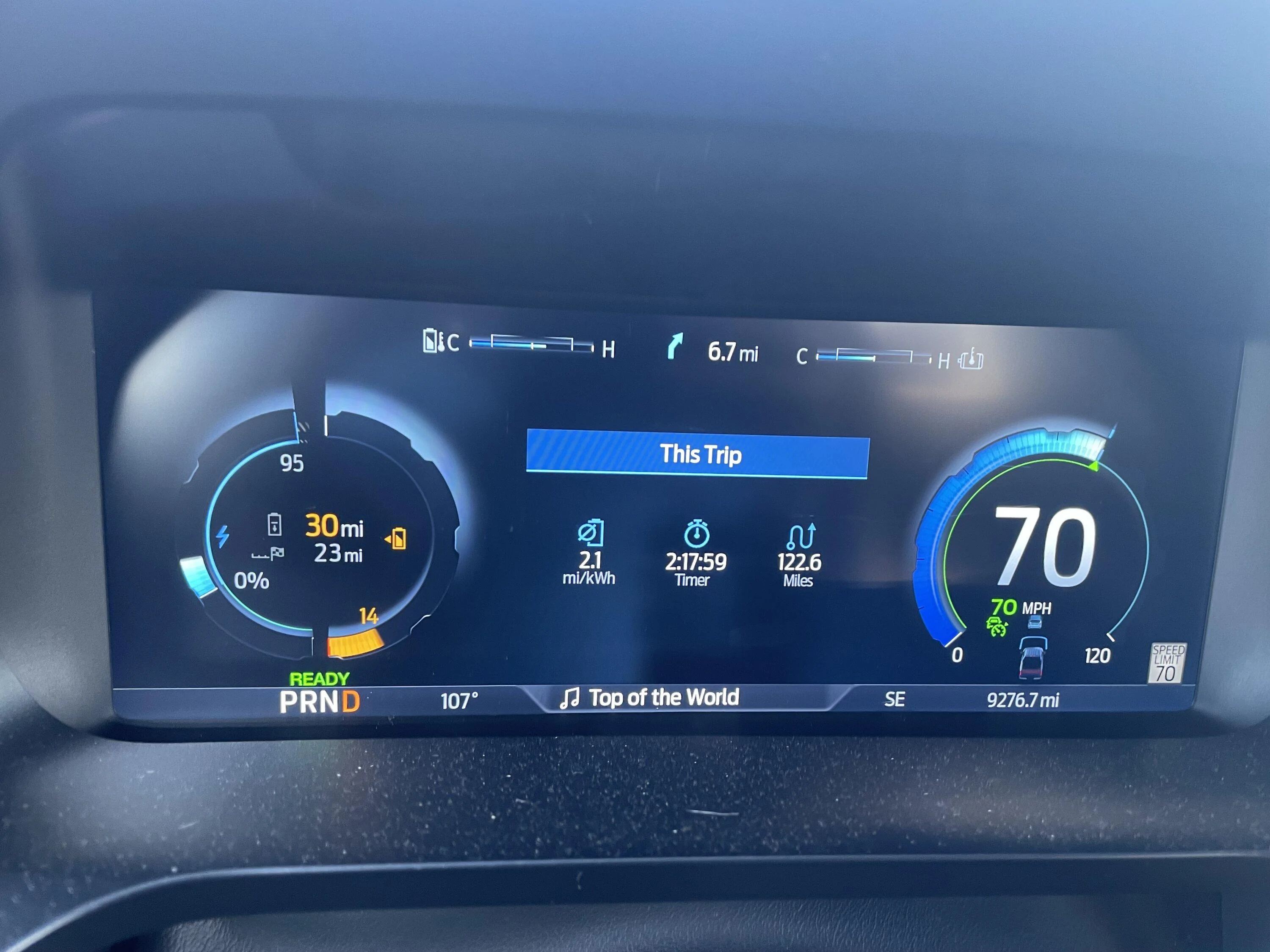

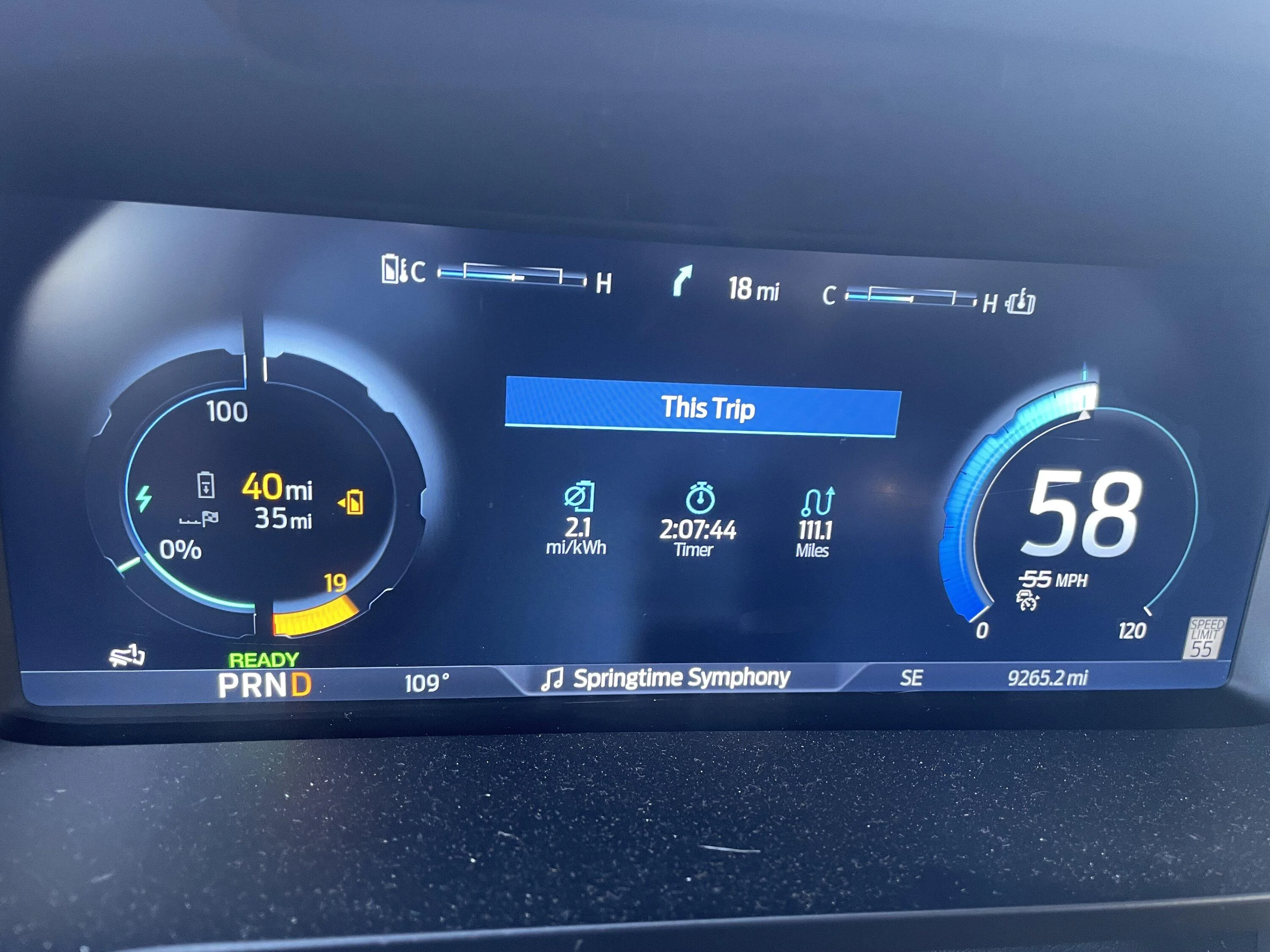

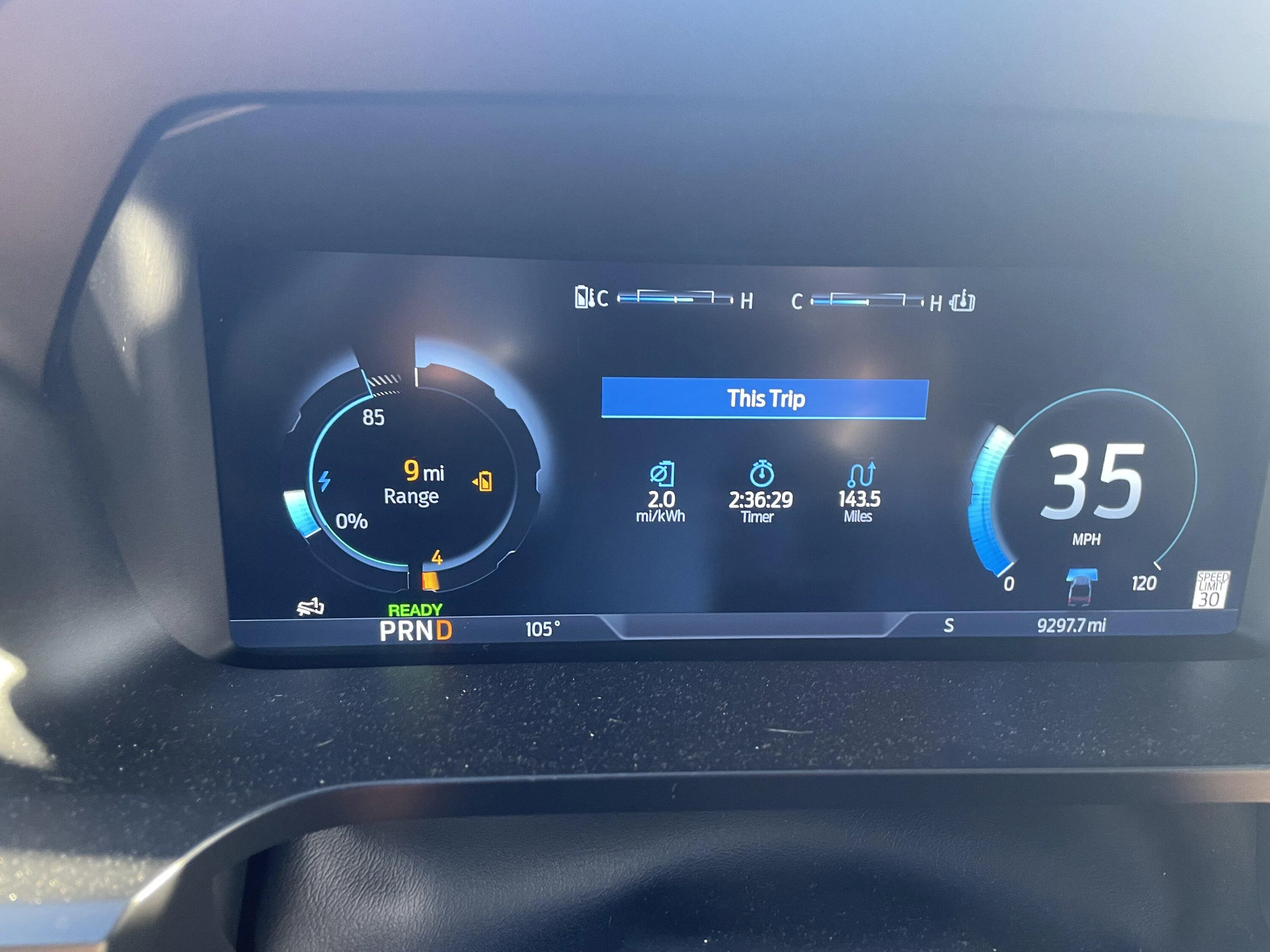

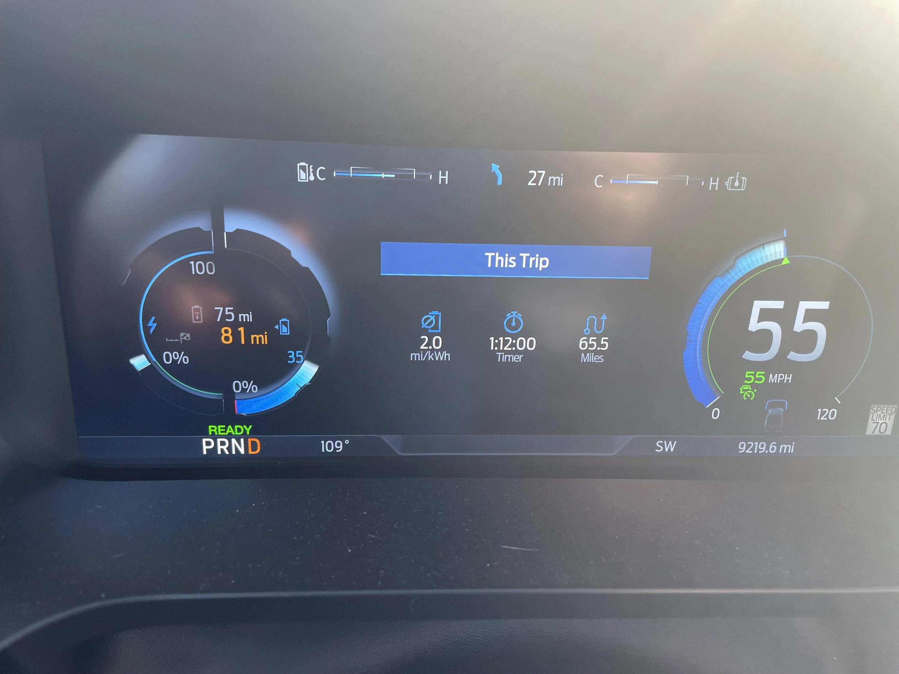

I ventured out at 59% and drafted as many 18-wheelers going 65mph as I could on the interstate, and stuck to 55mph on the 2 lane highways, moving over on the shoulder to let people pass (more the 30 times getting friendly thank you waves or light flashes before I stopped counting). I did have a couple Level 2 chargers about 15 miles short of my house if I was really not going to make it, but for the last 25 miles or so I was feeling good about it and went up to 70mph again. I made it home with 4% to spare.
There was definitely an intial "Oh #!@*&%" moment when I realized I wasn't going to be fast charging, but I hope this helps someone in the future if you're in a similar situation.
I have an appointment Monday morning with my local dealership to dive into the diagnostics. I'll keep you posted.

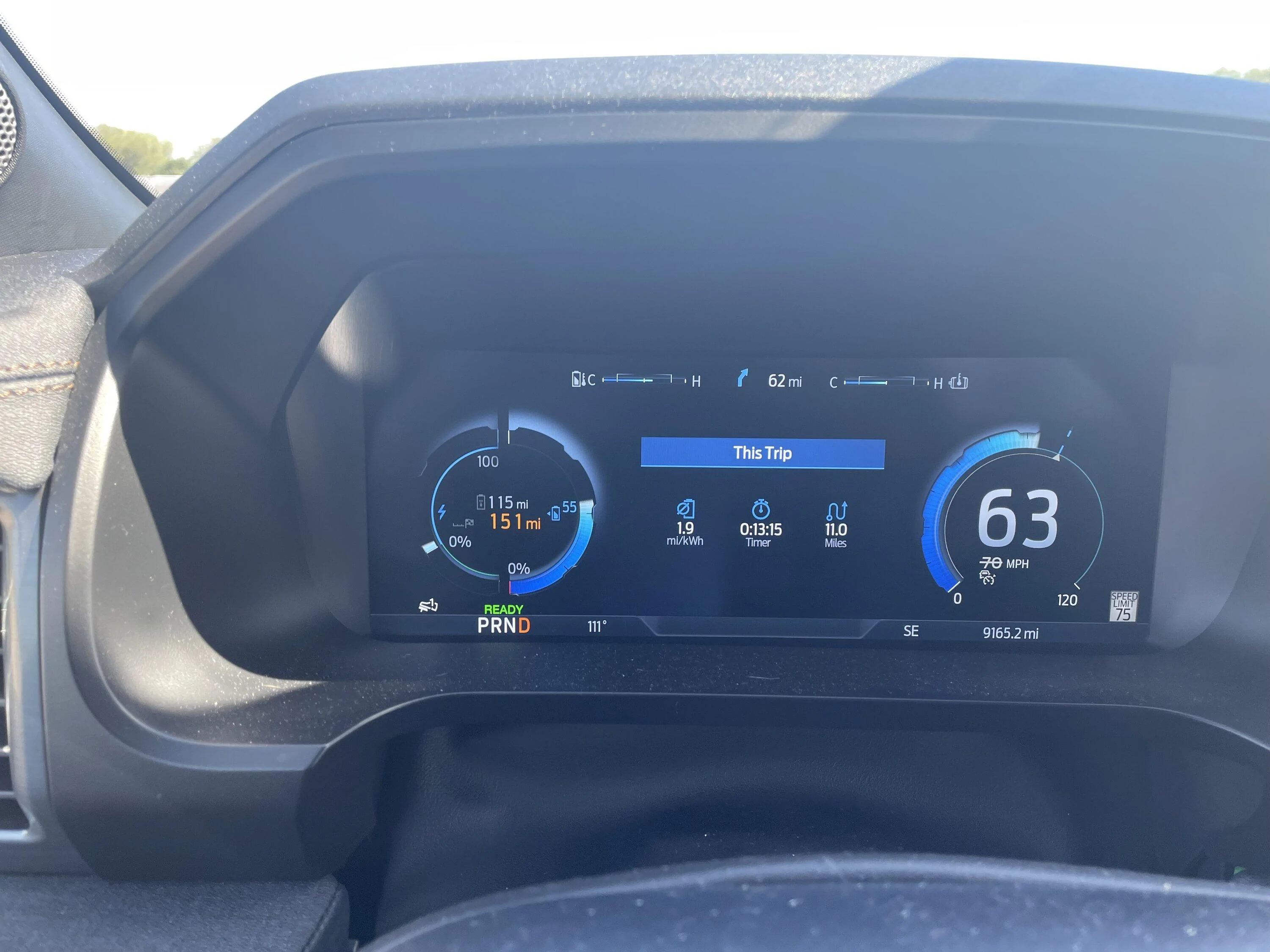

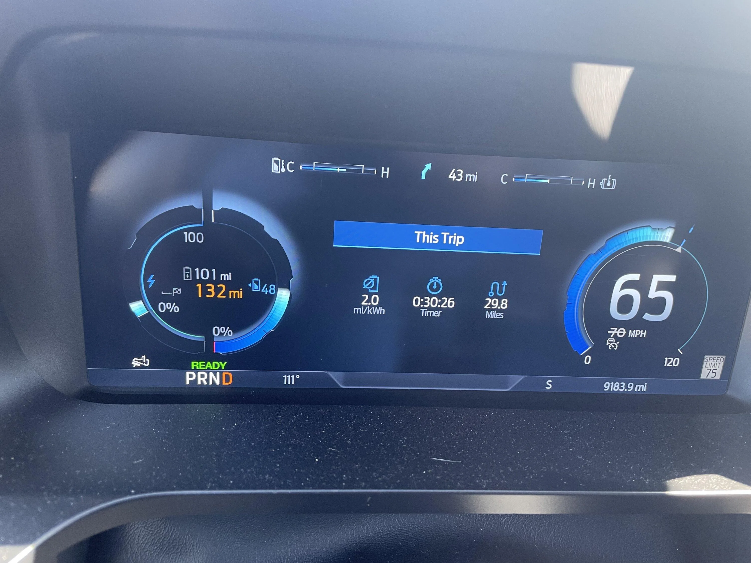

Some photos watching the range remaining become bigger than the distance remaining.
Ford F-150 Lightning DC Charging Fault 151 miles away from home IMG_5916
Ford F-150 Lightning DC Charging Fault 151 miles away from home IMG_5918
Ford F-150 Lightning DC Charging Fault 151 miles away from home IMG_5920
Ford F-150 Lightning DC Charging Fault 151 miles away from home IMG_5924
Ford F-150 Lightning DC Charging Fault 151 miles away from home IMG_5925
Ford F-150 Lightning DC Charging Fault 151 miles away from home IMG_5926

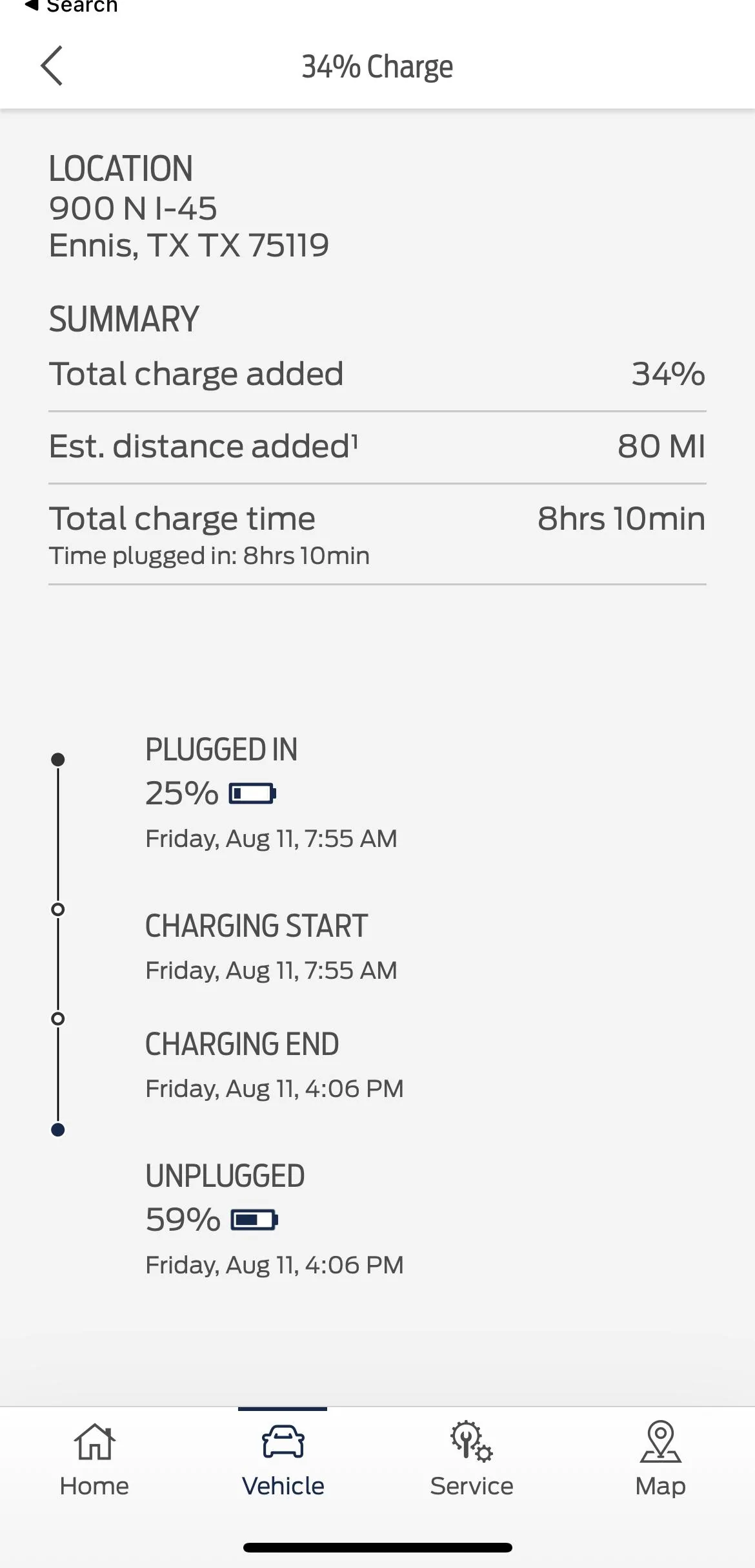

The final charging info.
Ford F-150 Lightning DC Charging Fault 151 miles away from home IMG_5930

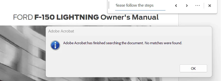

At least update the manual .....
Ford F-150 Lightning DC Charging Fault 151 miles away from home 1691936847575

That's important to know......

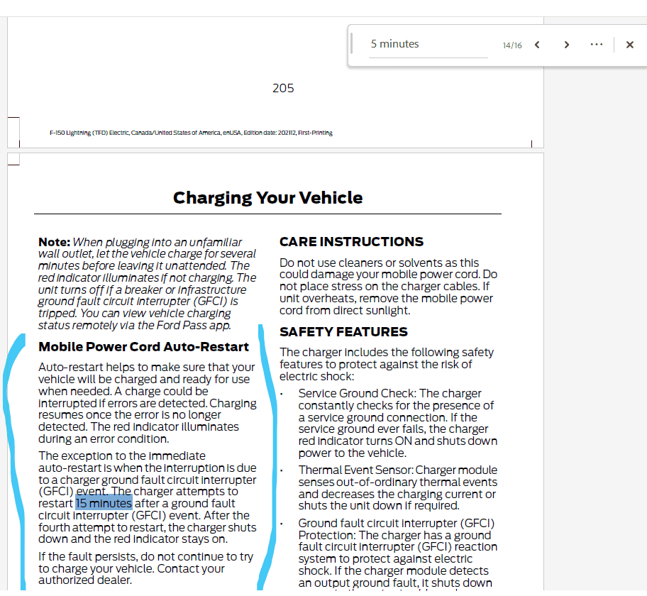

The closest remedy related to charging errors when using the FMC are in the 2022 manual advising the system will retry up to four times before showing a red "indicator".
Ford F-150 Lightning DC Charging Fault 151 miles away from home 1691937972788

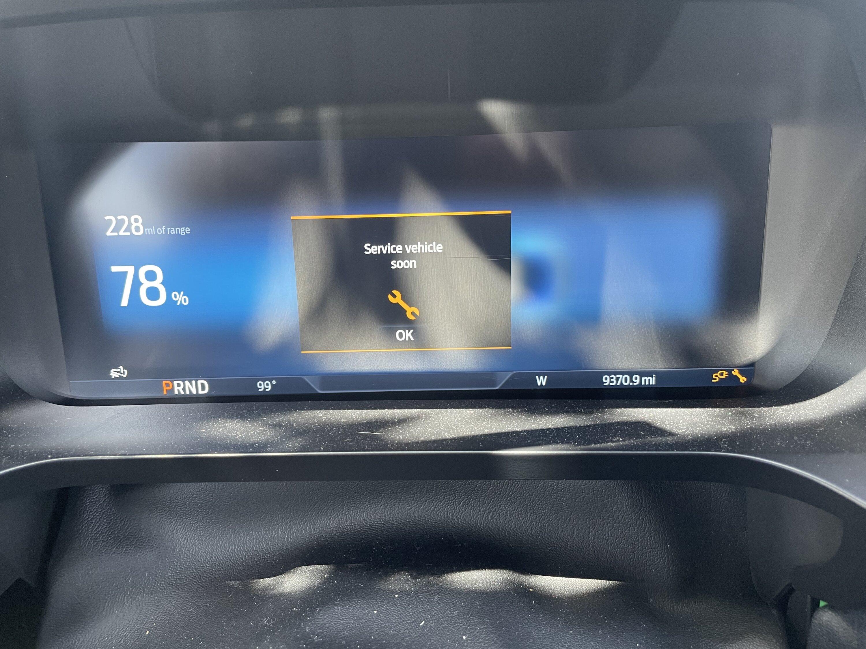

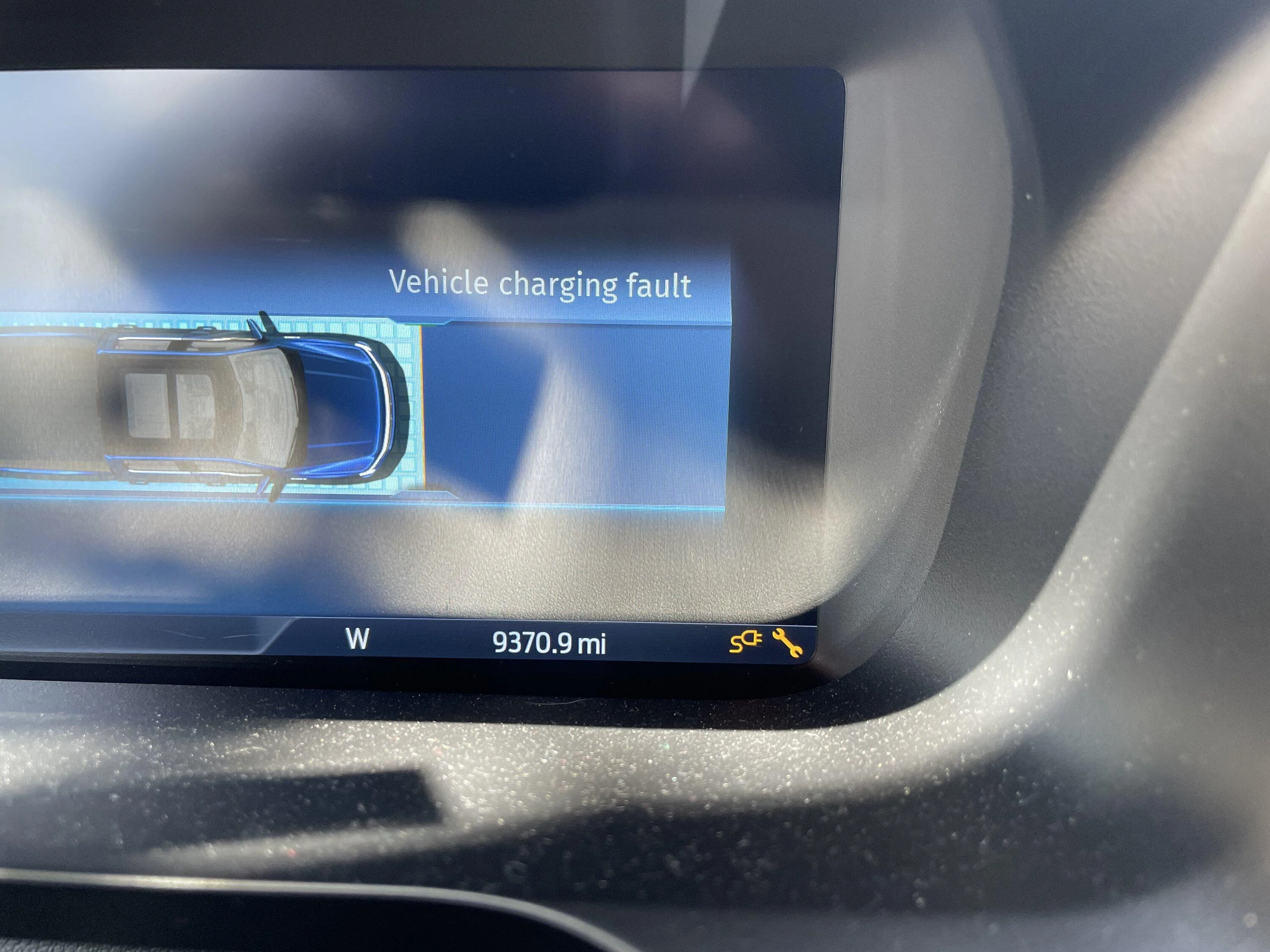

Took it to a local L3 charger, experienced the same result. This time took some photos to go along with it.
Ford F-150 Lightning DC Charging Fault 151 miles away from home IMG_5936
Ford F-150 Lightning DC Charging Fault 151 miles away from home IMG_5933
Ford F-150 Lightning DC Charging Fault 151 miles away from home IMG_5937
Ford F-150 Lightning DC Charging Fault 151 miles away from home IMG_5939
Tried the 10 minute power off this time and had the same result.
I was able to move to a L2 public charger adjacent and it connected and began charging fine, just like at home. Seems to confirm just a DC problem.

Got the truck back today. The fault was with the actuator to hold in the connector during DCFC.
A quick search with the part number and it’s only about a $40 part. Anyone know how complex the process is to replace it? I wonder if it it could be a DIY process if you were on a longer trip if it had to be
