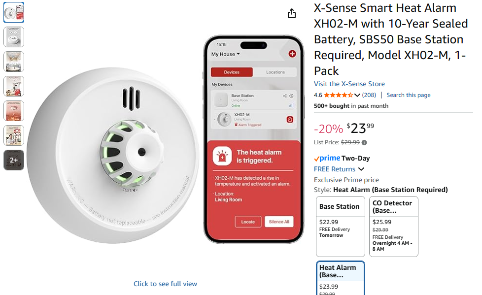

daczone
Mar 10, 2025
89
173
Oregon
2024 Lightning Lariat
Put this over your truck.... it's cheap, it's wireless and should be near any EV charger as a safety measure. Battery lasts 10 years too. I have one in my garage with my Tesla and a 2nd one in my shop over my truck. Not a smoke detector, but HEAT.
