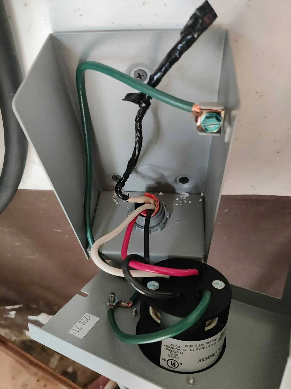

Agree, about the disclaimer, me bad and will keep that in mind in the future.
I used a lockout so all circuits still have a path to ground. The picture is of the generator plug from the truck to the panel and any ground fault would still trip the GFCI breakers, just not the GFCI on the truck. The 200 amp panel is new, almost all the circuits in the house and up to code for wet locations (including the outlet near the back door that could get wet if the dog shakes off) and everything that needs GFCI protection has it so, in this case, I feel comfortable relying with the way it's setup.

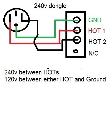

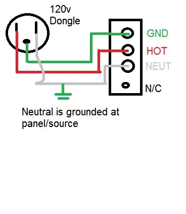

PS: Re: EVSE's that don't need the neutral: it is because they are 240VAC, they still need a ground. Note that there is 120VAC between either hot lead and ground however.
The neutral is needed for 120VAC though such as with the Ford Mobile Power Cord 120v dongle (see illustrations). They also have a ground for safety in case of a fault.

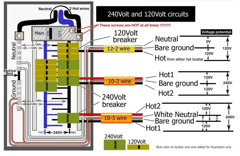

Re: why we have neutrals: They are to provide 120V circuits in a typical house through a split-phase main service panel (see illustration). 240VAC comes into the house and feeds the main panel with 2 hots and a neutral is also provided as shown (there is also a ground for the service not shown).
The 240V is split between the two columns of breakers in the panel.
The neutral is bonded (connected to ground) in the main service panel.
120VAC circuits use a hot, a neutral and a ground wire (12-2 wire shown).
240VAC circuits use 2 hots and a ground wire (10-2 wire shown).
If the 240VAC appliance also needs a 120VAC feed, then a neutral wire is also provided (10-3 wire shown).

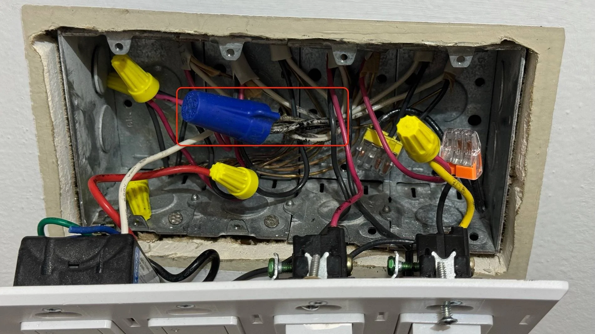

Adding to the possible causes, I had this same issue of GFCI faulting even with the switching transfer switches mentioned here. There was a light switch box with multiple switches and circuits, someone had taken all the neutral wires and twisted them together instead of correctly making individual loops from and back to the breakers.
This should be something easy enough for you to inspect on your own without an electrician, maybe you'll get lucky and find an easy fix.
