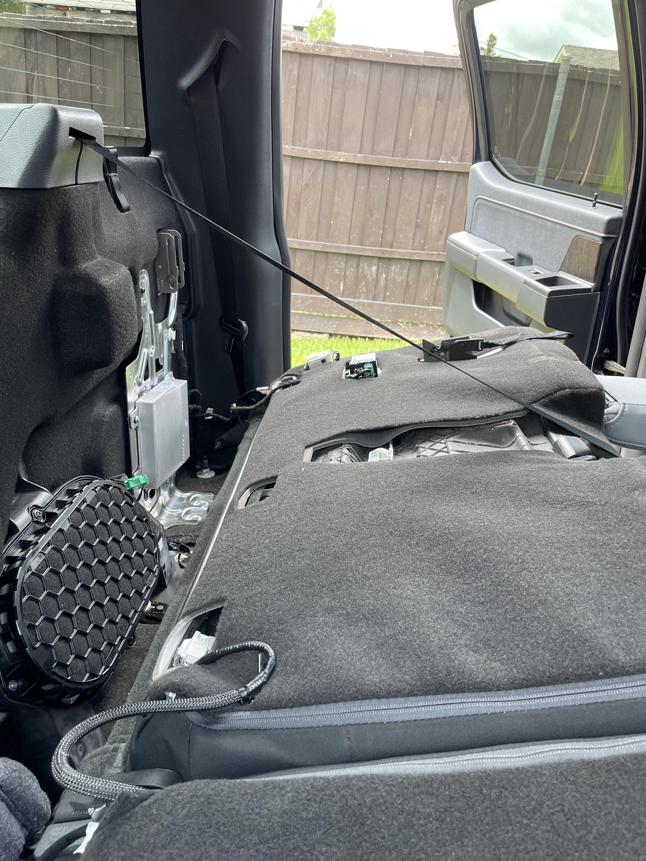

Installed JL Audio 8" Powered MicroSub+ behind rear seat - Lariat ER

There is a sub back there with the standard B&O. At least they call it a sub, it isn't much.
Ford F-150 Lightning Installed JL Audio 8" Powered MicroSub+ behind rear seat - Lariat ER IMG_2077

Transforms the audio experience and doesn't interfere with under seat storage. Replaces the stock subwoofer. Power fed from 12v battery. It really is amazing bang for buck. The sub output level control is installed on the steering wheel column. I highly recommend this solution to anyone wanting to improve the audio experience with minimal work.
One more question. I've read that that the stock "sub" is vented outside the cab. Do we need to cover or plug the hole when removing it>?
Thanks for asking the question, I had noticed the hole and then completely forgot about it.

I was contemplating getting the Kicker but read it was only 100w RMS, and don't really see the value in that for what it costs. Sounds like you can do everything with FORScan but someone mentioned they bought the 2 day FDRS license to do the Sound System Upgrade.
Out of all the random stereo installs and basic amp wiring installs I've done, I have no clue where to grab the high level signals for these powered subs without snipping wires.
Go check post #37. SGS will confirm, but I think that is all you need, along with power.
Ask the SGS guys if they have a plug and play harness that you could buy? Seems like they have a lot of knowledge.
