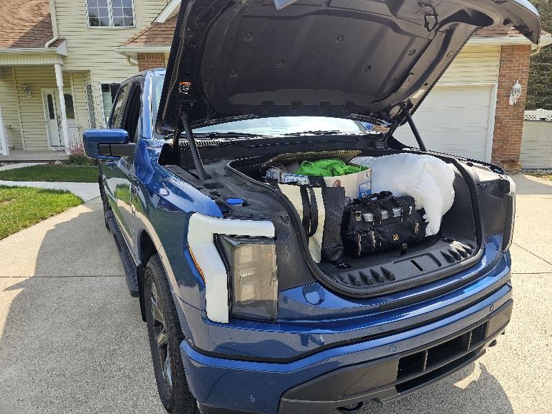

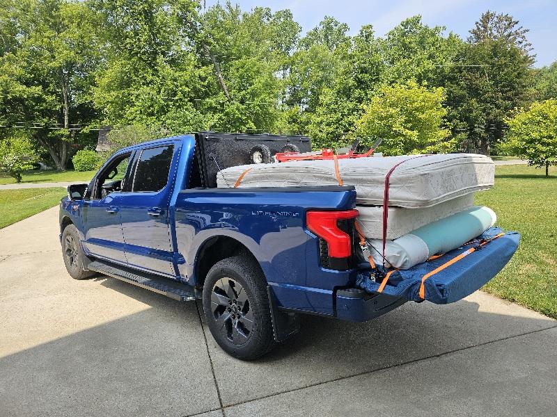

I moved my daughter across the state a couple of weeks back. Loaded the truck up pretty good. I still kick myself for not looking at the scales to see my weight. Bed was full, frunk was full of miscellaneous stuff and hand tools, and the cabin was full with the wife, the dog, our carry-on bag, painting supplies and myself. I got the same 2.0 to 2.1 mi/Kwh I do on my daily highway commute to work when it's just me in the truck.
I feel weight really isn't an issue for the trucks efficiency. I think any extra drag makes the difference. I kept my speed between 71 and 73 on the freeway. The truck exceeded all my expectations.
Weight seems to have VERY LITTLE to do w/ efficiency if you aren't hitting a lot of hills and big climbs, IMO.

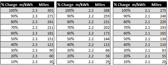

Really good responses to this thread. I will just add something I noticed with the GOM (which you should not trust). The reduced range according to the GOM only hits me when I use the Ford Nav. I reset my driving history and have not used the Ford Nav and the last 400 miles, the GOM has been dead on with my calculations of battery size, %, and m/kWh. But the first time you use Ford Nav, the GOM is off. Calc is like 131*m/kWh*battery%=Range.
