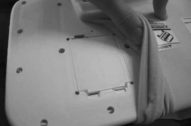

In short, visors usually (not always) have the cutout for the Homelink module. You remove the cloth cover (actually peel it back, cut out the area (which is already perforated), find the mirror wires, stick the module from Ebay into the compartment after connecting the wires, put the cloth back, cutting out a tiny area, and snap the cover on.
I did this on my 2010 Fusion Hybrid, my 2013 F-150, and my 2018 Fusion Energi (was removed "due to interference"). The only unknown is whether the area is perforated still. On some vehicles, I could feel it through the cloth.
In 2018, I bought the module for the Fusion Energi for $13 on Ebay. In 2014, I bought the one for the F-150 for $21.90. Looks like they're $55 now.
Here is it installed on my 2013 F-150. Looks factory.
You need power, which comes from the vanity mirror, and you need to verify the cutout is there. The fabric (see attachment) is stuffed into the inside of the visor and held by plastic teeth. When you're done with the install, you use a plastic tool or credit card to stuff it back in.
I have no idea if the cutout exists today.
Also - others have done a similar install except into the center console, you can find those instructions by Googling.

I should add that I'm not a "modder", nor do I possess good skills. This just takes patience, in folding the cloth back, pulling out the piece, fitting in the module, putting the cloth back, cutting out the section, and snapping the cover with the buttons on.
Also - keep hands clean so you don't put fingerprints all over the visor.
