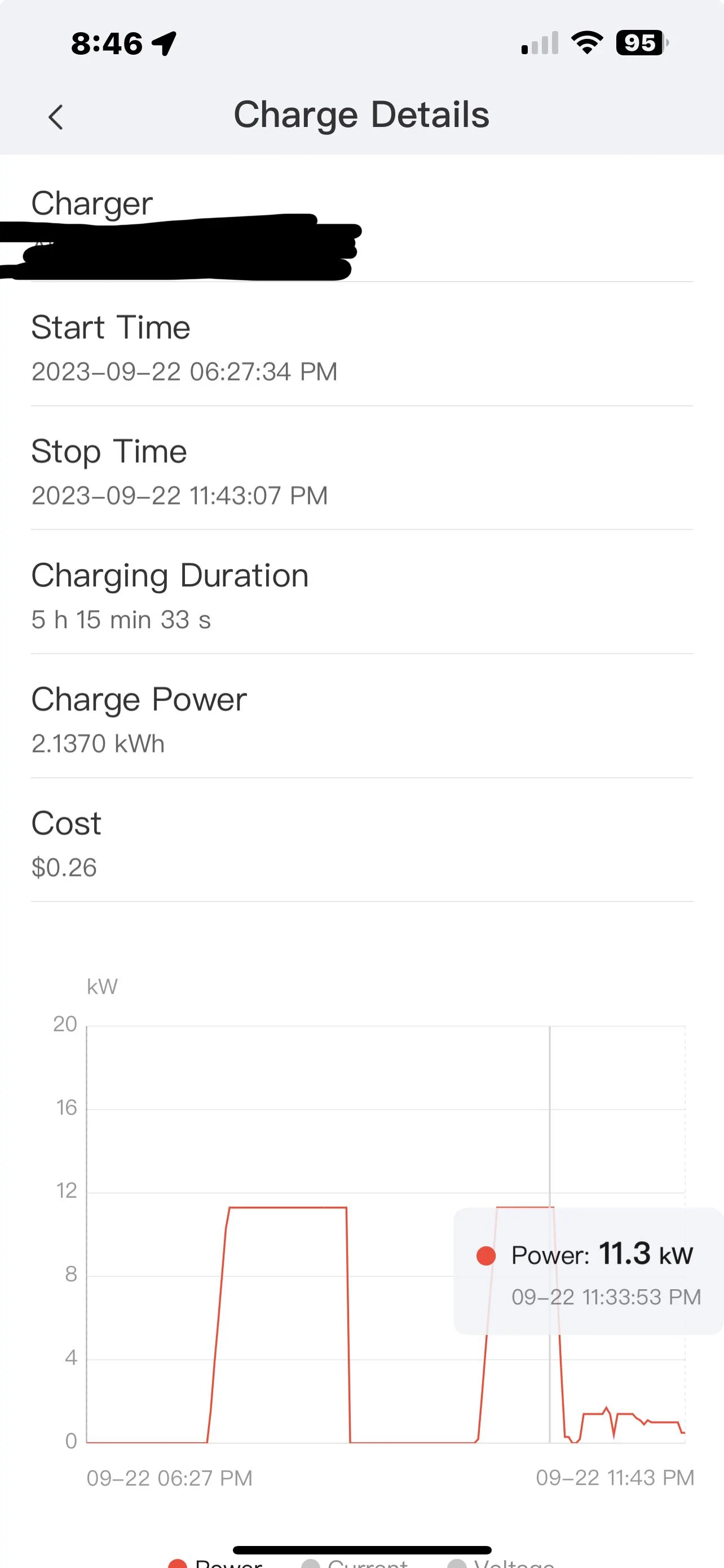

This weekend tropical storm Ophelia came through North Carolina. On Friday night I went ahead and plugged the truck into my transfer switch in case we lost power. We never did lose power but it did flicker a couple of times just before bedtime so I went ahead and switched over instead of having to get up in the middle of the night to switch. I was plugged into the EVSE and had finished charging back to my normal 80% before I switched. I noticed a couple of interesting things.
First, when I switched on ProPower the truck starting charging at full power for a few minutes. Then it seemed to drop down and pull just about enough from the charger to run the ProPower. When I checked my charge in the morning I was still at 80% so it did not use any battery to keep the ProPower running. It seems that if you supply power to the charger and use the power from the ProPower you basically turn the truck into a very large UPS.
The other thing I noticed is that using ProPower affected the GOM. Usually at 80% my GOM shows about 180 miles (SR battery) but after running ProPower all night it was only showing 158 miles. The software really shouldn't use any zero mile trips to calculate the GOM numbers. I've got a road trip next weekend and this is going to make my estimates even less accurate. If @Ford Motor Company would give us a generator mode in the software it could prevent this and improve the accuracy of the GOM.
The screenshot shows the power supplied to the truck. I only drove a couple of miles on Friday so the initial charge on the left was only a few minutes. When it turns on again is when I was getting the truck started and making the switch. After the switch (the vertical line) the power drops and starts to mirror what the house was using.

I'm confused: you think that the truck SHOULDN'T give you a NEW approximate range figure AFTER you've used ProPower 'all night'...(although you don't mention how much)...
If the ProPower consumed battery power, you obviously will have LESS miles to travel.
If the truck was plugged in to the charger, at the same time the ProPower was being used, then you can certainly 'think' or 'assume' that the charging then MUST be replacing your battery usage, but that MAY not be the case.
How much KWH did you use from the truck's ProPower 'all night'??
How much did the charger provide to the truck during that time, if ANY?
The SOC was 80% and the GOM was at 180 when I switched. The next morning the SOC was still 80% but the GOM was showing 158. I’m pretty sure I could drive the same distance with 80% SOC before or after running the house overnight. My point is that the truck did not use any battery power but the GOM calculation factored in a zero mile trip that did consume energy.
