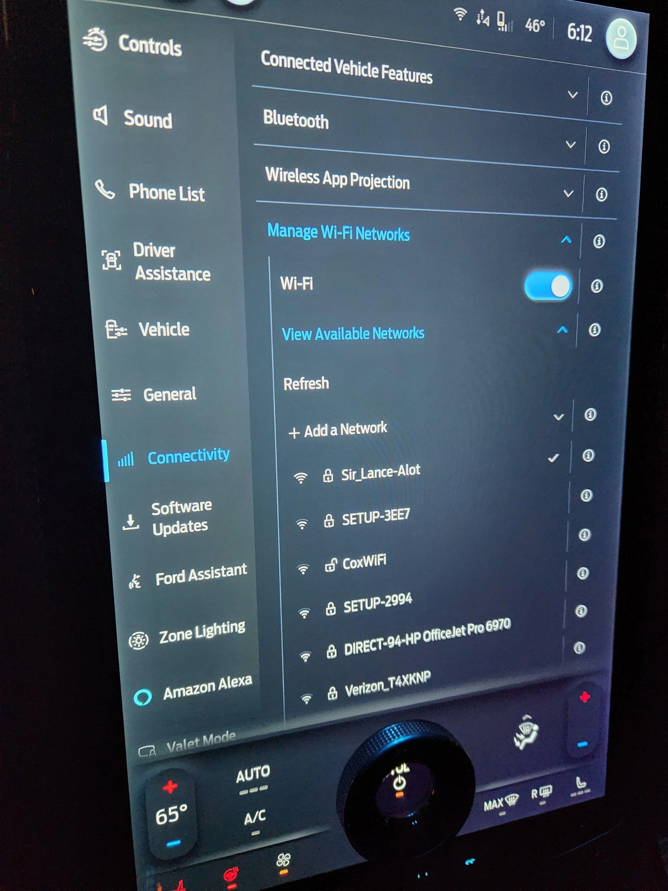

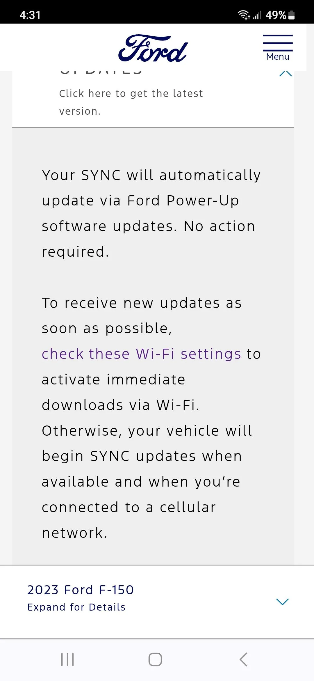

I tried to kick off Update and keeps coming back nothing to update/download. Now digging more and reading more it says you need to be connected to a cellular service....WTF? I'm connected to my home WiFi and phone Bluetooth.... What cellular service do I need to get these updates?
How does this crap work?

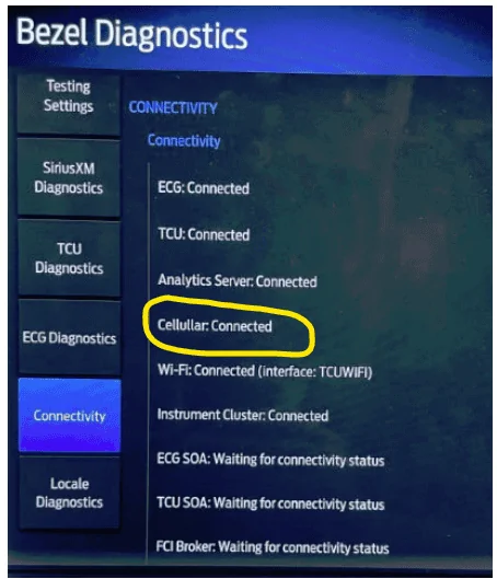

To check if your cellular is working, go to the hidden Diagnostics menu. Instructions here: https://www.f150lightningforum.com/...ics-menu-undocumented-in-owners-manual.16392/
One of the screens will show this:
Ford F-150 Lightning Let's talk Automatic Updates and Cellular Service? 1705357910447
If your show Cellular Connected and TCU Connected then the onboard modem is connected.

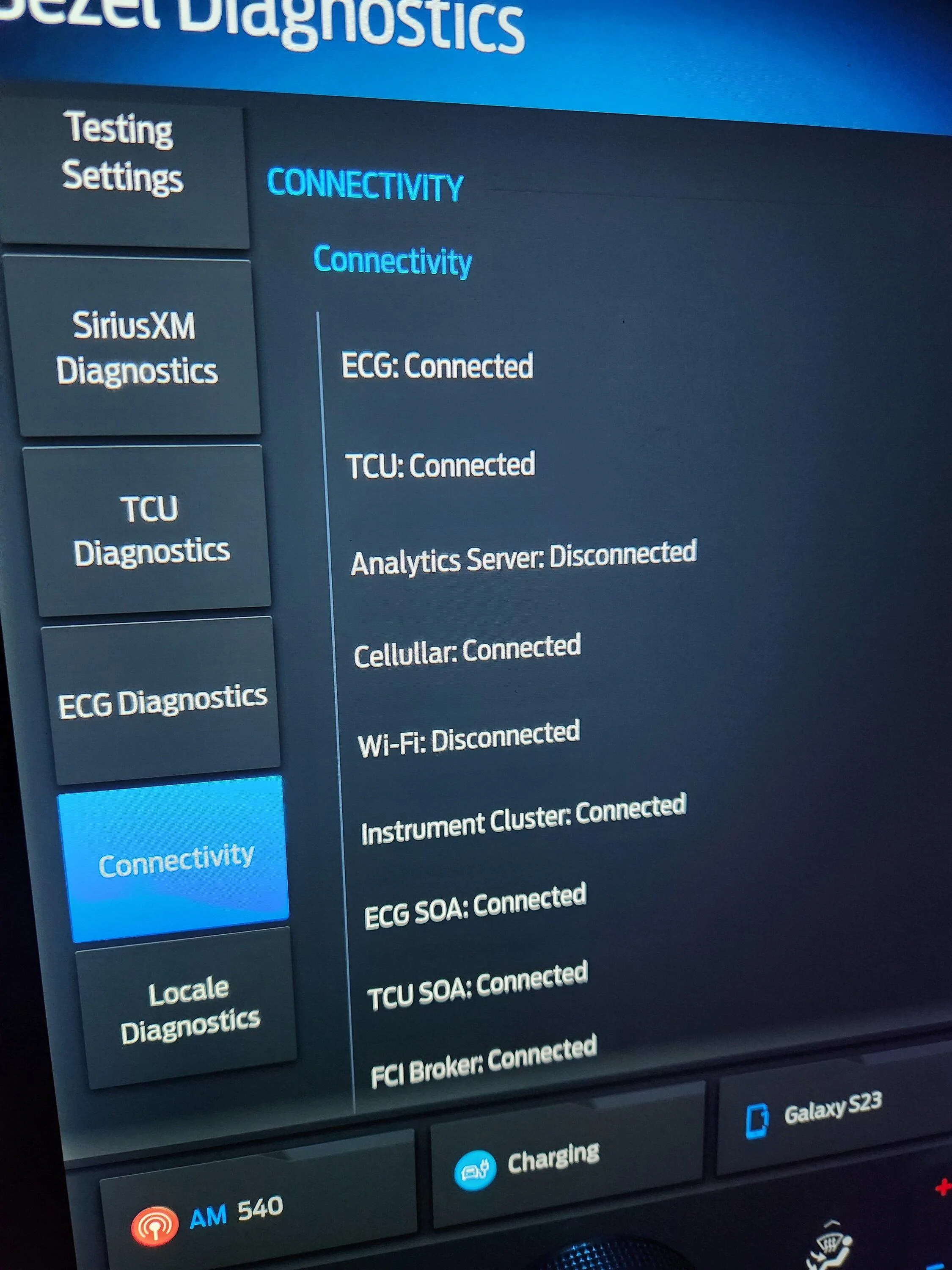

I did the Diagnostics steering wheel buttons and Cellular was Disconnected first - for 3 seconds and then switched to Connected. Kind of surprised it shows my WiFi as disconnected. but from the standard connectivity is shows connected and strength as excellent.
Keep checking for S/W updates and nothing to Download.... Am I just being paranoid? And I'm not due? I still don't have the UI % of SOC reading on the dash...

Many of us still don't have it (me included). And there's no way to force an update.
Nothing to worry about, it'll show up one day.
