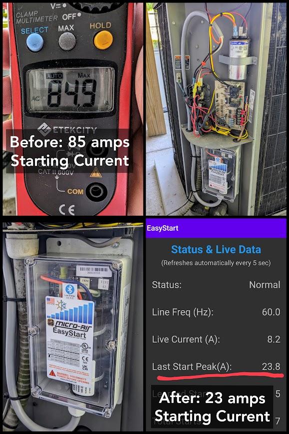

Just finished installing a Mico-Air EasyStart on my 3.5-ton heat pump. It reduced the lock rotor current (in-rush current) by 75% from 85 amps down to 21 amps! This now allows the Lightning's ProPower to successfully start and run the heat pump without even a flinch. Prior to this, the 85 amp in-rush current on the heat pump would immediately trip the overload circuit breaker on the ProPower. Therefore I could not use the ProPower to run the central heat/AC. Now it runs it runs it no problem.

There are a number of products (SoftStart, ActiveStart, etc.) around to suppress the surge current of motors, etc. useful with generators, and obviously, the Lightning ProPowerOn-board.
The only "con" is the cost in the Pros and Cons from a product website, but the up-front cost pays off in the long run by extending the life of the equipment - and of course you need it for using the Lightning as a home backup in circumstances where the surge currents would trip the breaker (a 30A breaker?).
