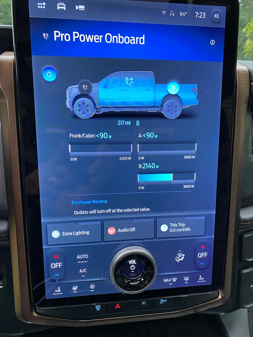

Actually, when you look at the screen for the PPOB 240V output while powering the house, you will see that output is made from two 120V inverters synchronized to provide the desired output.
The screen will show you how much power is being used by each leg.
I was a bit surprised to see that I was using just about 1/3 of the 7200 watts with all 10 of my transferred circuits on, I hadn't calculated the loads on each circuit before hand.

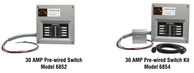

BTW, the Genera 6854 DOES deal with the neutral/grounding issue properly... correct?

I have the 9854 and it does deal with the bonding issues if everything is installed properly. It can take a bit of work, my gas furnace was tripping the GFCI because the neutral wire was shorted to the frame (poor installation technique) which is something that I am glad that I got fixed. Some lighting controls marketed as ‘no neutral required!’ do this intentionally which is a PITA when you are trying to isolate neutrals.

Yes.
I believe the only difference between the 6853 (I have) and the 6854 is just the type of inlet box that it comes with. They use the same manual *attached.
The OEM switch includes 8 circuits:
Included Breakers: 1-30 Amp 2-pole, 1-20 Amp 1-pole, 5-15 Amp 1-pole
They are Siemens breakers - I switched out the 30A-2 pole and one of the 15A for Siemens Q1515
15/15 Amp Two 1 Pole Tandem Twin Duplex #246. Moved the breakers around so the 15A's were at the top and the 20A's at the bottom.
Also I used short 24 inch the whip that came with it, but my circuit neutrals were high in my service panel so I bought extra white wire for them. The whip conduit was a tight squeeze for 10 circuits, so I separated the neutrals and ran them in a separate conduit from the other side of the switch. You'll also need a 50A breaker for your service panel to power the switch when in utility mode.
The guy who sold me his 6853 did not include the inlet box or the cord, but they are easily obtainable on Amazon.
