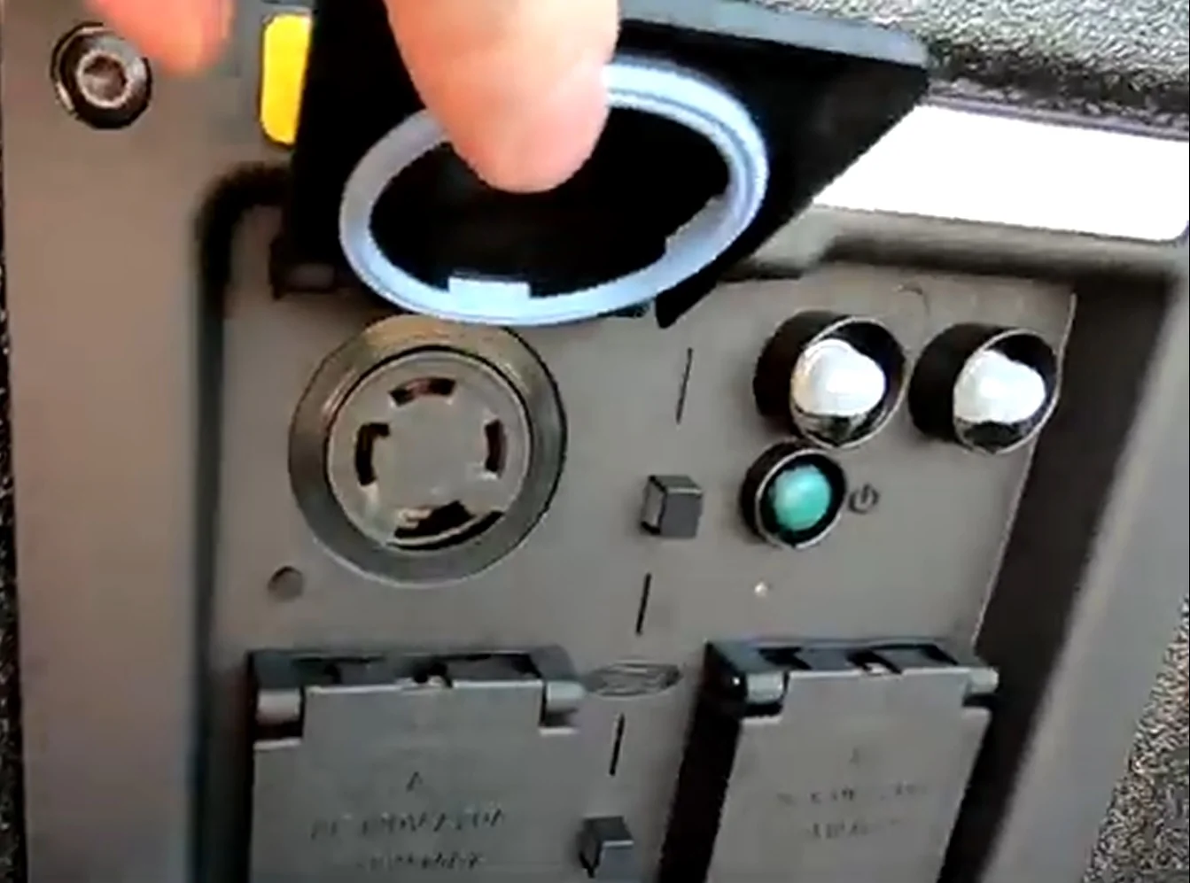

Assuming it was wired correctly, yes no changes required.
One thing we have noticed (by we I mean folks who have used the GENERAC transfer switches with the Lightning) is that if there is utility power being supplied to the GENERAC via the panel 50A breaker when making the switch to or from the Lightning, the Lightning will detect a ground fault and cut off the output at the 240V outlet - seems to be a short spike on connection to the Lightning under that scenario.
You can see it at the end of this video:
It does not mean there is a wiring error, although a wiring error could cause a real ground fault, so it can be a bit disconcerting - caused me to double check all my wiring for any errors, like picking the wrong neutral to transfer.
All wired correctly as my PB has run the house successfully multiple times- my question simply is the LIGHTNING 30A 240V connection same as my PB 30A 240V connection? Most info talks about a special LIGHTNING interface, which someone estimated would run about $7-13,000, which I do not want to set up a 3rd configuration.
Oh, ok...
Yes, should be if it is a standard plug like this:
Ford F-150 Lightning Lightning powering house - 240V outlet ProPower On-Board

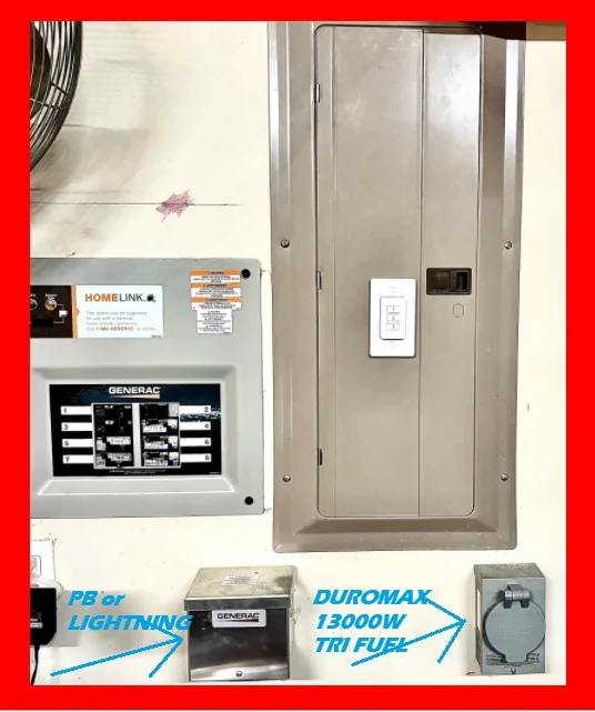

In lieu of a switch (which I was unaware of) heres my setup - I've got about $3700 invested in:
1- GENERAC switch = $550
2- Switch install = $1500
3- Separate receptacle to power entire panel = $1000
4- 2 ICM softstarts on 2 & 4 ton AC units = $650 ($500 + $75 x 2 for install)
Ford F-150 Lightning Lightning powering house - PB SETUP

OK - now that I know Lightning and PB can use same setup (GENERAC 6854 transfer switch)
HOW LONG will the LIGHTNING inverter last running the select circuits?
I know it will be a range, but what is the range?
I believe my load averages only about 2600-3000 watts,
if someone can analyze and calculate approximate inverter effective time.
I believe you can just divide the battery pack size, say 131kWh by the hourly load, say 3000W or 3kWh to get your answer (43hrs) or 50hrs for 2600w.
