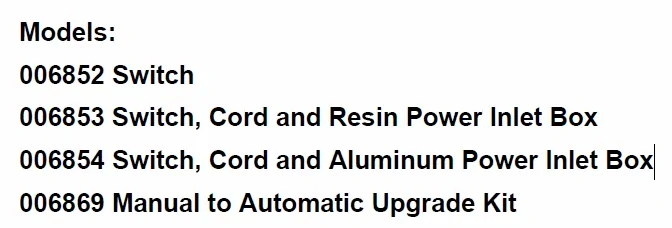

I believe the only difference between the 6853 (I have) and the 6854 is just the type of inlet box that it comes with. They use the same manual *attached.

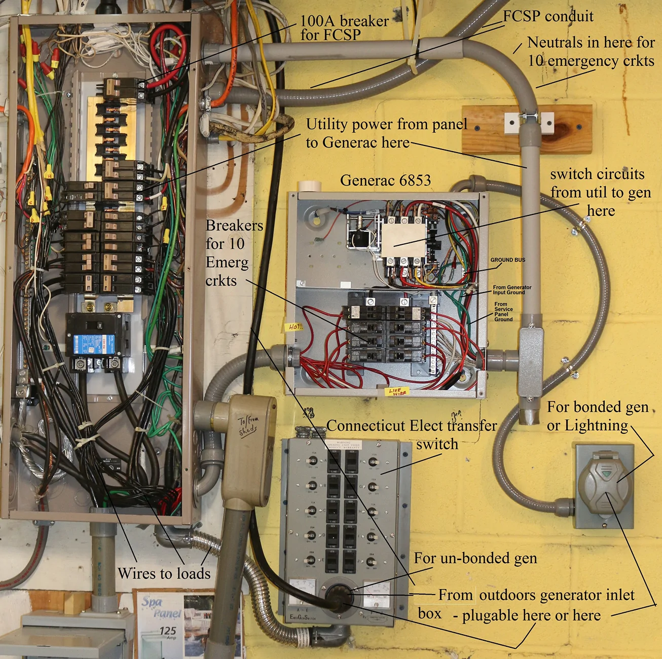

PS: my wiring - I left my old transfer switch for a non-bonded gasoline generator because I am lazy (and thought it would be less work, lol) and wired the GENERAC above it so the utility and the Lightning would feed into the house circuit through the old switch set in the utility mode.
Ford F-150 Lightning Lightning powering house - IMG_5926-final wiring before gen tests
A simplified block diagram:
Ford F-150 Lightning Lightning powering house - Block diag of 2 xfer sw hook up w inlet boxes
Works fine.
One thing we GENERAC transfer switch users have noticed is if there is utility power on the utility input to the GENERAC (like when switching back to utility or when doing a test) when you switch to or from the Lightning the Lightning breaker will open and report a ground fault - a small transient pulse of electricity goes down the line to the Lightning under those circumstances.
You can see it in this video at the end when he switches back to utility from the Lightning.
It can also happen if you more the wrong neutral wire into the GENERAC - I did that - it was a tangle of neutrals in there and I mixed one up.

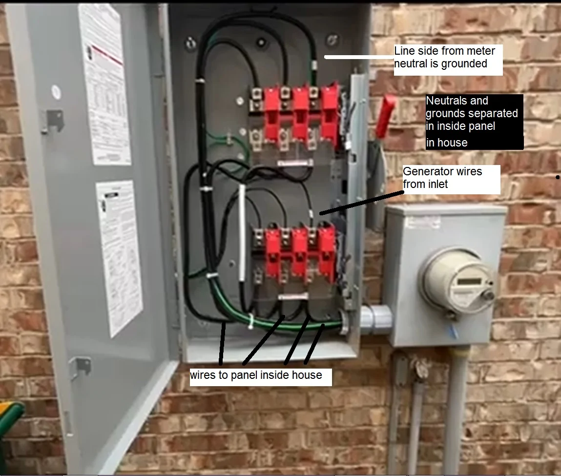

And see this video for another idea for a transfer switch:
A screen capture from the video with my labels added for clarity:
Ford F-150 Lightning Lightning powering house - 3-pole transfer switch-wired

So I guess the bottom line is you can't install the 6853/54 outdoors.
But an enclose attached garage would likely be considered indoors I'd imagine.
