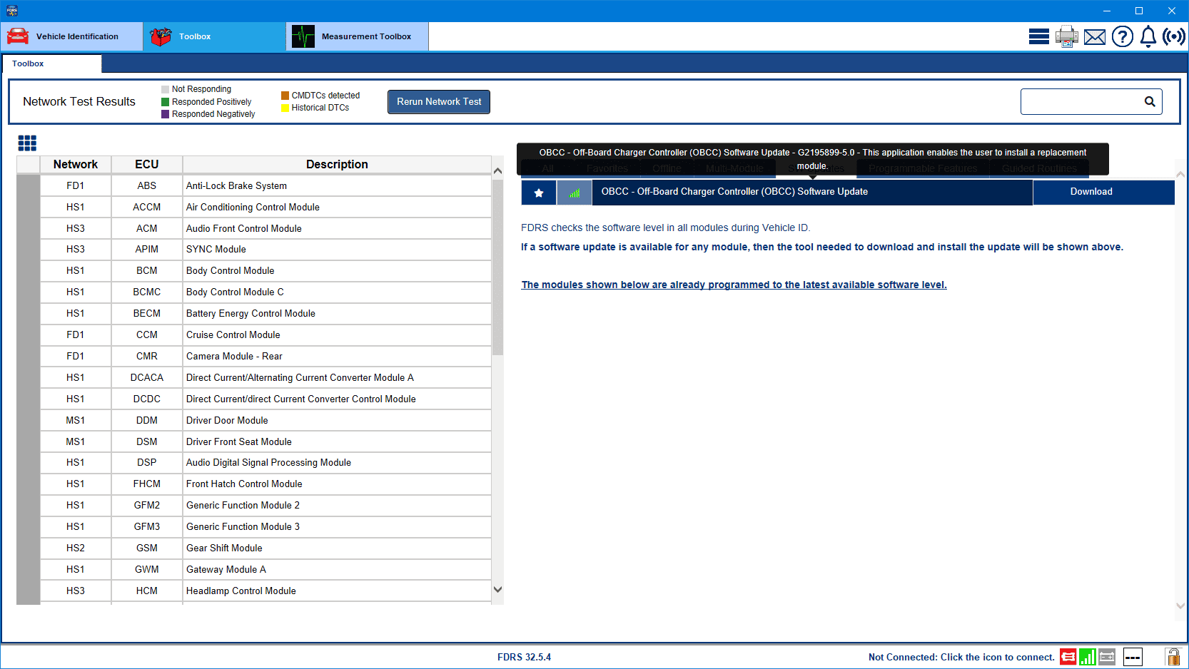

I just checked FDRS to see if there was anything available for the TPMS thing and instead noticed there is an OBCC update instead.
Ford F-150 Lightning Lightning Software Updates using FDRS Lightning_1-July-22_OBCC_Update
I did the screengrab so that the tooltip version would show up.
I'll fire up the Mongoose tomorrow and knock that out as well as FORSCANing the TPMS values to the correct "2A" values in the BCM for my Lariat AS tires.

EDIT: Added version info:
Before updating the OBCC the version was LJ98-14G684-AM
Updated version is now LJ98-14G684-AN

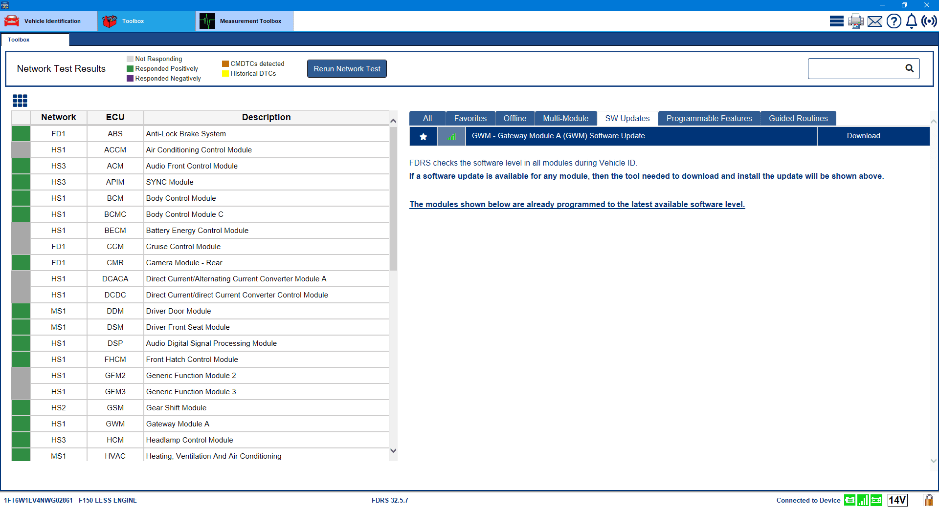

Available as of this morning 23 July 22 is a GWM (gateway) module update that (assuming all Lightnings will get the same version) should bring it up to version ML3T-14H021-HMB (from previous ML3T-14H021-GCG version).
Ford F-150 Lightning Lightning Software Updates using FDRS Lightning_GWM_23-July-22
I started the truck and moved it over to my workspace in prep to do the update and to allow the LVB to charge up a bit cause it's always below the 80% SOC after sitting overnight even on the EVSE. When I connected up the PL6100 after about 5 minutes of idling while got all the extension cords out it was still only at 75%. So I went and made coffee, and got the laptop connected. By that time it was at 85% so I set the PL6100 to powersupply mode at 13.9V and started the update.
GWM is a USB update. Formatted the drive, downloaded the files and plugged it into the USB port with the truck running.

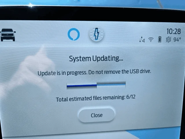

Then a couple of minutes later:
Ford F-150 Lightning Lightning Software Updates using FDRS IMG_3341

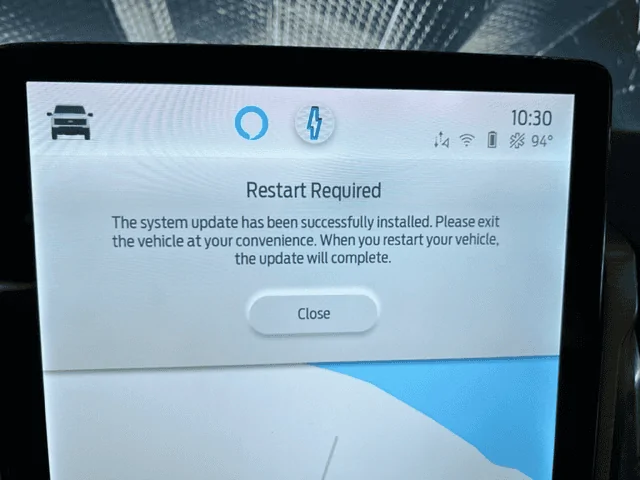

Shutdown the truck, disconnected the Mongoose and left the laptop on the USB update confirmation screen (just leave it until you come back to confirm later), and left the USB drive in the port. Took the key with me, shutdown the PL6100 and went for more coffee with the key fob out of range of the truck, and waited for it to go to 'sleep'.

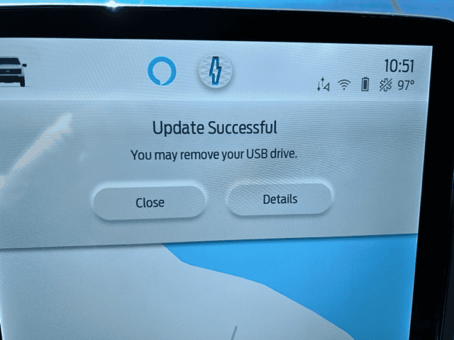

Came back after a while and started the truck. After a minute:
Ford F-150 Lightning Lightning Software Updates using FDRS IMG_3342
Went back and confirmed on FDRS that the update was successful, and that prompted check and "PASS" for all the software packages, and then a module configuration, and then final steps to report success to the mothership.
