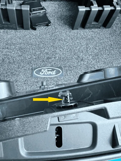

If you routinely find yourself removing and reinstalling the jump point cover to the right of the frunk tub you may find that the plastic turnlock fasteners tend to separate into their upper and lower halves after a while. To keep from losing any of them I put a small dab of superglue in the notch where the little plastic tab is that's designed to keep the thing together. Just so I don't have to worry about them getting lost under the frunk space somewhere. You can see where I put the glue (shiny bit).
Ford F-150 Lightning Lightning Software Updates using FDRS Turnlock_superglu
Oh, and make sure you let the glue dry thoroughly before reinstalling otherwise it may bond to the surround trim and be very hard to get off next time.

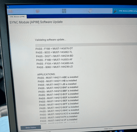

21 Sep and another update...this time it's the APIM.
Normally the F188 DID entry is used to denote a software revision in the update package, which will usually consist of at least one sub-package update, but could be more..or even all of them.
Interestingly today's APIM update had the same F188 revision as the previous version (ending in -DT) but by the look of it, and the size of the package download(s) nearly everything else got changed.
The download itself took quite a long time and came out to 3GB. Previously I've seen APIM updates that were 'only' 892MB big, so this was huge by comparison.

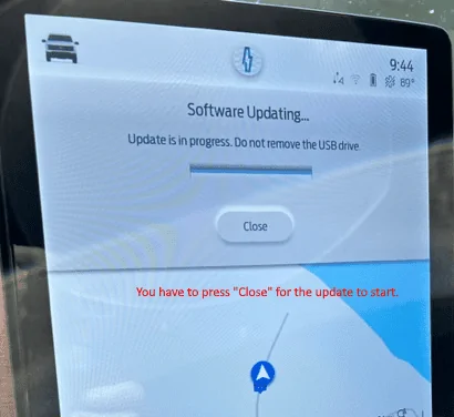

So finally after loading all the files onto the USB drive and inserting into the console USB port....and with the "Engine On"....after a minute...
Ford F-150 Lightning Lightning Software Updates using FDRS IMG_3429
After the download completes....
Ford F-150 Lightning Lightning Software Updates using FDRS IMG_3432
Tick..tock..tick..tock...

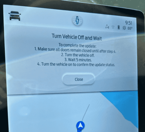

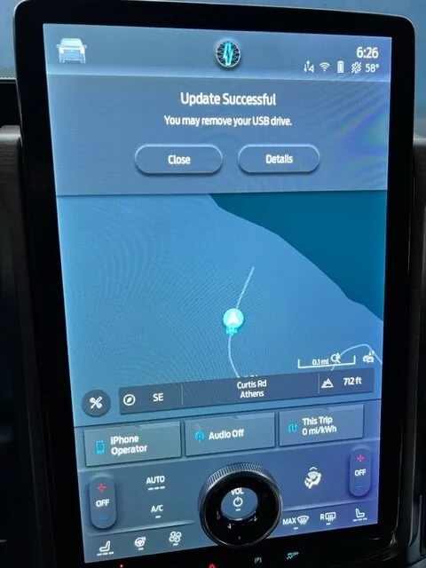

Turn the truck back on....and the message says we can remove the USB drive and confirm the update in FDRS...
Ford F-150 Lightning Lightning Software Updates using FDRS IMG_3435
As you can see the list of updated packages scrolled off the screen faster than I could scroll down to capture all of them. I have no idea at this point what got updated.

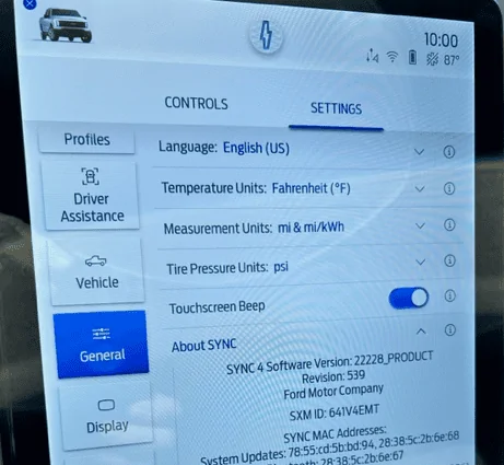

But I'm now at Sync 539.
Ford F-150 Lightning Lightning Software Updates using FDRS IMG_3433
I think I've seen discussion about others getting this update via OTA, but again, I have no idea right now as to what was updated.

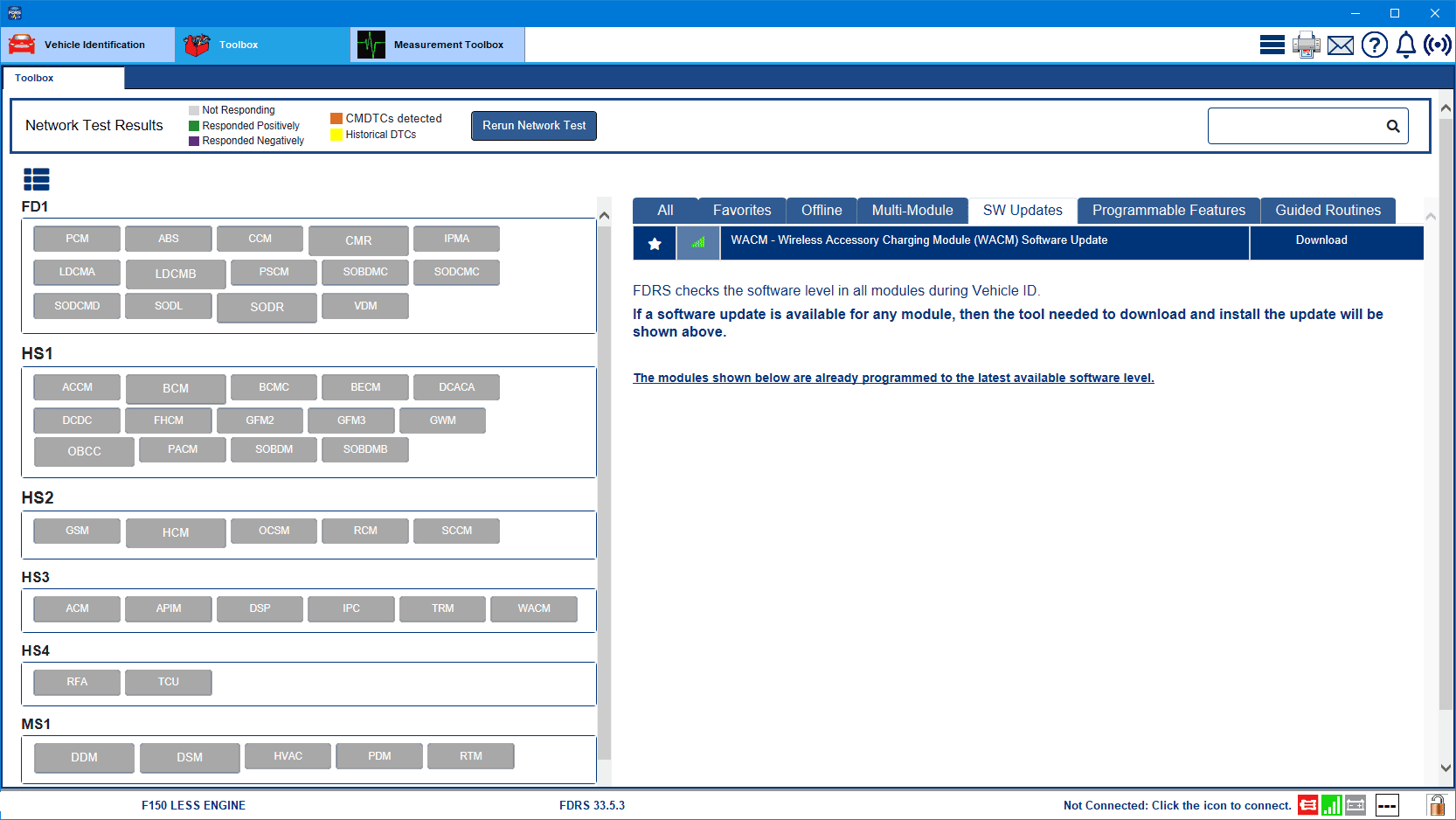

24 Sep and another available update this morning...this time it's the Wireless Accessory Charging Module (WACM) that charges your phone. This one can only be done using FDRS and will not get updated with an OTA.
I won't get into the details on this one cause it's a pretty simple CAN bus routine and takes maybe 5 minutes. Just want to post to let folks know there's an update available for those having issues with their iPhone not charging properly or getting too warm on the charge pad.
Ford F-150 Lightning Lightning Software Updates using FDRS Lightning_WACM-24-Sep-22
Edit: From the time I connected the Mongoose to disconnect, job complete, was 4 minutes. Revision was originally "-BA" version and is now "-BB".
Sad how we have modules like this for a charging pad that is worthless, but 99.99% of the trucks will never get them because so few have FDRS and you know the dealers won't likely do it even if asked because Ford won't pay them to do so.
I'm just hoping Ford can finally find a way to break the back log of OTA updates of the 3.X series which seems to already have gone off the beaten patch and just sitting now for almost 2 months.

When the WACM needed updated in the Mach-E, there was a TSB instructing dealers to do the update under warranty for customers having phone charging issues. It’s likely to happen this way for the Lightning IMO.
