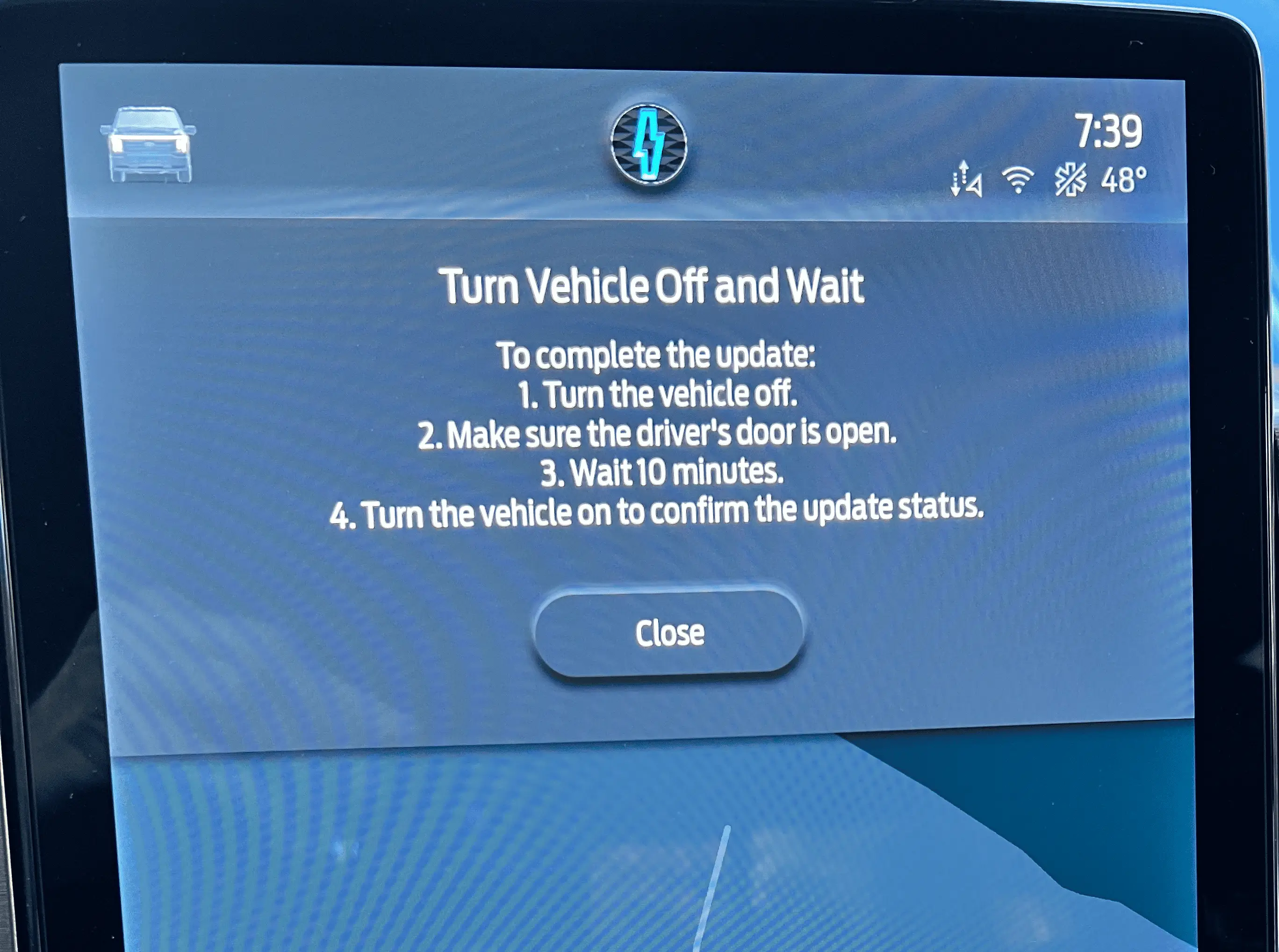

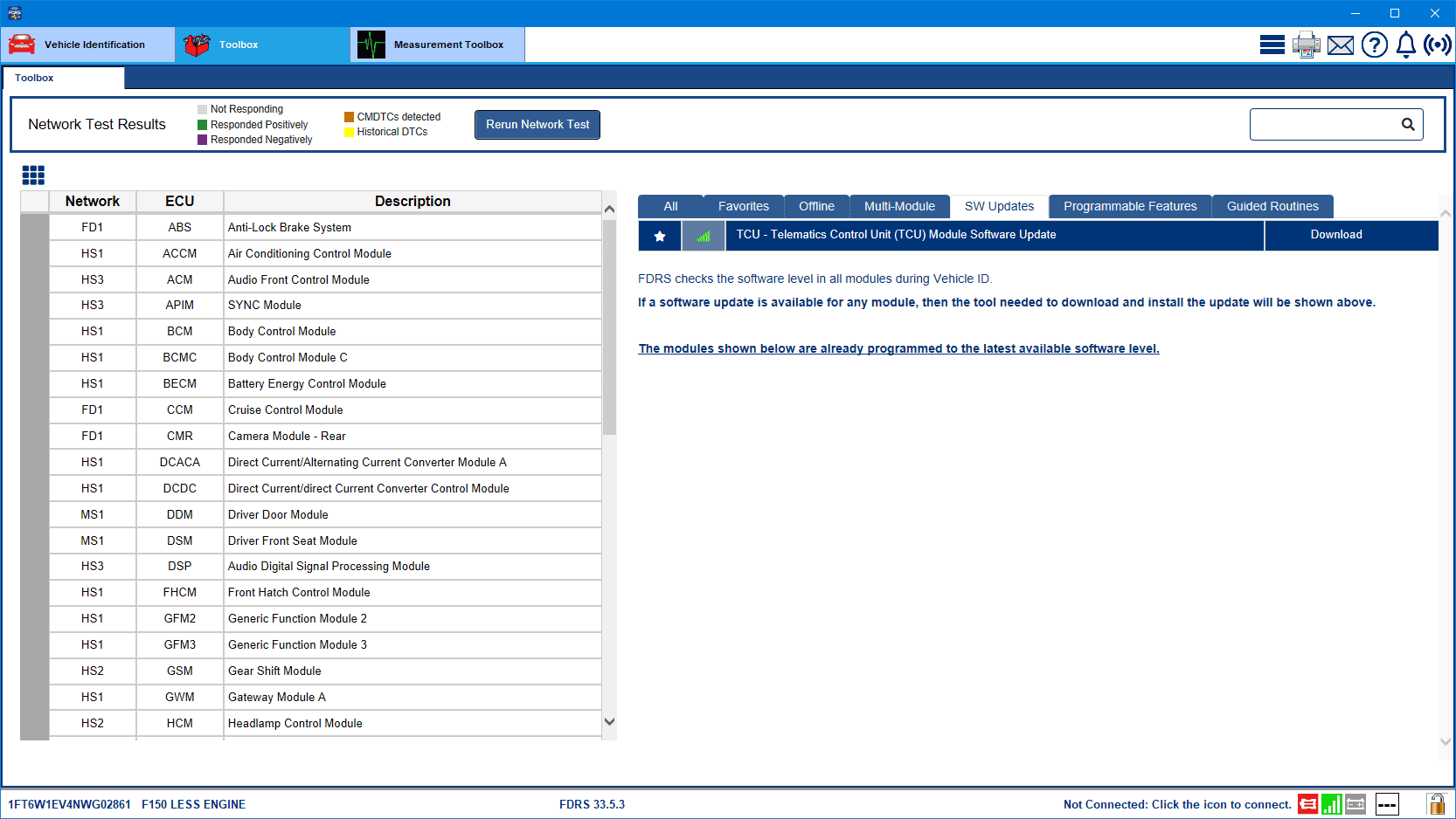

30 Sep and another update. I checked FDRS a couple of times earlier in the day as I usually run VIN checks for other folks. I decided to check one more time on the Lightning's VIN this evening and low and behold...a TCU update.
Ford F-150 Lightning Lightning Software Updates using FDRS Lightning_TCU_30-Sep-22
I guess I know what I'm doing tomorrow morning after making coffee. I wonder if this is the update that allows streaming while you're parked? Like the 3.5.3.3 PowerUp that the Mach-E Early Access groups are getting? I'll post back with whatever I find.
Edit: All done and took about an hour due to the 'shutdown and wait' after the USB update takes place.
Ford F-150 Lightning Lightning Software Updates using FDRS TCU_Instructions
So I checked the 'Entertainment' section in Sync thinking I was going to see some option for streaming and it didn't look like anything changed at all. I am already at Sync 539 due to the recent APIM update, so I don't know what else may be needed to enable that like the Early Access Mach-E folks have now with their latest PowerUp. BTW folks that have Mach-Es and do their own FDRS are running the same versions of Sync as the latest Lightning builds. We're talking both '21 and '22 MY Mach-Es, so they are finally merging the different software branches so that we'll all be running the same versions at last.

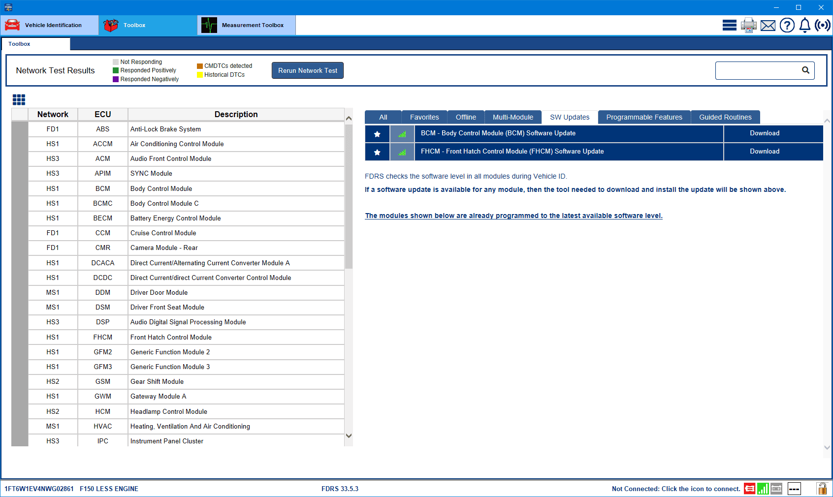

8 Oct and two more updates:
Ford F-150 Lightning Lightning Software Updates using FDRS BCM-FHCM-8-Oct-22
I'm on a road trip but will see if I can knock these out tomorrow.
EDIT/Update: All done, took something like 9 minutes start to finish.
BCM is now revision NU5T-14C184-AAL, and the Front Hatch Control Module (FHCM) is at revision NU5T-14H121-AH.

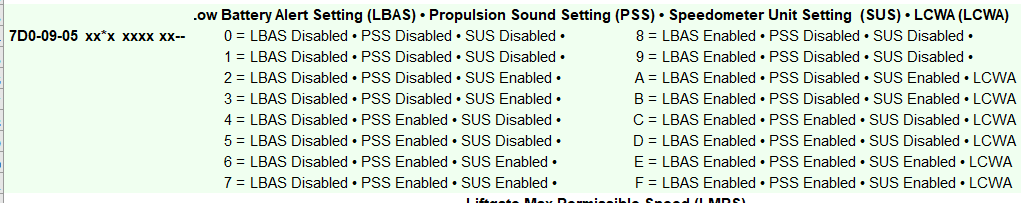

@Mike G Is FDRS the same as FORScan?
I ask because I just noticed a setting in FORScan for propulsion sounds and I'm wondering if anyone has gotten it work on non Platinum Lightnings:
Ford F-150 Lightning Lightning Software Updates using FDRS 1665734566274
Mike G
Mike G
Jan 6, 2022
1,917
2,834
N. AL, USA
Nope it's a different program completely. FDRS is a Ford official product. FORSCAN is a product that seems to be based on reverse-engineering modules and code. I've used FORSCAN for years to do tweaks that allow 'features' that Ford hasn't enabled.
I haven't looked into the propulsion sound settings, as I tend to like my electric vehicles to be completely silent.

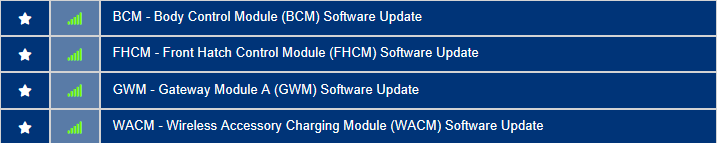

Can someone check whats my updates stack looking like? I'm like the only one without PAAK until today update. I have a a Sept build date, when everyone else seemed to have had PAAK since the July builds. 1FT6W1EV5NWG14422. I feel like I have alot of outdated modules based on the PAAK rollout. I know my sync version is pretty old. 22215 rev 528.
Mike G
Mike G
Jan 6, 2022
1,917
2,834
N. AL, USA
5 Sep build according to FDRS.
Here's what it looks like this morning:
Ford F-150 Lightning Lightning Software Updates using FDRS 1FT6W1EV5NWG14422-2-Nov-22
Quite often if there is a GWM or TCU update showing those need to be updated for other modules or features to be enabled. This would likely happen via OTA. So I think that's what you're waiting for.
I think it's been mentioned before but the WACM (wireless charging pad) can only be updated by connecting to the truck with FDRS. So if you're experiencing iphone charging issues you'll have to have a tech update that in person.
