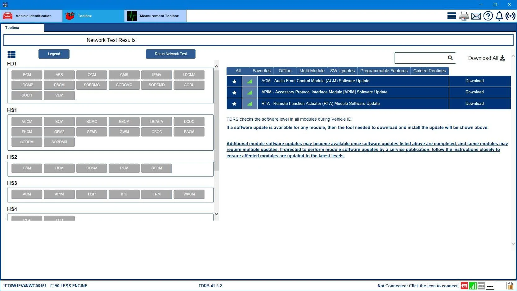

I didn't check FDRS yesterday after doing the whole battery disconnect, and then the fascination with watching my APIM get updated to Sync 1270 (very relieved that worked) ......so the ACM and RFA that showed up this morning in my FDRS might have actually been there yesterday and I didn't know it.
Ford F-150 Lightning Lightning Software Updates using FDRS Lightning-ACM-RFA_14-Sep-24
You can see that APIM is still there, cause I haven't gone out and connected up yet to do a network scan..but I'm sure it will drop off the list when that happens.
It's non-stop rain right now, so I'll have to wait for a break before I start anything.
I have seen the ACM and RFA updates on a couple of '23 models...but not all Lightnings have RFA modules (depending on trim level).
I have not seen the ACM or RFA show up on the one '24 model I checked.

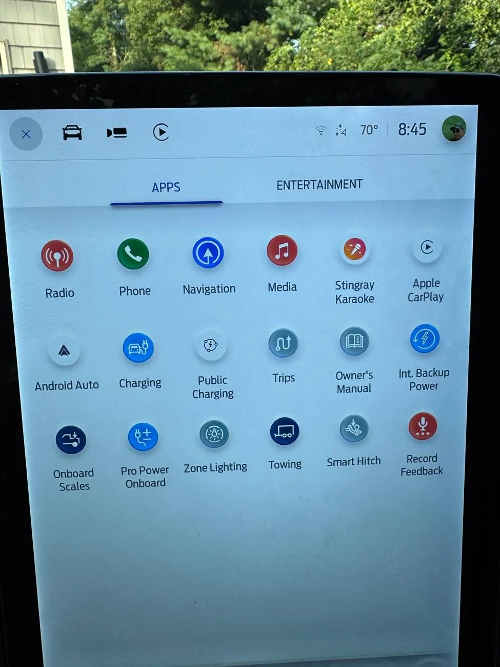

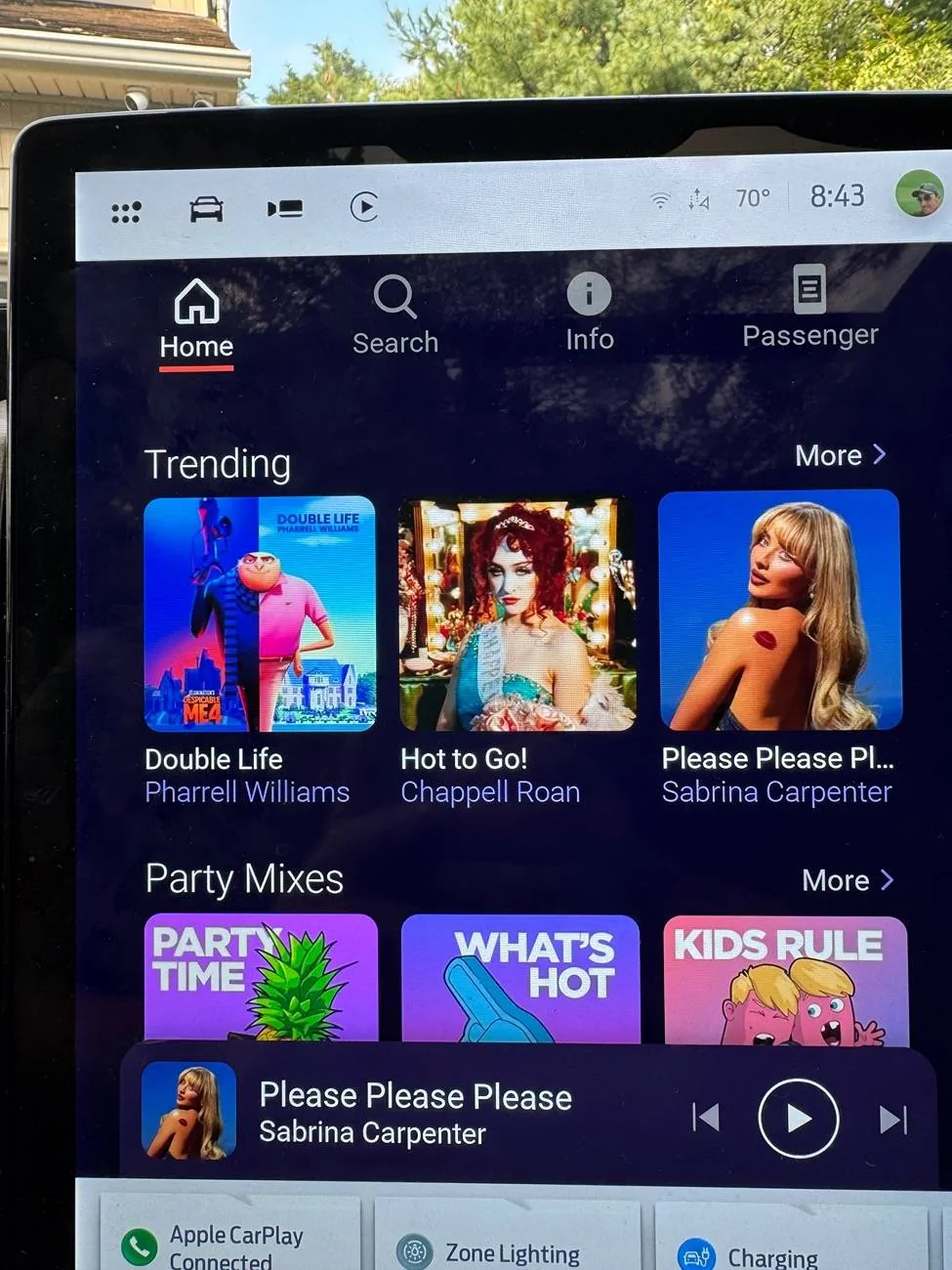

These were new for me this morning as I checked last night . Going to run the updates now while I sing some karaoke ( which I will absolutely not do and why is it now the fifth icon? . Wtf)

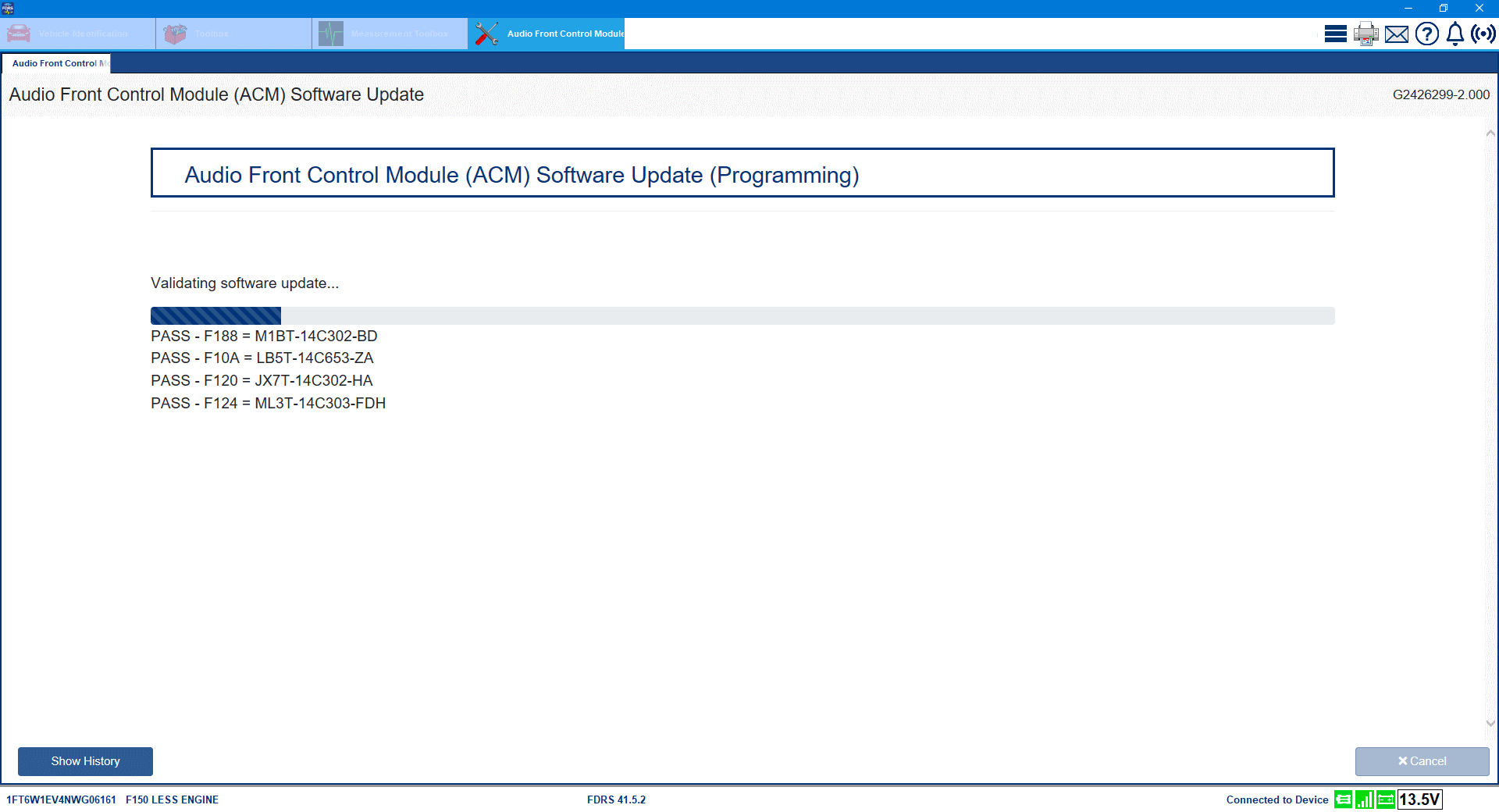

Updates for ACM and RFA completed (5 minutes for both ). . Though they refuse to clear on FDRS .
So...glad you mentioned it. I'm not the only one then! :p
The ACM took maybe one second? WTH?
But afterward on the file check they all passed.
Ford F-150 Lightning Lightning Software Updates using FDRS Lightning_ACM_Pass
After the ACM, the first time I tried the RFA it took maybe a minute....and I knew that wasn't right either.
So I spammed the network scan button a few times and ran selftests and then re-ran both the ACM (nothing changed) and finally the RFA. This time the RFA did actually start block erasing and programming, and it took like 20 minutes to do, and afterward I confirmed the installed files against the application manifest. So I'm confident that one updated as well.
Ford F-150 Lightning Lightning Software Updates using FDRS Lightning_ACM_RFA_14-Sep-24Already-done
But yeah, both of those are still in the list and don't seem to want to clear.....maybe it's a 'Sunday' server thing?
